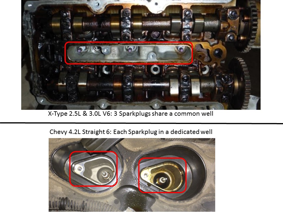

Dennis: It's unlikely 4 coils went bad at the same time. Check for oil in the spark plug wells before replacing the coils. The firewall bank and radiator bank each have a common well for all 3 spark plugs. When engine oil leaks into the common well (not uncommon after 100+K miles), 2 or all 3 spark plugs can misfire. If this occurs on both banks, it could cause 4+ spark plugs to misfire.
If you are using fancy 'split fire' spark plugs, replace them with traditional plugs such as Autolite Double Platinum APP605's. People report problems when they try fancy plugs in our X-Types.
The engine won't go above 3000 RPM because it's in limp mode to protect the engine until the misfiring spark plugs are fixed.

What is the "common well"?

iownme: Some engines have separate, dedicated wells for each sparkplug. For these engines, when oil leaks into a well, it affect the single sparkplug in that well. causing it to misfire.
Our 2.5L & 3.0L engines have 2 "common" wells, one housing the 3 firewall-side sparkplugs, and the other well housing the 3 radiator-side sparkplugs. When oil leaks into one of these common wells, it can cause 1, 2 or all 3 sparkplugs in that well to misfire, depending on how much oil has leaked into the common well.
When Dennis describes 4 of 6 spark plugs misfiring, the cause might be significant oil in both sparkplugs wells, each housing 3 sparkplugs.
Does this make sense?

Its been a while since i changed my plugs, but i remember each plug having its own "well".... Oh well... Lol

iownme: Here's a picture of the common sparkplug well of an X-Type head (2.5L & 3.0L). When oil leaks into the well, it can cause 1, 2, or all 3 sparkplugs to misfire, if enough oil leaks in.
For comparison, the Chevy 4.2L straight 6 head has dedicated wells for each sparkplug. Oil leaked into one well causing that sparkplug to misfire, but the other sparkplugs are in separate wells and were not affected.

Thanks for that... Still doesnt look familier... Guess that means its time for new plugs.. Lol
The last attempt to change plugs found that the last bolt on the upper intake was just turning in its little brass captive nut, so removing the intake was not possible.
