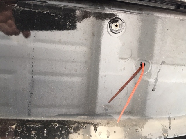

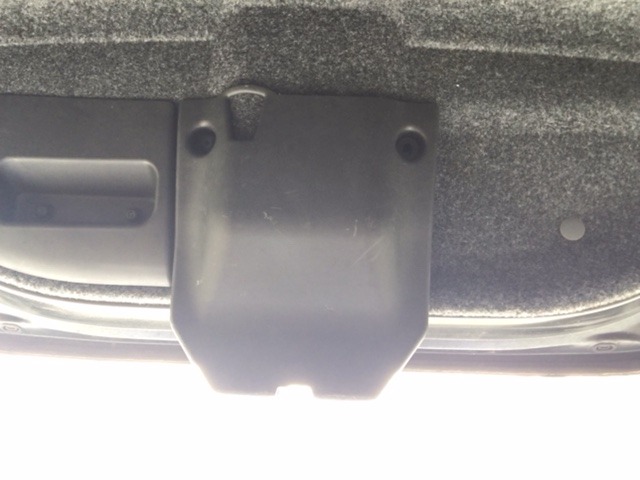

All X Type owners. Do this quick fix.
You need to take off the yellow quick release handle the all US cars have. I know they are to save your kids if they get locked in, but if that happens blame Darwin! (kidding)
Remove the plastic cover. It's a few screws. Thread a plastic tie from the point the handle was at, through one of the holes behind your tag. When you remove the cover it's easy to figure out. Make sure it can't be seen. So now when you lock anything in your trunk you just remove or bend up your tag and pull the tie. And your boot/trunk will open. Do it now, because there are those who have, and those who will lock their keys in the trunk, or have the electronic button fail.
The plastic cover

What the tie should look like
