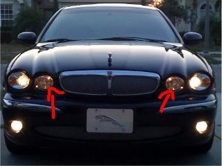

I want to replace those bulbs in the picture below because I have 4300k philips HID kits in my main headlights but I don't know what the name of those bulbs are so I can get 4300k bulbs to match, its an ugly yellow color aside HID's!!

Parking lamp bulbs. Inside the high beam......pretty easy.

According to Sylvania's lamp replacement guide for the 2005 X-type it lists:
2005 JAGUAR X-Type (With halogen capsule headlamps)
Low beam headlamp
H1
H1ST Silverstar High Performance Lighting: The Whiter and Brighter Halogen
H1XV XtraVision Halogen - The Brighter Light
High beam headlamp
H1
Parking light
2825
2825LL Long Life Upgrade: Up to twice the life of the standard lamp
Which is which? lol
Old Jul 28, 2009 | 12:29 AM
ajl1212's Avatar
Posts: 56
From: Southern California
I think the lights you are talking about are bulb type 2825. They are used for the front parking lights as well as the side markers located on the front and rear bumpers.

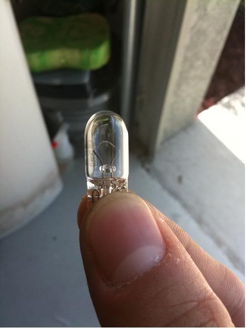

Okay so I figured out how to take the housing off and which bulb is the one I needed to replace. It seems like the High Beam Bulb is a H1 bulb, it said it on the actual bulb itself. As for the other bulb I was speaking of I figure it is the 2825 bulb ajl1212 was speaking of.
Here is a picture of the bulb that I want to replace, I couldn't find any model number on the actual bulb.
Thanks for all the help I just want to be sure I am getting the right parts.

Jag, yes, that is what we call a running light. Inside of the JTIS, they call it a "side light". Granted, not much of a "side" light when it is on the front of the vehicle. It is a 2825 bulb, which is the same as a 194 bulb. Hopefully this will clear up any confusion that you may have.
