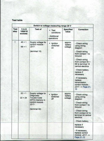

I have the VW 09A gearbox info. It is the JF506E but it is labeled different from the Jaguar and might help with diagnosis.
bob gauff
Attached Thumbnails how does shift solenoid b work-09a01.jpg   how does shift solenoid b work-09a02.jpg   how does shift solenoid b work-09a03.jpg   how does shift solenoid b work-09a04.jpg   how does shift solenoid b work-09a05.jpg
how does shift solenoid b work-09a06.jpg   how does shift solenoid b work-09a07.jpg   how does shift solenoid b work-09a08.jpg   how does shift solenoid b work-09a09.jpg   how does shift solenoid b work-09a10.jpg
how does shift solenoid b work-09a11.jpg   how does shift solenoid b work-09a12.jpg   how does shift solenoid b work-09a13.jpg   how does shift solenoid b work-09a14.jpg   how does shift solenoid b work-09a15.jpg

Thanks for taking the time to supply this stuff, I will without doubt keep this stuff on file. Today I will find out if I have sorted the problem out, I have tested each and every sol with a tool I knocked up , this allows me to use varous voltages and air test at the same time I find that a duty sol is defective. Will replace today and fingers cross. This was the last one I checked as this was the newest of all the sols, apart from shift (a) a couple of days ago , turns out this did not need replacing, so now have a spare. thanks once again.
