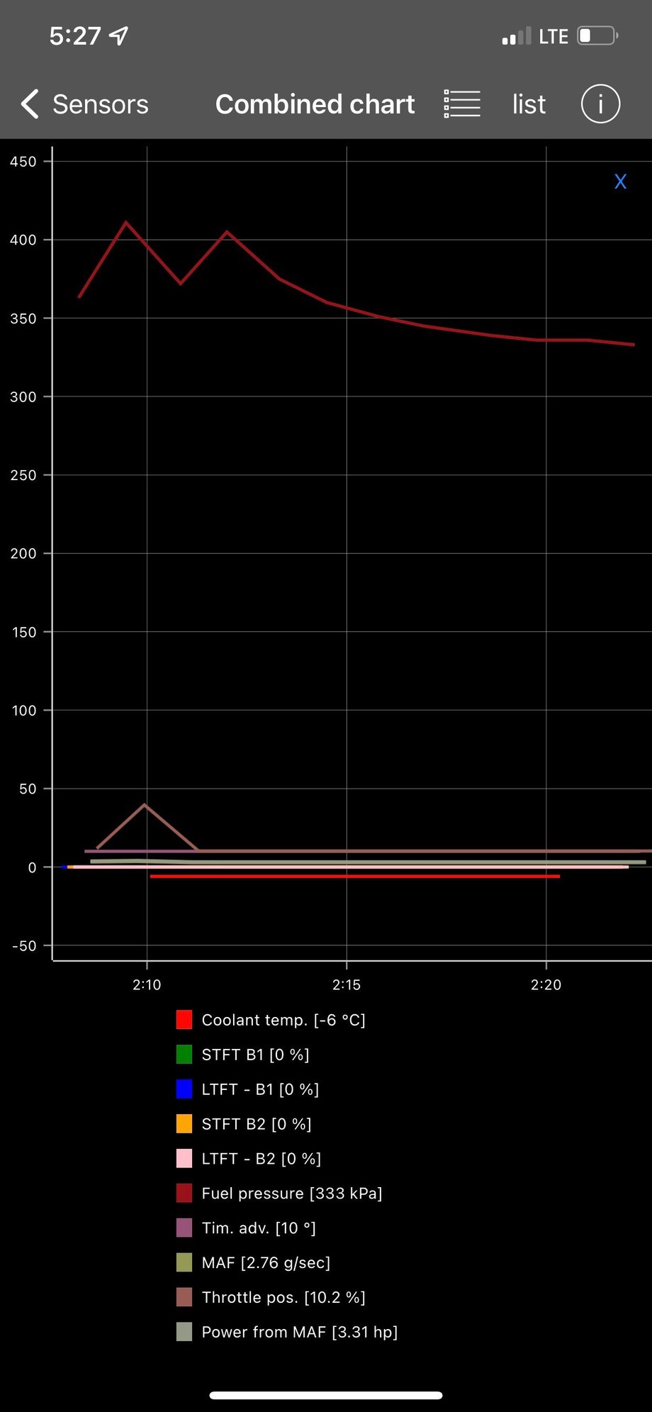

I laid my 2004 x-type up to do some work prior to a mandatory safety inspection. I was bring the maintenance up to date and discovered the oil pan gasket had failed. This repair went well and I had a set of Bosch double platinum plugs that needed to be installed and did that at the same time. I also had a flat spot on the flywheel which I addressed by removing the starter and adding some teeth with my welder and Dremel. The car won’t start on gas or ether. I thought I had bad plugs but it seems the fire is irregular. I’ll add some video and let me know what you think.
I believe this is good fuel pressure

Also of note...the coolant temp reading on your first image posted....-6 degrees C ...is that in any way true or a likely a false reading? ECU adjusts fueling according to engine temp, so something way out there could enrich engine and foul plugs.

Thanks for the replies, I grounded the welder to the flywheel. The ECU would have been reset because the battery was disconnected for quite some time. We’re you able to view the video? Am I correct that it is not firing correctly? Starter and the new teeth are working great. I tried different spark plugs and a coil tester. Yes -6 is correct for the coolant. If your theory is correct maybe I messed up the CPS sensor. Correct me if I’m wrong but doesn’t it send the timing info to generate the spark signal? I’ll try to share the clip of the spark tester.

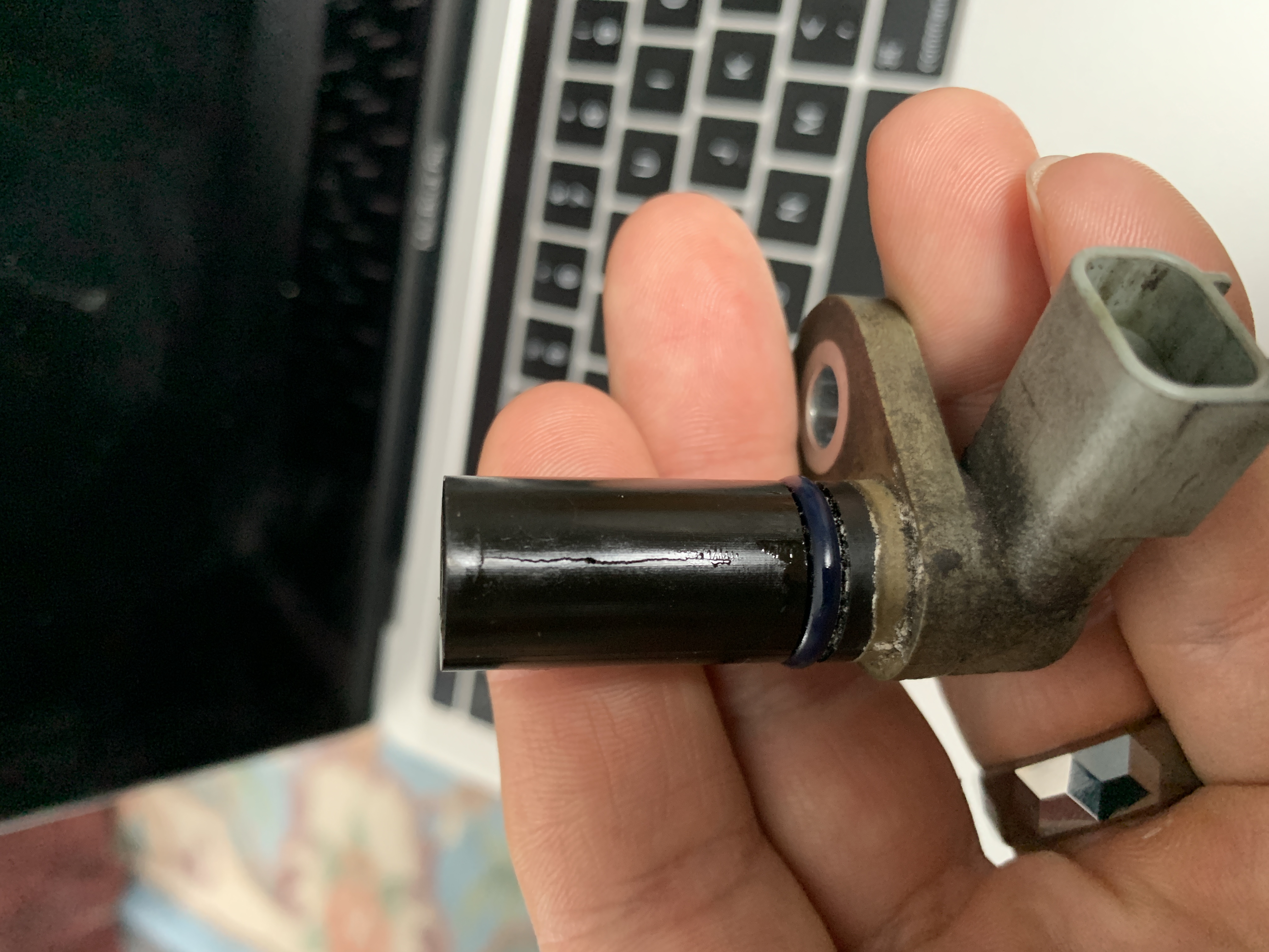

Default Pulled the Crank Sensor
Hi All, my Wife is loosing faith in me working on her car. It was running fine prior to me working on it and always started, even with the fly wheel issue. It's been down for 7 weeks now. The only code it had was for an oxygen sensor which I changed while everything was apart. The injector pulse is perfect but the spark is off. The rpm's are 132 while cranking so it the ECM is receiving a signal. The ohms of the sensor off the car are 345 and I don't have a multimeter that will measure such small AC voltage to test although it is registering DC voltage, enlighten me if anyone knows what that means because I can't find any info. The CPS sensor however is cracked so I am ordering a new one. Pic attached. Would the Cam sensors manage the fuel timing and the crank sensor manage the spark by any chance?

Have a look at Tech Bulletin XT303-04. You can find it at JagRepair. CPS (Jag calls is CKP) diagnosis and repair starts on page 44. Your 345 Ohms indicates the sensor is good but agree you should change it since it is cracked. The tech bulletin says you should measure AC voltage of 1.5 to 4 Volts peak-peak on the CPS, higher voltage indicating higher engine speed. If your meter can't read that low I might try measuring it on a DC setting on the meter. The DC reading is really averaging the signal over some small time so you should see zero when the engine isn't moving and something non-zero when it is moving. That doesn't give you a lot of information but will tell you if the thing is putting out any signal.
