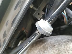

1) brake booster hose that tends to have the check valve (football looking piece in the middle of the line by the brake booster) form a leak and the plastic will start to crumble in your fingers if you rub it.

1. So I inspected the break booster hose and check valve, it looks almost new I can scratch it and it doesn't crumble (see picture) . Is it possible that I has failed internally?

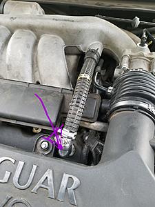

3. The PCV hose is in excellent condition looks pretty new. However as shown on attached picture, there is a hissing sound coming from the top of the valve (where the purple arrow points), I have clamped it down harder and cleaned the connection and no difference... Could this be because of the amount of air flowing inside the valve? Should I worry about it?
I don't have access to a cigar and don't have friends that smoke. Is there another option that I could try?

Hissing indicates a big leak. (Obviously needs fixing.)
Even a tiny one - which you typically cannot hear - would need fixing, too.

tgor, if you can hear hissing from the PCV valve, then the PCV valve is bad and that is more than likely the cause of your P0171 and P0174 codes. Once you clear that, then the P0420 should clear itself too.

Ok I'll take a look at the valve, I can only hear the hissing through a tube running to my ear otherwise the sound can't be heard. The sound is only heard diectly on the top of the pcv valve and not anywhere else. Is it possible that the hissing is internal? Is there a way to test it once I remove the valve?
