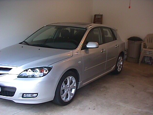

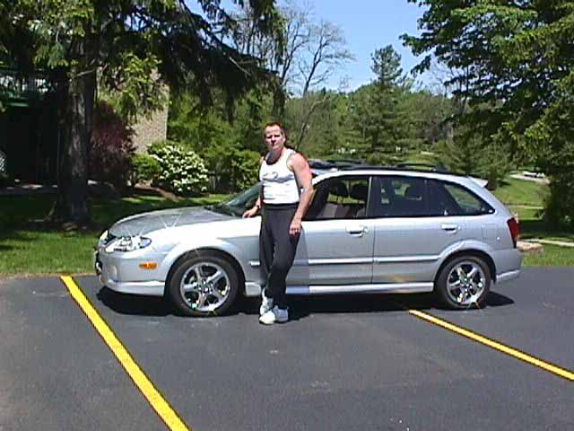

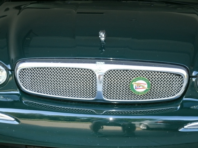

When I took delivery of my '03 2.5 X-Type, I also purchased 20 new lug nuts and always take my Jag to a Certified Master Mechanic. I also shared in numerous posts in this Forum, that my Mechanic told me to purchase the correct socket so if I am on the road and have a flat I will have the proper socket, as AAA might not. When looking at X-Types (on your used car lot) it is always a good idea to check the tires! Many X-Types have different tires; this is a good indicator that the lug nuts have been ruined. I believe that this is not a poor design, but owners who are not informed and do not have the correct tool (or knowledgeable Mechanic) thus, ruined lug nuts. Good luck to you all and this is a great Forum. (My Jag, my current and my former Mazdas.)
