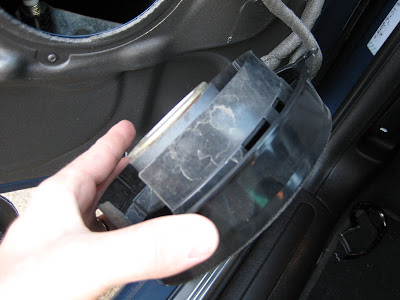

DO NOT pay anyone to do the speaker install for you, if it is the speakers. The door panels on the jag are the easiest I've ever taken off in my life. Many times my problem is putting the panel back on and sticking like it did before I took it off, not the case on the jag they are just as easy off as they are on. Here are pics of what the speakers look like removed and in comparison to the stock speaker (at least what they are on my base sound system.)
Here is a pair of component speaker set (crunch gts6.5c) in comparison to the stock speaker.

How did you mount the aftermarket 6.5s?
I never installed them I was removing the door panel to lube the door handle and figured I'd take pics to show people behind the door panel when they need it. If I were going to do it I'd probably cut rings from mdf.
