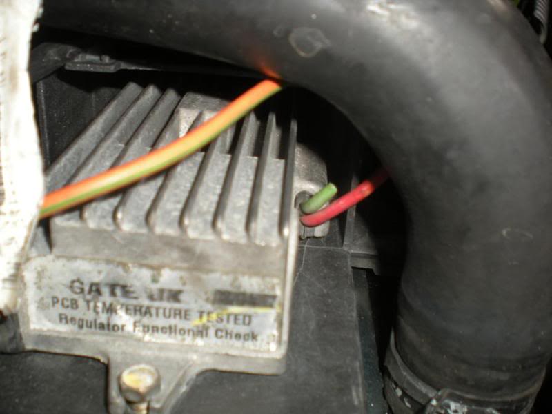

I think I found the issue , Im guessing this is the module you were talking about thermo, and Im guessing that green wire that is there was cut and shouldnt be cut? could that be over riding the system and making the fan go automatic and always on? how can I fix this? or maybe a sensor was messed up and they cut the wire on purpose to bypass the sensor ? Im just assuming and guessing here , any advice? Here is the picture of what I think is the module by the fan assembly with the cut green wire.

MPonce, that green wire that you show being cut goes to the right hand fan. With that cut, you should not be seeing both fans running. IT is possible the temp control module isn't seeing it in the circuit and is going into a protective mode.
The speed control wire is the white/blue wire that runs to that module.
I would try connecting up that green wire and seeing what things do at that point. I would be curious where the other end of that wire went to. If someone has wired it in somewhere else, I would be placing money that the control module is toast. Some more looking will be needed.

the green wire is connected to some metal alarm looking device which has another wire running into the fans somewhere , I think they did a direct connection and bypassed the module , so weird wow.

MPonce, if the one half of the controller died, it would not surprise me if someone wired it up that way to keep the fan operational. Like I mentioned before, the controller (silver box you are seeing) is known for failing and is a tough item to get at a decent price. A lot of member have been forced to buy the whole fan shroud/controller assembly.
