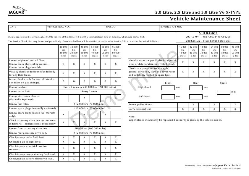

You have bought your car just in time for the 70k service which is the BIG one (ie removing manifolds) to change spark plugs.
There is a pic of the service sheet for the X Type so you can see what gets done at each service in the 'X TYPE FAQ QUICK LINKS'link at the top of the X Type section.Then go down the list and click on 'maintenance-sheet-log-x-type' to see the service sheet used by dealers.

X type service sheet for your info below
I've added a link for an X type owners handbook below the service sheet that you may find useful until you get one for yourself, or you could just print that off I guess.
Message:
Service sheet:-

Castrol Syntec? I read the service manual (thanks A TON) and it only mentions oil capacity (6.1 qrts). I have read more than a few places that these cars run on dino oil and not synthetic. After my innitial post I found another jag forum which expressed this clearly. Is up to the driver? What does Jag recommend???? Also, What a bout the filter? Can I get one @ any big box auto store (advanced auto, autozone, napa, etc)???

OK, thanks to jim 64s link, which I now have printed, three hole punched, trimmed, and put into 8x10 3 ring binder thus having the complete owners manual, I found 5w30 by Castrol is the preffered oil.Now, I assume they mean regular oil. I saw no mention of synthetic on those few pages (around section7-4). I think I am going to use castrrol gtx 5w-30 and whatever filter Napa tells me (for some reason I trust them more than Advanced Auto
