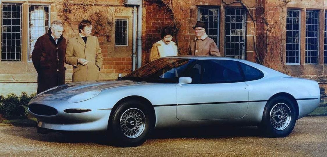

Well I think that Lawson and Helfet knew what a Jaguar is....... or was. There are those infamous photos of Sir William Lyons in the 80’s giving Helfet advise on the 80’s F type prototype (XJ41) They where able to keep proportions, height, and angles just as they should be.
