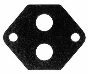

im looking for the IMT valve o-rings cause i think i have problem with vacuum but i cant find it..
are this??
in rockauto they called Air By-Pass Valve Gasket.. can somebody tellme if is this part to buy it.
thanks

More like this. I believe that a 2003 Lincoln LS uses the same gasket.
As a Lincoln part it may be less expensive than a Jaguar part.

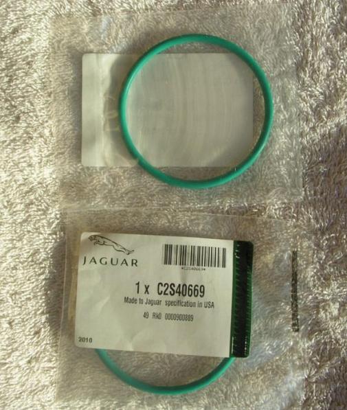

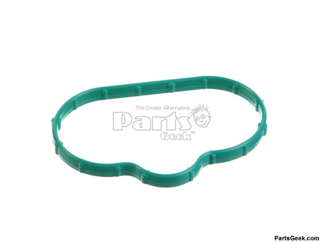

The previous post is showing the lower intake gaskets. I've attached a pic of the IMT valve location. Also, there is a link for installation.
http://www.jagrepair.com/images/TSB/...T%20O-ring.pdf

The gaskets look like these:
They may be Black, Yellow, or Green.
http://www.gaudinjaguarparts.com/par...&siteid=214626

thanks, i already know where is located but never see the rings.. now i know what im looking for..
