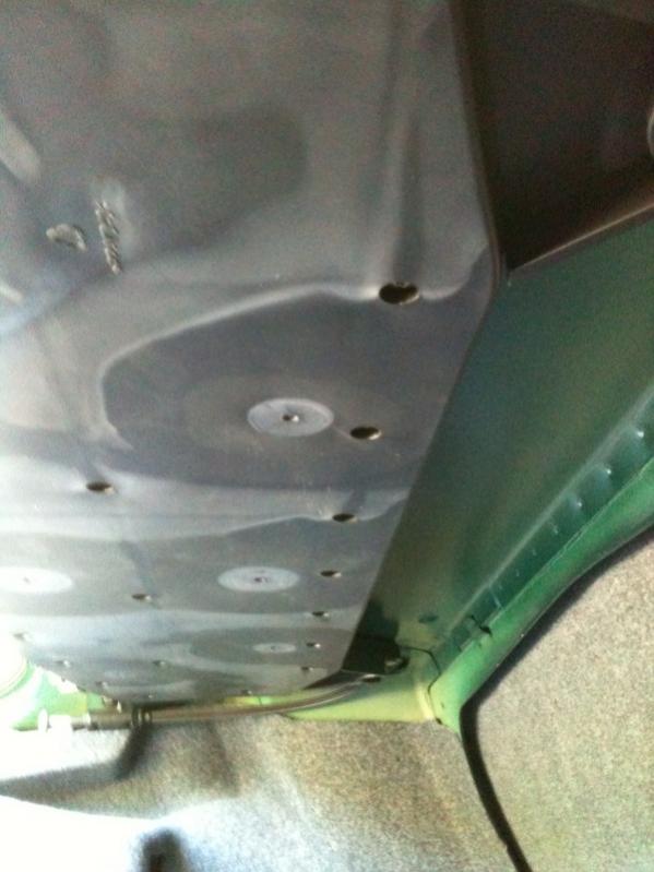

In regards to the backup sensor - when I am in the trunk, there was only one large enclosure spanning most of the rear shelf. (I have a picture but cannot upload). I removed the shelf (5 hex nut bolts) and this revealed only two main speakers in a somewhat sealed evironment. It appears that I can dis-assemble by removing 20 or so screws but I am hestitant until I can confirm that this may house the backup sensor control module and speaker. Are you familiar with this type setup? (This is a 4 door sedan)

Thank you Jim! Attached is a picture of the speaker enclosure.

PJ, sorry about that, got my cars mixed up and was running off of memory. Yes, the box you have a picture of is the subwoofer box that comes stock with the car (upgraded sound system only). The parking aid module is located in the spare tire well. If you lift up the carpeting in the trunk of your car, on the left side of the tire well you will see a computer module. That is your parking aid module. That will have your speaker that you are looking for that makes all your beeps.
