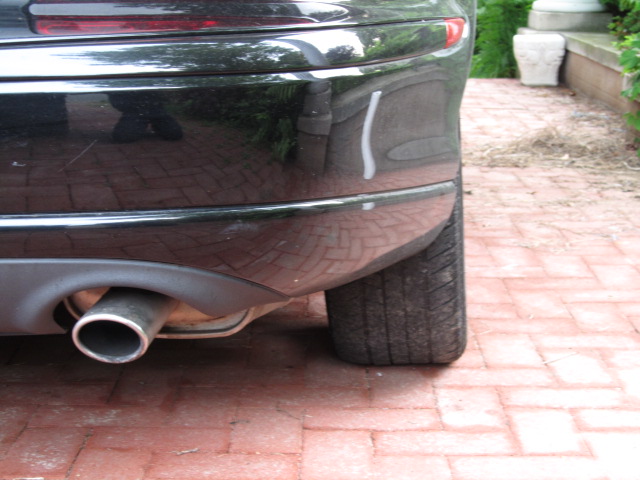

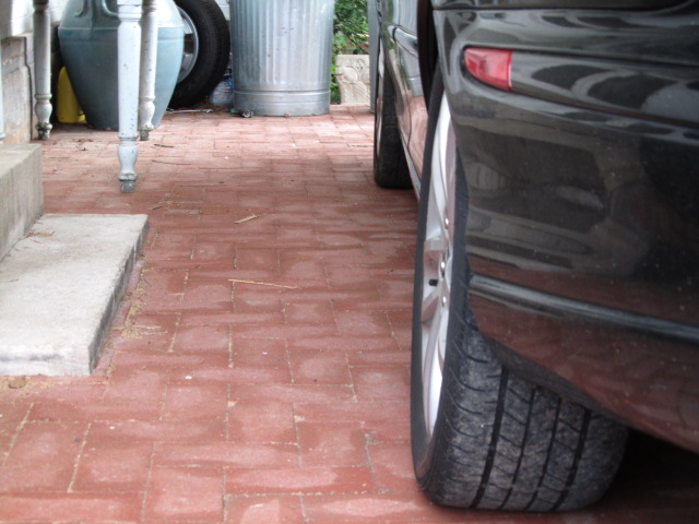

you can see from the pics how the top of the wheels are "in" and the bottoms are "out"
does this look like the bushing issue?. If so, what are the parts called that i need to order?. If not, what else could be causing this?.
I am likely to cause damage to anything by driving like this until i fix it?.
I get my plates in the morning so i'll actually be able to drive it!!!. Can't wait!
Attached Thumbnails rear wheel bushings-img_0158.jpg   rear wheel bushings-img_0159.jpg

You'll wear your tires a little quicker on the inside by riding like that. Mine looked like that and I drove it around like for about half the year until I finally got it fixed last month. Replacing the rear front lower control arms did it for me.
I did notice the car was more eager to turn into corners driving with the negative camber. But that's about it - handling was otherwise terrible on uneven roads.

my personal opinion is to leave threads alone and NOT open new ones. it tends to spread info across to many places and if all in 1 thread a person only has to read that thread. you can just addpics to a thread youve already started. and I understood what you were talking about without pics, but others may not. and yes theyre easy to change on your back and 4 bolts. keep in mind you need a pry bar to tweek the suspension to align the bolt holes as you install the new arms. and then go get it aligned

i'm now home and was able to jack up the car and check for play....WOW, there is a massive amount of play in the outer bushing of the rear lower front control arm, probably not much of a bushing left i imagine, now i can see and understand why the wheels point in at the top like they do. I'll be ordering replacements today.
