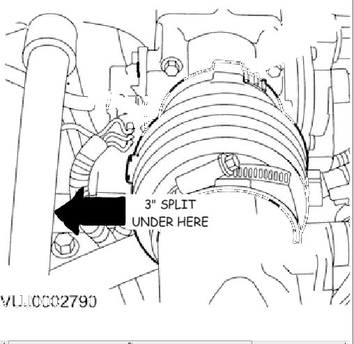

Might be worth checking this out too:-
Had this on mine the other week (limp home mode lean banks 1 and 2 sometimes OK mostly not) turned out to be a 3" split under one of the hoses.Dealer reclons common fault and cost £5 for new pipe (much sturdier than old one)
