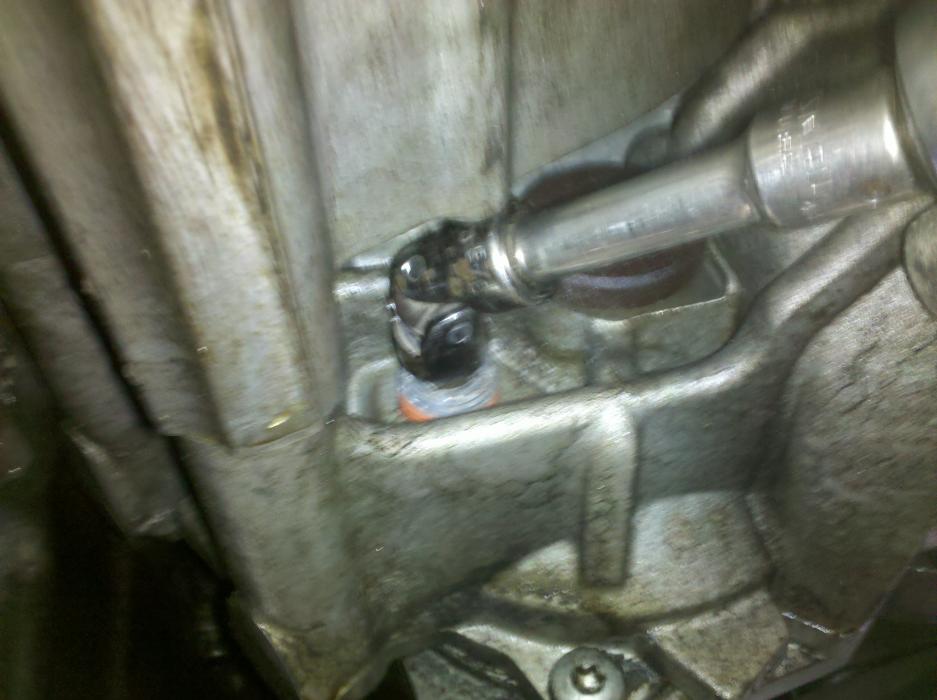

Default Picture of me removing the plug on an 03 X-type with automatic transmission
I have attatched a photo of the socket and extension etc that I used to access the plug on the TC. Hope this will help.
