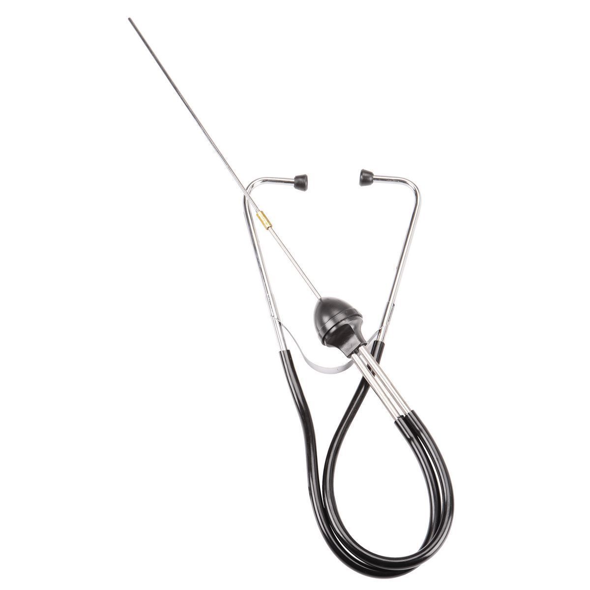

Automotive stethoscopes are available dirt cheap through Harbor Freight for like $4.99 (or mail order). Great for tracking down vacuum leaks and engine noises.

It may be worth taking to a shop to have the smoke test done to rule out a vacuum leak. Could a bad fuel pump cause this? Thermo, if you can recall, I wrote in a couple of months ago asking about a strange no start issue where it sounded like the car was starved of fuel. This miraculously cured itself; could these issues be related?

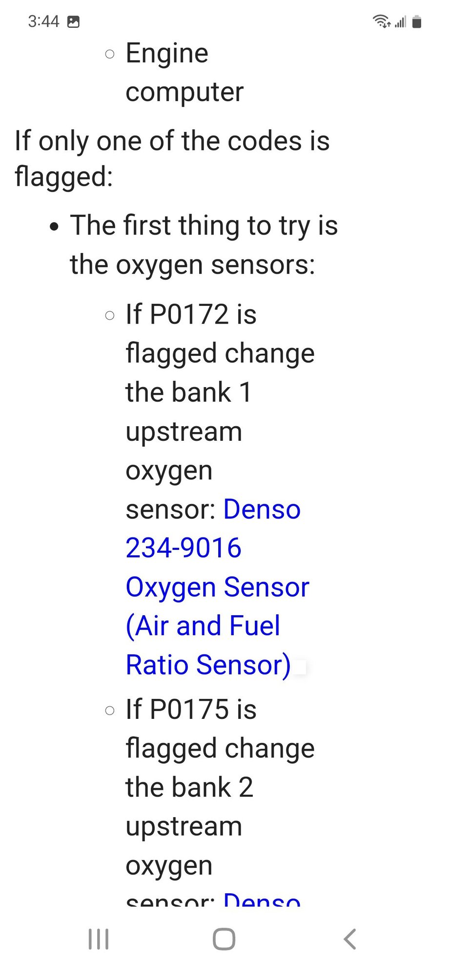

P0172 is the bank 1 upstream sensor showing too rich. P0171 is bank 1 downstream showing too lean. As JagV8 said, this is diametrically opposite readings. Too rich going in to CAT and too lean coming out of CAT.
P0171 =
P0172 =
So in answer to your question, could the O2 sensors have anything to do with it, the answer is yes.
BUT... as mentioned in the beginning of this thread I had the ubiquitous P0171 and P0174 (NOT 172) codes that researching air leaks (most common) did not have. I too cleaned my MAF with no corrective results, then changed to a NEW OEM MAF which cured my codes
P0171 =
P0172 =
My mistake! You are correct, I have P0171 and P0174. I also now have P0430 and P0420.
