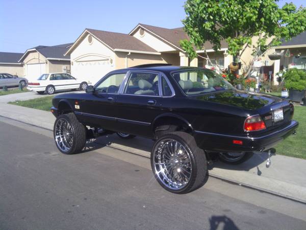

Oh my gosh... Jaguar monster truck? Anyway, supposing you could fit a Ford Contour turbo kit on an x-type, wouldn't you still need some kind of custom ecu mapping, and possibly bigger fuel injectors? With Hondas and Nissans, there are plenty of aftermarket ecu options out there because they are such popular tuner cars, but nothing like that exists for the x-type, so I'm wondering how you would go about fiddling with the fuel ratio's and stuff like that, or maybe somehow it's possible given that a few x-types have been turbo/supercharged.
