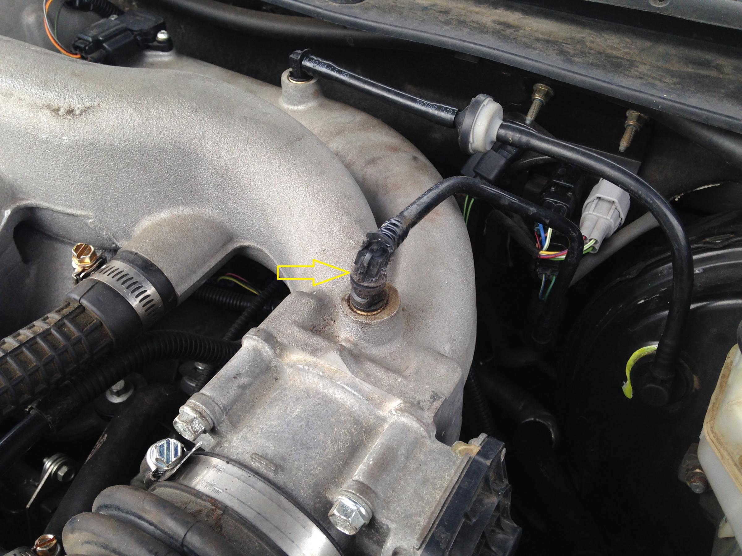

First, check the 2 hoses shown in the included photo. The front (with the arrow) is the Purge and the rear is the brake booster. I had a problem with the Purge line, but most seem to have the Brake Booster line around the white "bubble."
Start your car, open the hood and take a listen to see if you hear any air flow coming from either of these locations.
Good. Another spot to check is the PCV ribbed hose that departs the windshield side of the airbox. Place your ear near this hose as well to listen for air escaping. Also feel the underside to see if there is rot. This hose is also shown in the picture above...it's on the left side...now, your hose may not look like this one though.
If it is none of those 3 "hoses", the next thing to check is the IMT valve O-rings. I have not had to deal with this issue, so please search the forum for IMT valve/ring or something of the sort for more information, or wait for someone else to chime in.
If it is one of the 3 "hoses," it's an easy fix you can perform yourself. If it's the IMT valve o-rings, it's more labor intensive, but you can do it yourself as well.
