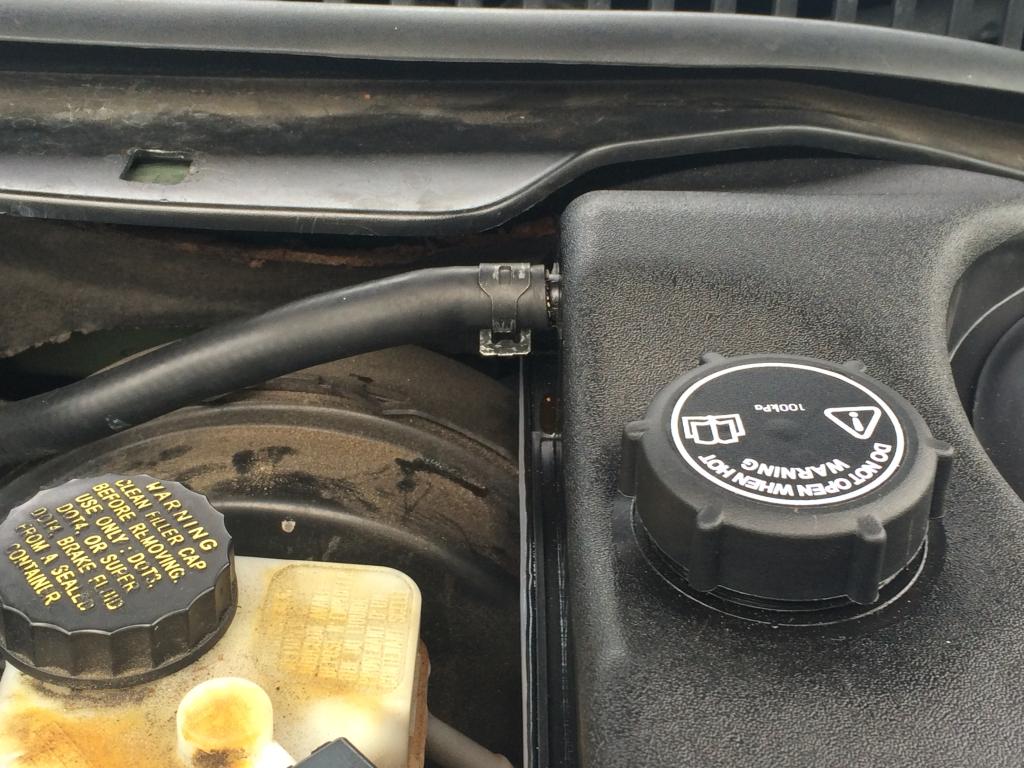

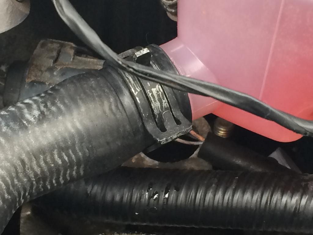

I should have known this would not be as easy as fitting the new tank in.
This hose is leaking:
And this hose is leaking:
Both right at the nipple. The second hose is new.
I am assuming that I need new clamps? Has anyone used regular autozone clamps?
Thanks!
