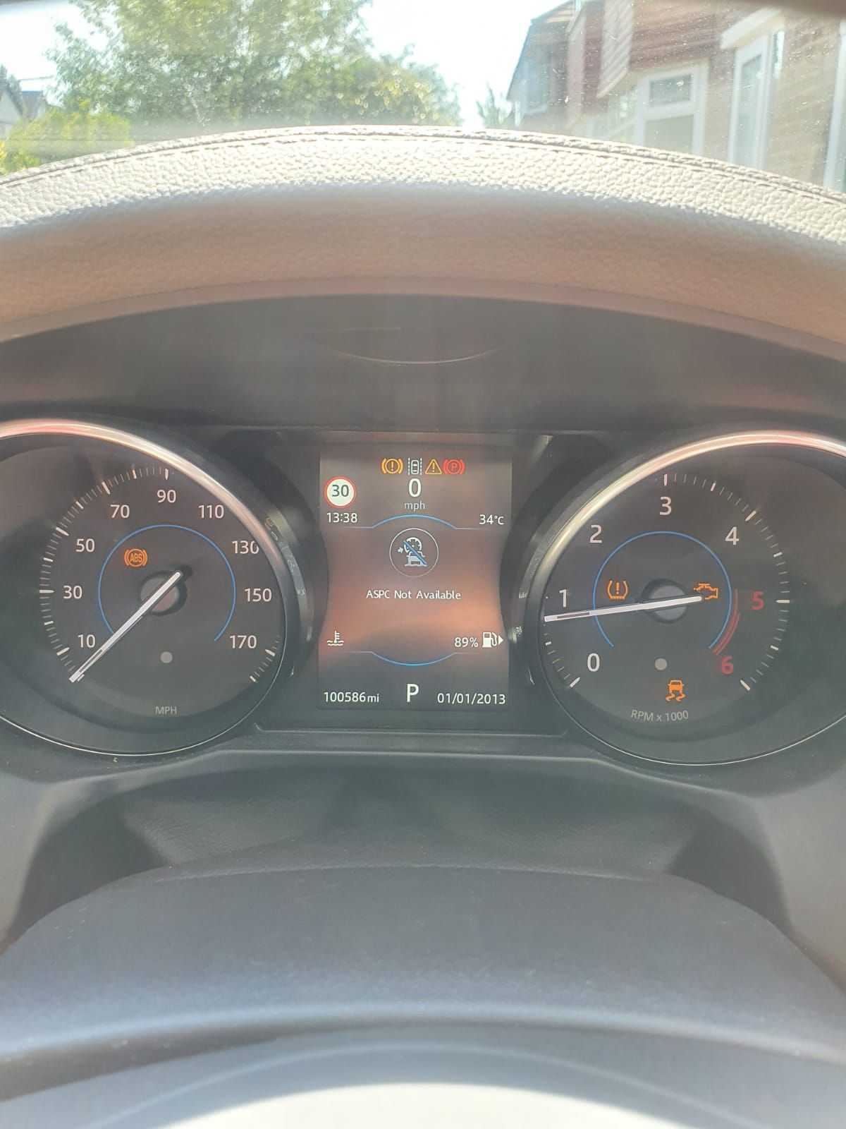

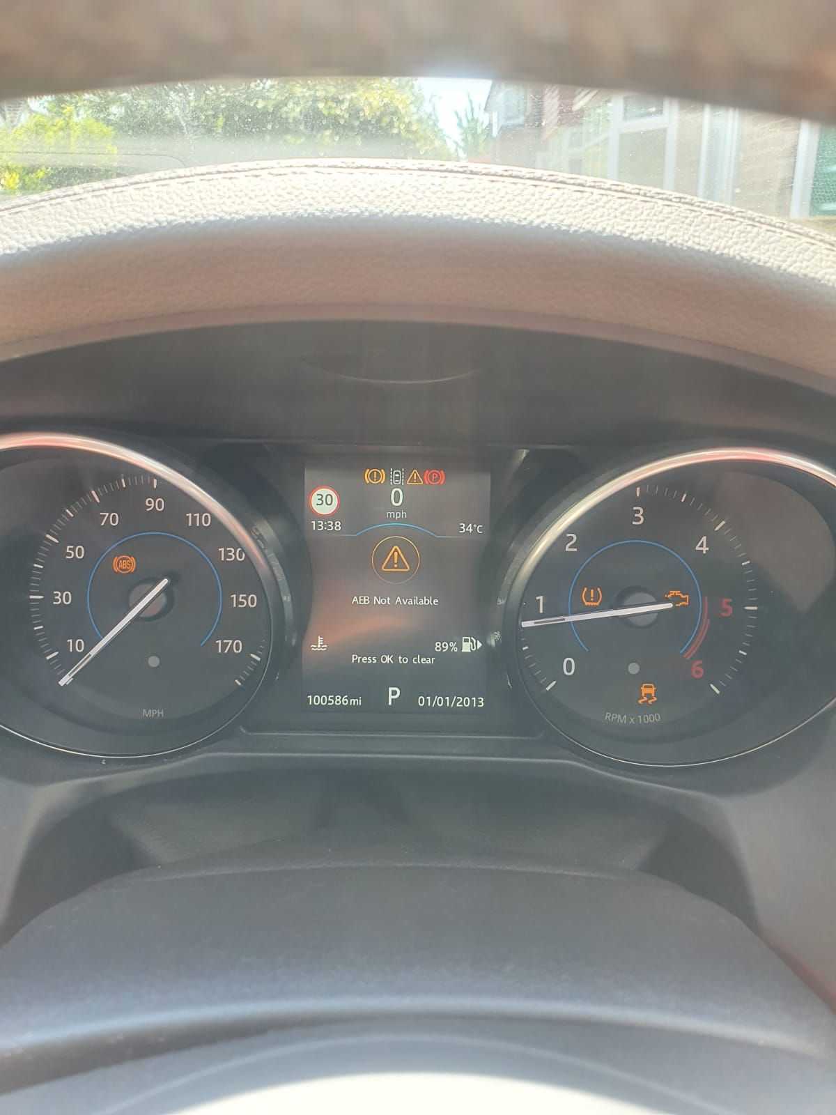

Hi ive recently had warning lights come up on the dash of my 2017 xe r-sport and when they come up the engine cuts out but the electrics are still on. The warnings are stability control not available, aeb not available, forward alert not available, engine temperature fault, lim standby intelligent mode not available, emergency brake assist not available. My jaguar dealership cant find a fault but they have the fault codes. Has anyone else experienced this

I have some issue now. I had change battery but all warning lights still there.

Some fault codes don't clear when the underlying cause if fixed, they have to be manually cleared. You need to get them cleared and then see if they come back when you restart the car. If they do, then you need to investigate. What made you think a new battery would clear them ?
