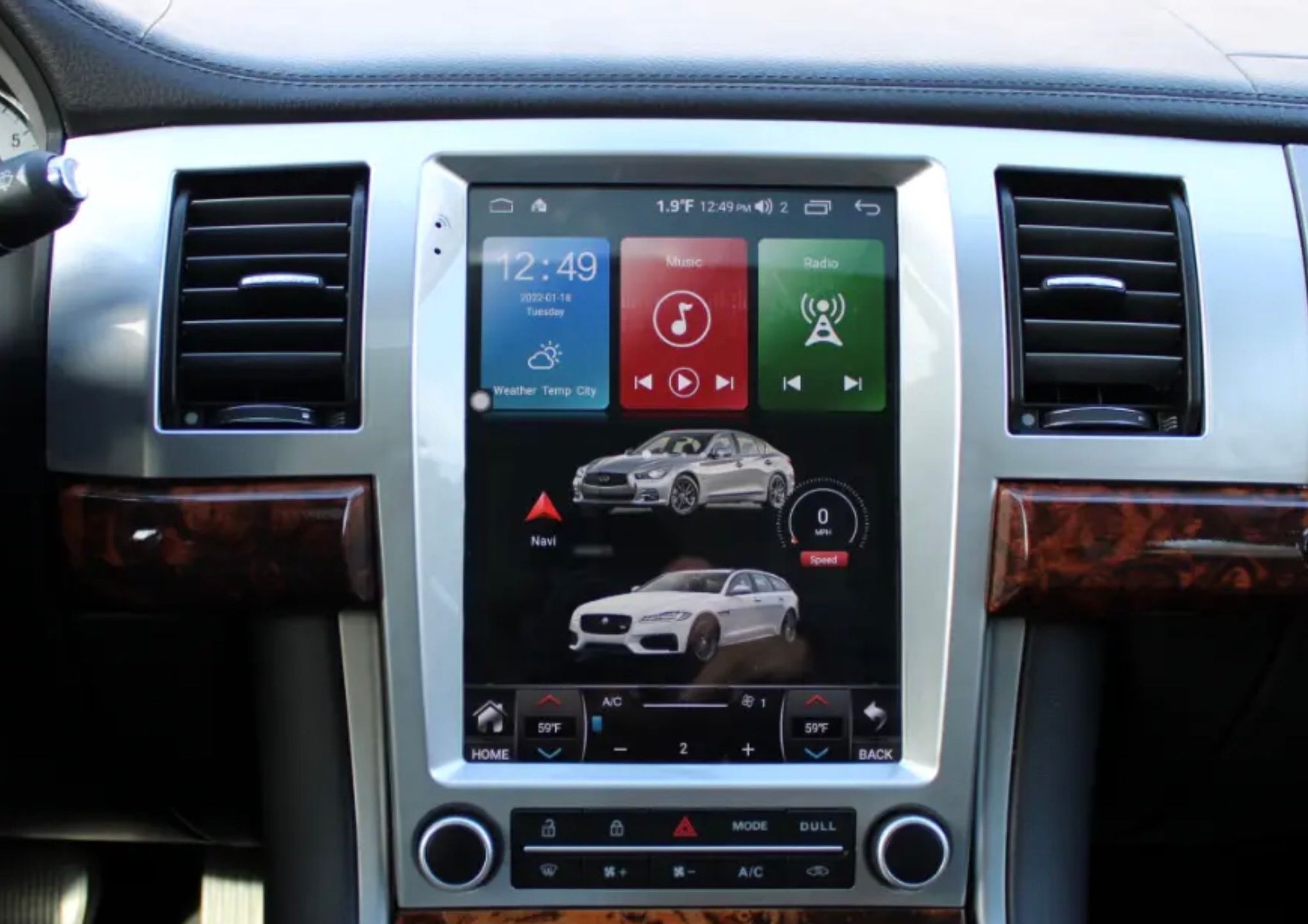

Has anyone used this head unit as a dash cam? I'm thinking of using the supplied front cam and OEM rear cam as a dual camera dash cam setup that automatically boots and starts recording when I start up the system. Is this possible?

it has all the inputs for it , im doing a 360 degree birds eye view cameras install witch has a built in recorder ,if some one tampers with your car it stats recording ,when it gets warmer ill make a video
