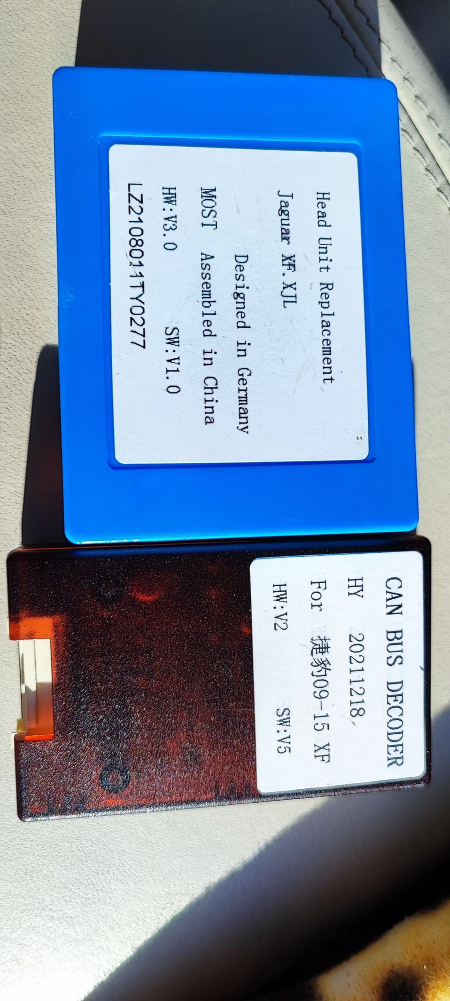

Hello Denis, As agreed, you will find attached one of the Can bus and the box. Thanks again

Your decoders are correct and latest version, check your settings to mine ill post them thursday

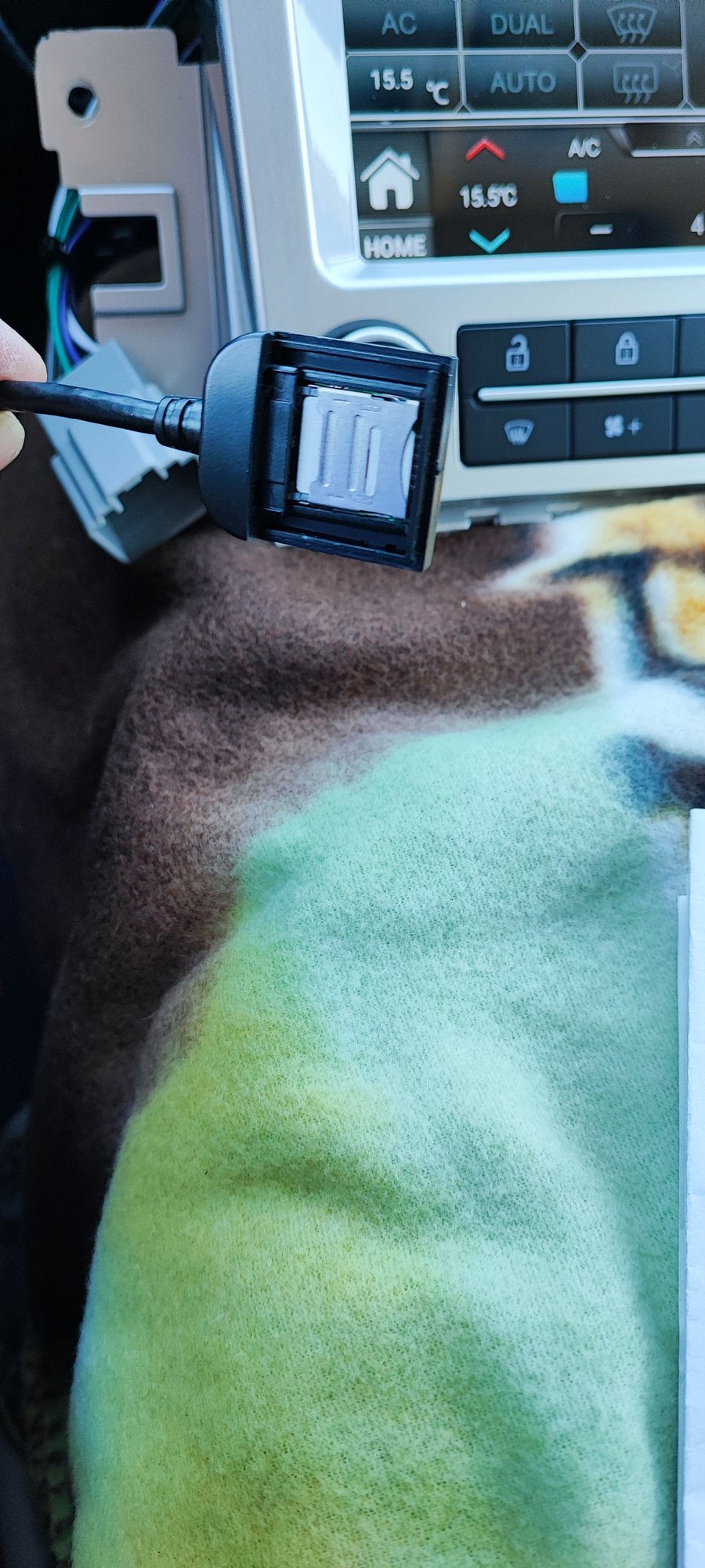

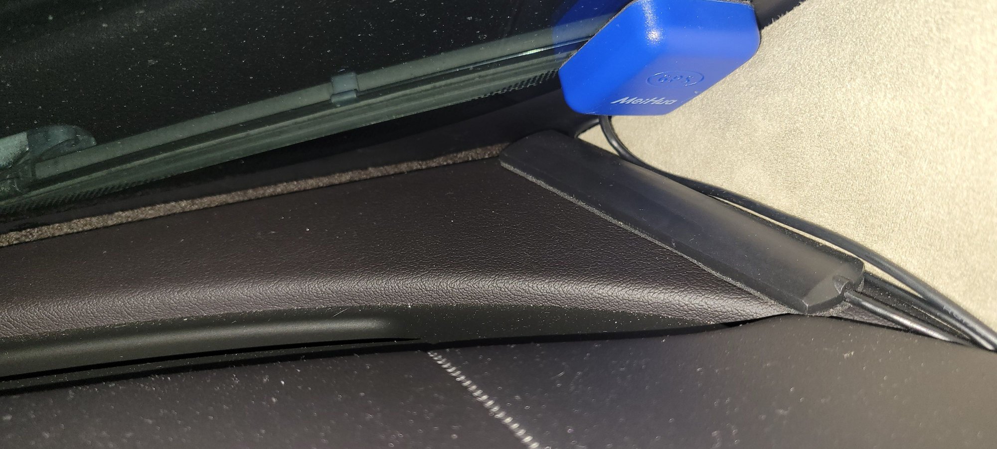

for the back up camera you have to one more time initialize the unit ,,do you have a pic with the sim card in the holder ,i just want to start from the beginning to see if we can resolve this ,also did you mention if you can get regular hotspot, also where do have the 4g Arial not the blue gps in the pic, the flat antenna in the corner
ill be removing the blue gps ,i don't need it anymore ,i use the oem one on the roof

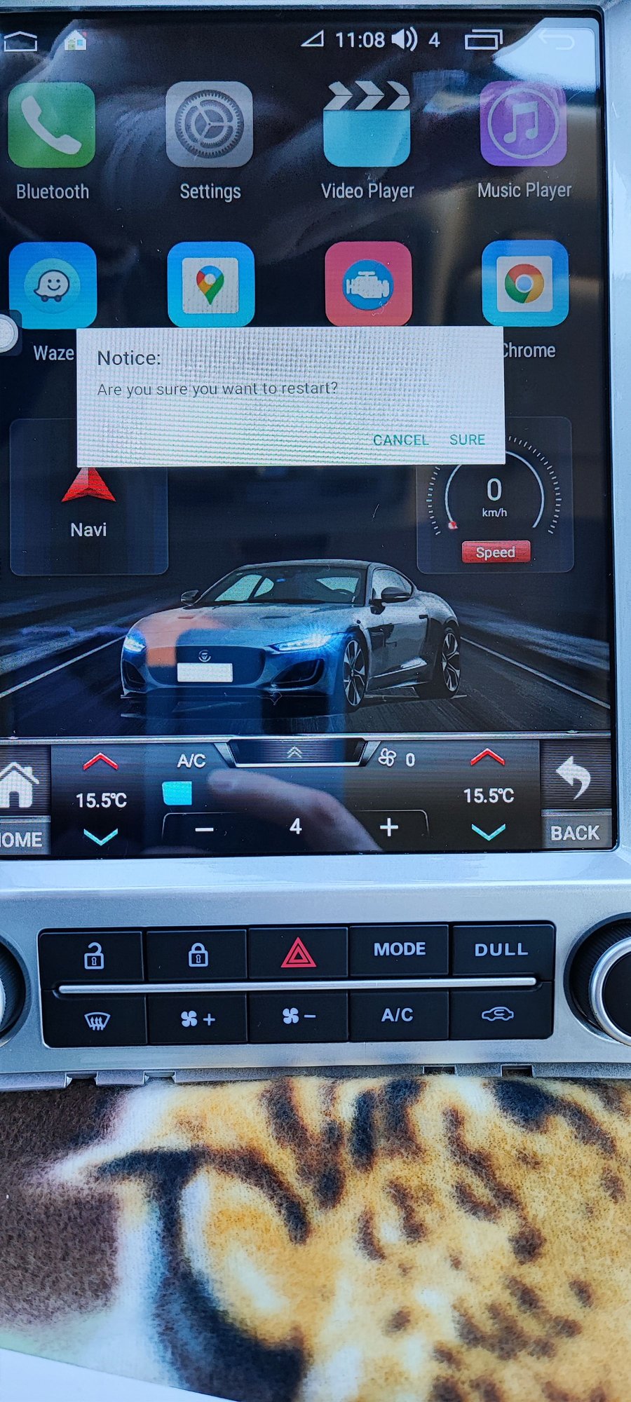

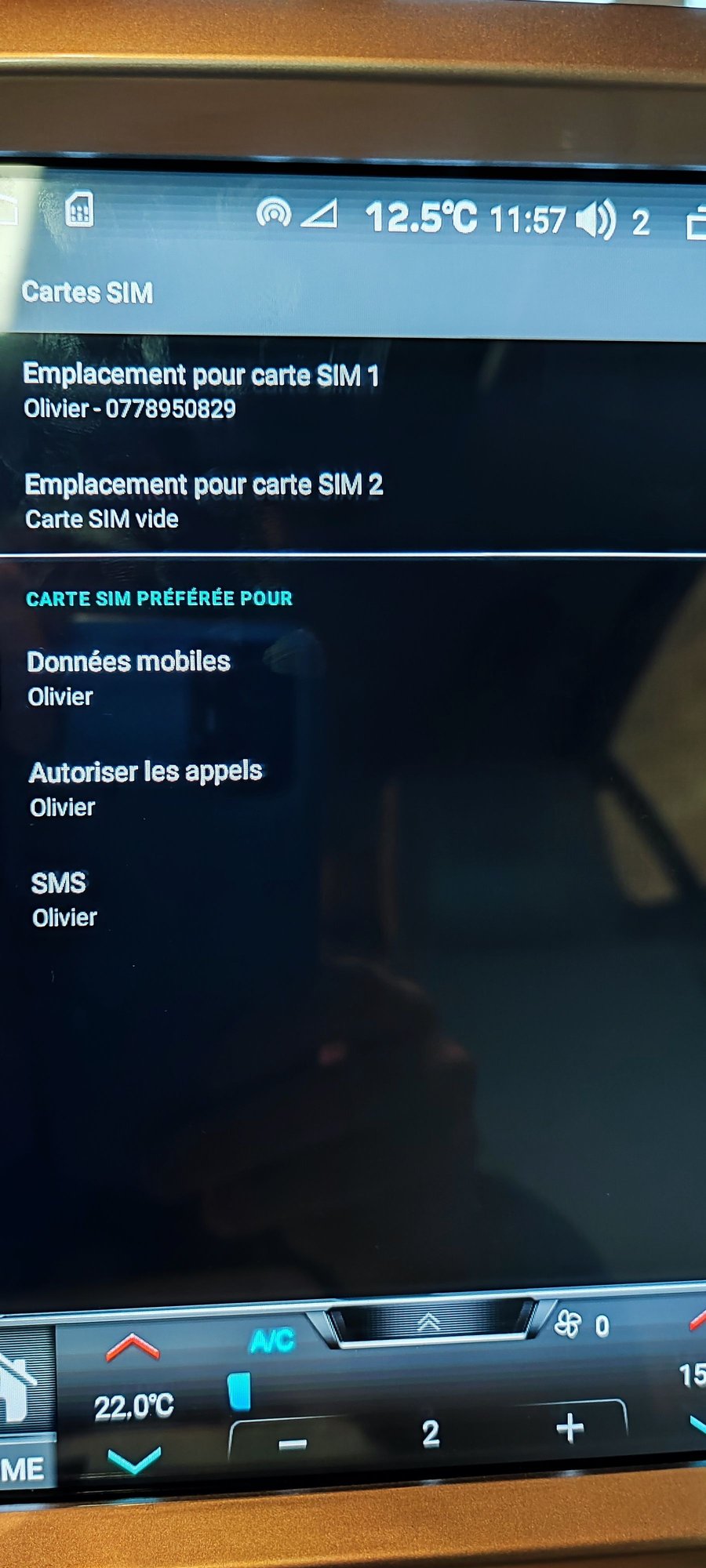

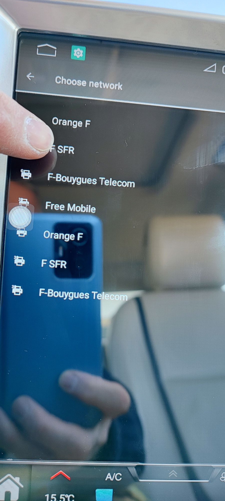

Old Feb 26, 2022 | 02:37 PM
  #276
ocarpa15's Avatar
Joined: Dec 2021
Posts: 19
Good evening Denis,

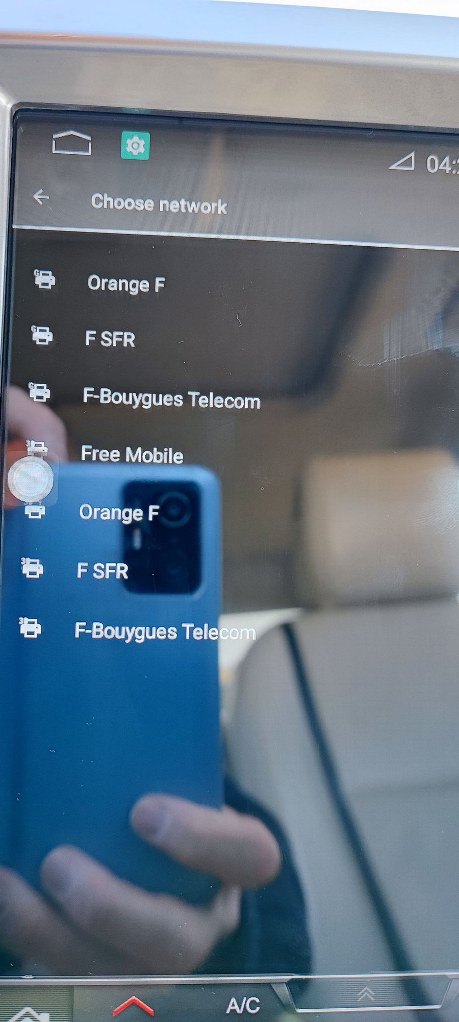

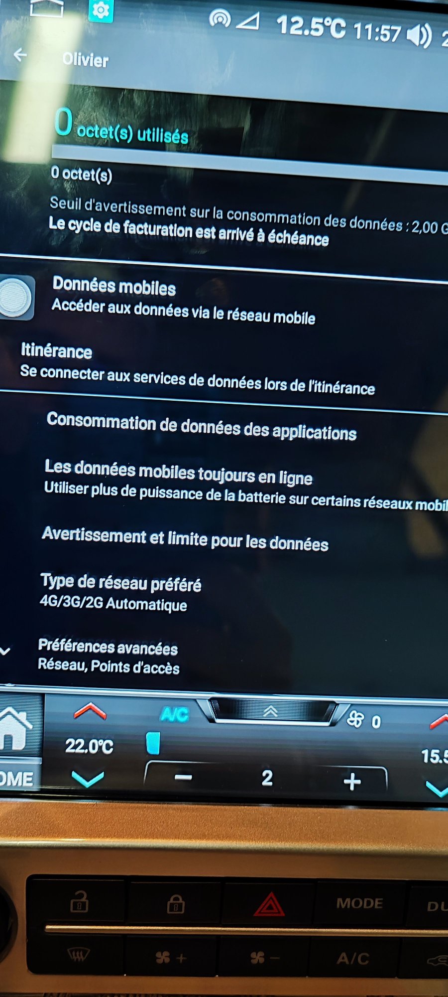

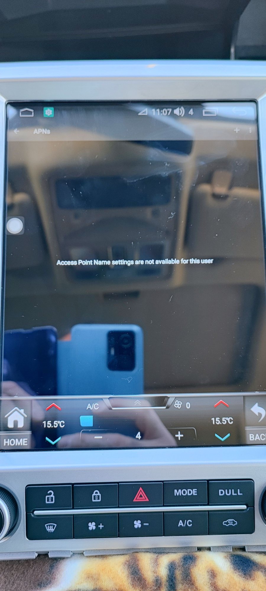

Attached you will find various photos taken during yet another 4G connection attempt.
Despite my various attempts, it was impossible to find a network or save the network settings.
I have correctly positioned the GPS and 4G sensors as in your photo. When I'm in automatic mode, I can't connect to it. Thank you again for your patience

I forgot to attach the photo with the SIM card
