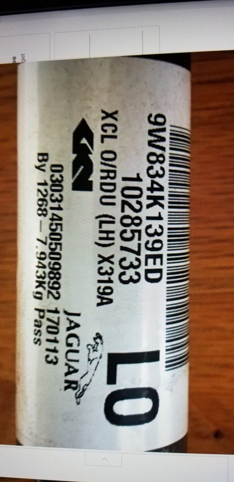

I have a 2010 Jaguar XFR and I am having issues finding parts! I recently changed the rear wheel bearing due to failure. The rear left axle had to be removed due to the splines in the hub being welded to the axle shaft with rust. Took a press to separate them. After doing so i noticed the CV boot closest to the rear differential was extended meaning it had pulled apart at the joint. I cut the CV metal retainer strap and put all the ball bearings back and realigned CV joint and put the boot back with new retainer strap. Now I have a serious vibration coming from the rear of the car. I need help finding an aftermarket replacement CV axle. Does anyone know where I can get one? The dealership wants way too much for a simple CV axle. They were originally provided by GNK Driveline but that is as far as I have been able to find. I would also like to purchase a driveshaft support bearing without having to buy an entire driveshaft. I have a place local that will install the bearing and rebalance the shaft. This part was also supplied by GKN Driveline. Can anyone help me?

VetteOwner I looked at the ones carid offers. They are the same the dealership offers. They are almost $900 for a simple CV axle. Not sure why they are so high. BMW uses a similar GKN axle and is offered at a quarter of the price. I am hoping to find one much cheaper. 2018XF25T the axle they have pictured has a different style CV boot than the XFR. I have tried to cross reference multiple axles that I found on ebay that pictured the factory tag/pin stamp from GKN and the numbers wont pull up anything but the ones on carid and the dealer websites. I attached the one pictured below for reference. Maybe someone has access that I do not. I work for a plant that makes front and rear cradles for the Ford Mustang and full frames for the F250 to F650 so I am trying to pull strings and get access to OEM CAD files for the axles lol. I appreciate everyone's replies! I will be trying to quote customer axles in the mean time just in case.
