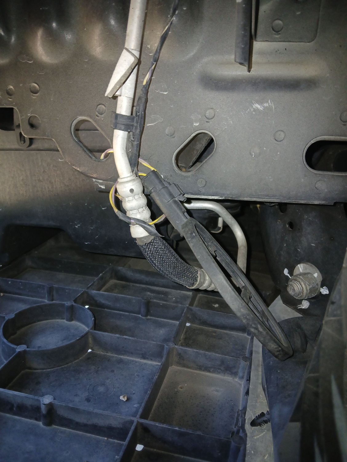

On the driver side I found the antenna like this
Again the tpms warning light was OFF for 2hrs of me buying/driving car, despite antenna being wrapped like this?
I put it into its little holder for now anyways

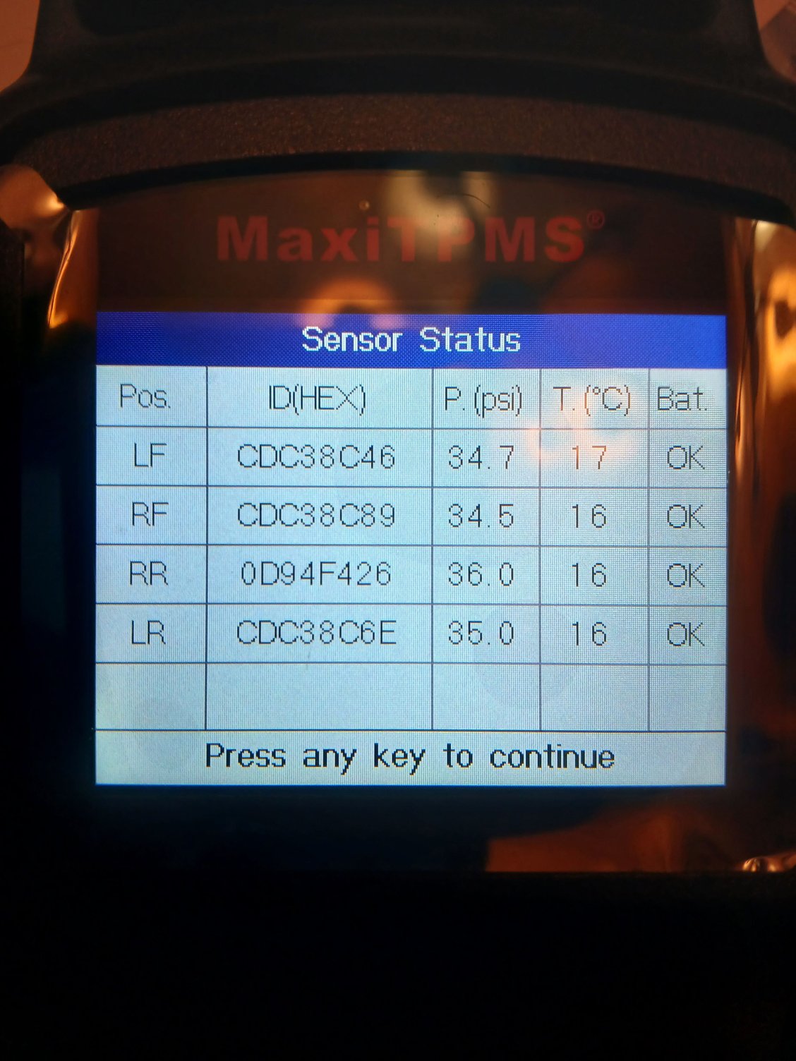

I ordered and received a TPMS unit and did a check. 315MHZ and all sensors seem to be working w. Battery, but it is throwing an intermittent code between sensor & sending unit, guess I'll have to track down antenna, haven't found it yet... what is the easiest way to locate it please?

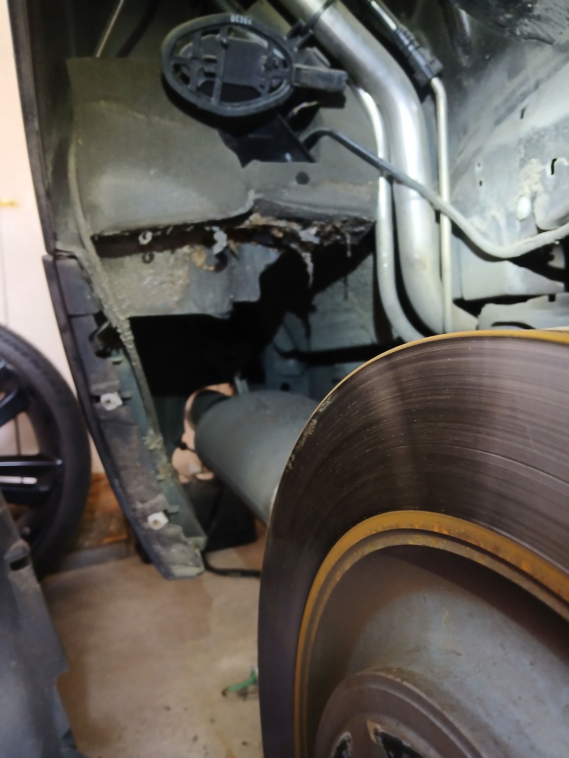

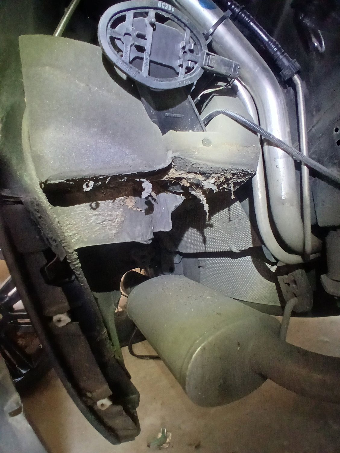

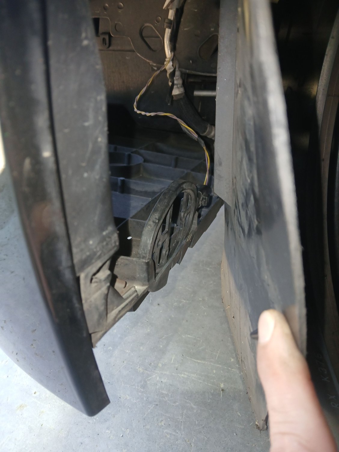

So i jacked up rear passenger side of car, removed wheel liner and located the antenna mounted nicely, plug looks good and wiring too... next, order a new antenna... do they tend to fail?
