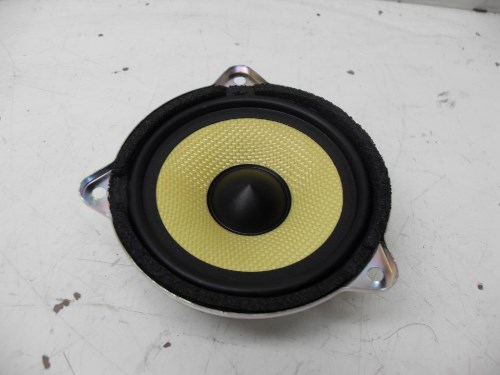

The surround speakers in the 2008-2011 B&W cars are a single-driver, you can see in the pics it's a midrange speaker only, actually it's the same speaker that goes in the front doors as well, single cone only.
But in the 2012MY it changed to a dual-cone for the surround speakers, which is a tweeter and a midrange together.
However, the speakers in the 2012MY B&W system are not identical to the 2013MY onward system. The 2012MY were still yellow.
Here is a 2012MY B&W Surround speaker;
(C2D2079 or AW93-18808-EC)
Here is a 2013MY Meridian Surround speaker;
(C2Z22817 or BJ32-18808-DC)
And just for reference again, here is the 2008-2011 B&W Surround speaker;
(C2Z2287 or 8X23-18808-BA)
I can tell you that the connectors on the 2008-2011 speaker are different to the 2012 or 2013-onward ones, but the 2012 and the 2013-onward are the same connector so you can fit either one.

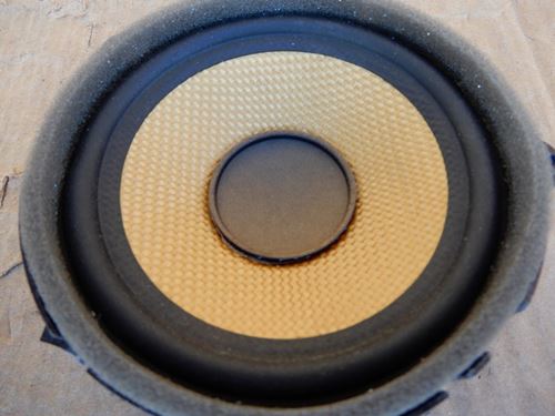

The other B&W speakers in the 2012MY are also yellow, this is the midrange speaker from the front doors;
(C2D2076 or AW93-18808-BC, these speakers are also used in the XJ with the B&W system)
Now, is there a difference in sound quality between the yellow B&W and the black Meridian speakers? I cannot say for sure myself, but a few people have told me there is a difference you can hear...
Seems that the midbass speakers in the doors in the 2012MY B&W system are not yellow, they are black, but from the pictures I can find they still appear to be Kevlar like the yellow ones, where the Meridian speakers are not.
Where are you located? I know a few people around the world with the necessary equipment to make the programming as part of this retrofit.
