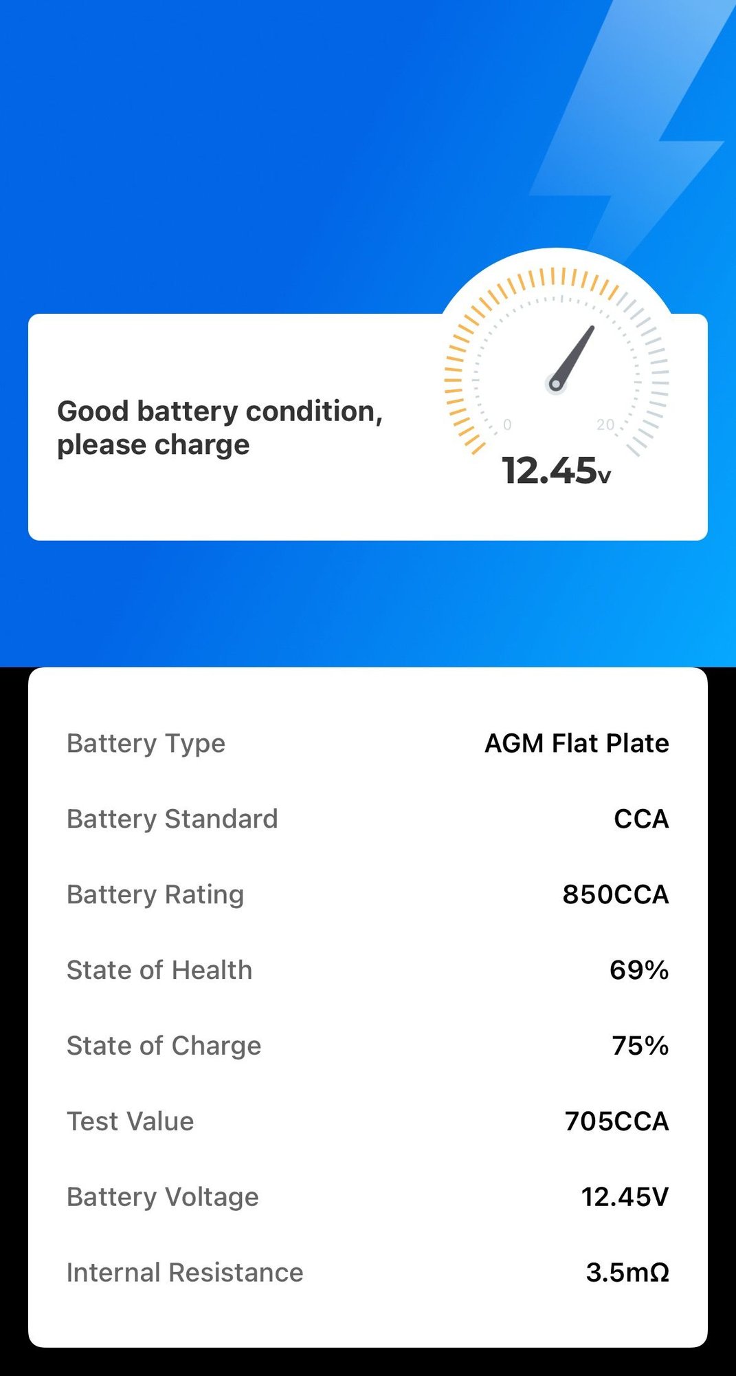

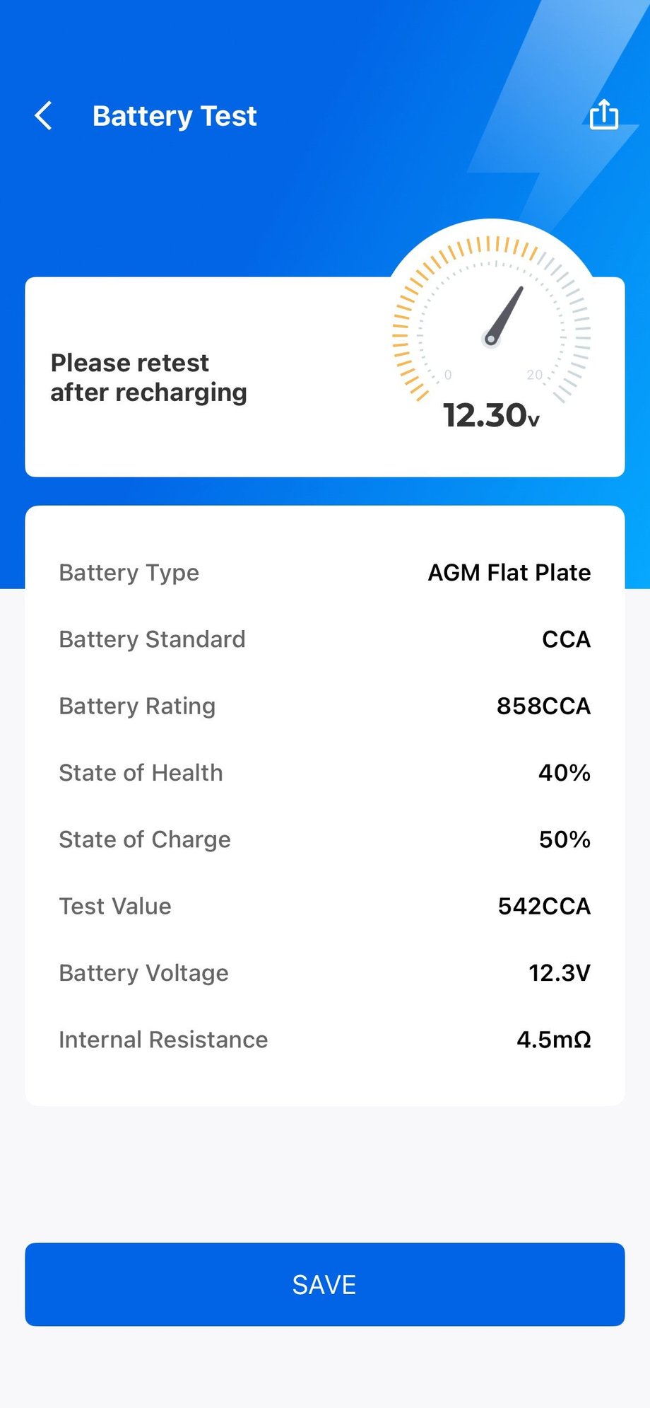

Old Dec 3, 2025 | 09:50 AM
l.clay.collins's Avatar
Joined: Dec 2013
Posts: 22
From: Houston, TX
Here are the last 2 battery tests before I replaced my battery. The first restart after a long drive pretty much guarantees the wipers and airbag light comes on. So far so good after a new battery with dealer calibration.
