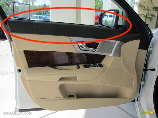

I am talking about this area. I removed all of the panels and hit the metal part of the door, I can hear the glass rattle.
Old Sep 9, 2020 | 02:29 AM
prolepsis's Avatar
Joined: Jan 2013
Posts: 174
Likes: 12
From: At Home
When does it rattle? For example, only when the window is fully closed, or only when partly open, only when fully open, or all of the above?
Old Sep 9, 2020 | 10:29 AM
Jaaaggg's Avatar
Joined: Jan 2015
Posts: 444
Likes: 133
From: Atlanta, GA
I tested fully closed and partly open, rattles in both scenarios. I need to check fully open.
I wonder if the rear channel has become loose somehow. From memory, there are 2 screws that secure it to the inner door; one high and one low. This channel needs to be loosened to remove the window glass. If you’ve replaced a lock mechanism, then it may have become loose.
