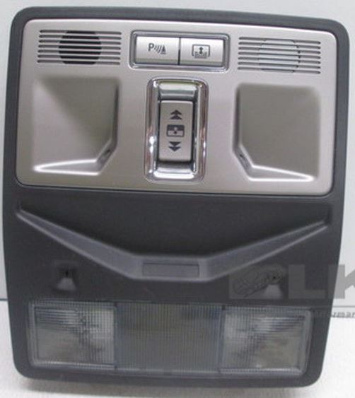

I own a 2009 XF 4.2 SV8 that seems to have every option except the rear sunblind.
So I bought one out of a 2010 vehicle for $200 which is already mounted on the parcel shelf/rear deck trim and intend to fit it soon. I bench tested it and much to my surprise it works perfectly. I also purchased an overhead console module with the sunblind switch to swap or use for donating parts as needed.
Before I commence the project and start to dismantle the vehicle, would anybody out there know if the existing wiring loom/harness has the correct number of wires to facilitate this change or will I need to add them? Same question repeated for fuses and relays?
My vehicle already has the sunroof option.
Any help would be much appreciated.

Just plug it in, it will work.

Installed the parcel shelf with the sun blind option last weekend and the overhead console with the extra switch.
I put a lot of effort into making sure that the rear shelf would not have any excuse to rattle but to no avail. Swapped a few things around here and there with the overhead unit.
Apart from that, it just simply worked first time.
Plug and play.
