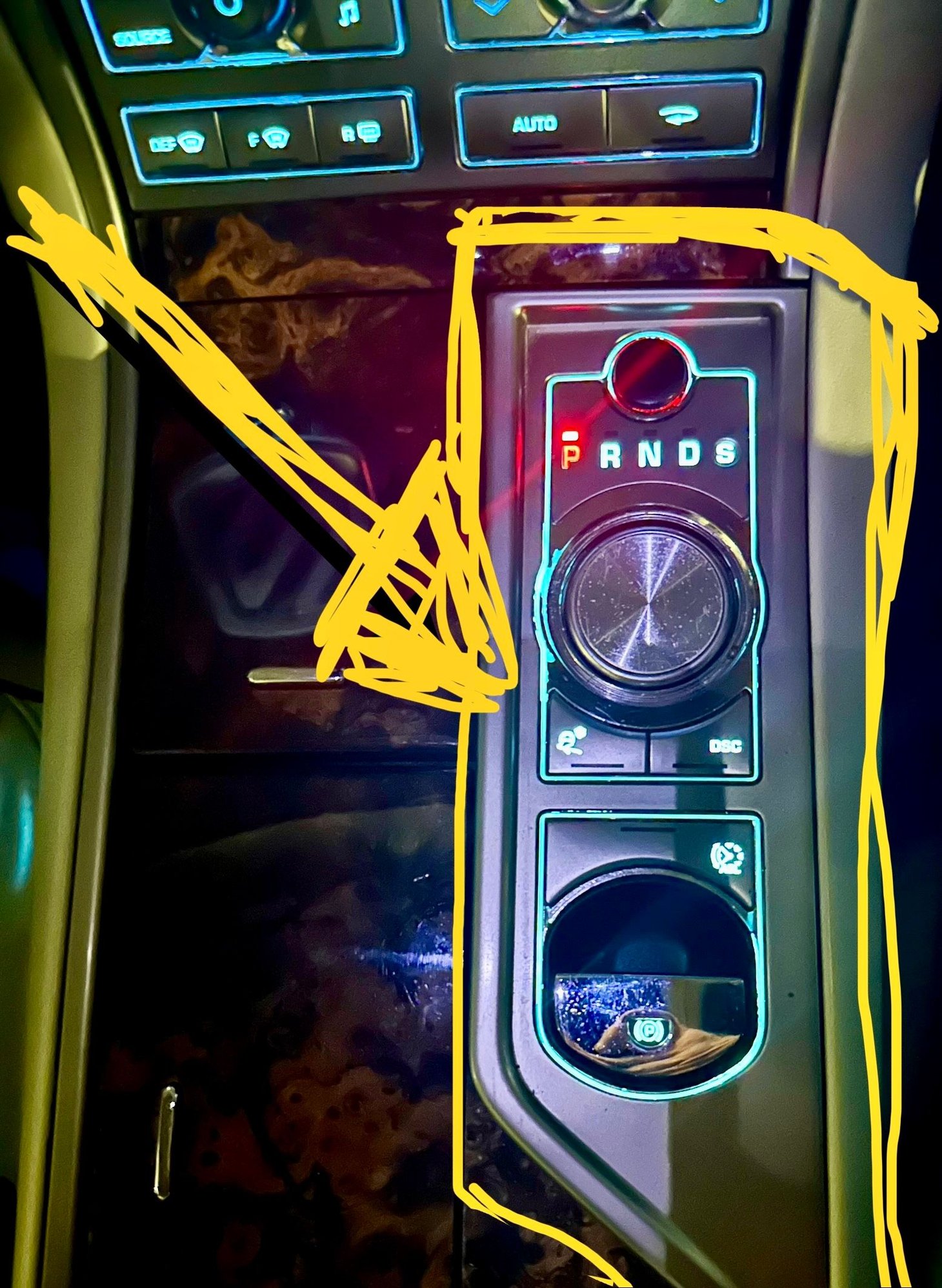

Default In 2009 Jaguar XF this message is generated by the gear selector module
In my 2009 Jaguar XF this message is generated by the gear selector module
I suggest removing the module and screwing it together properly.​​​​​​​
Thanks I tried this. There were some minor tightens done. Result still the same.

Hello again,
I still bet that the gear selector module is causing the problem. There is a poor contact somewhere, in the plug or, more likely, on the electronic board, a bad solder joint somewhere.
