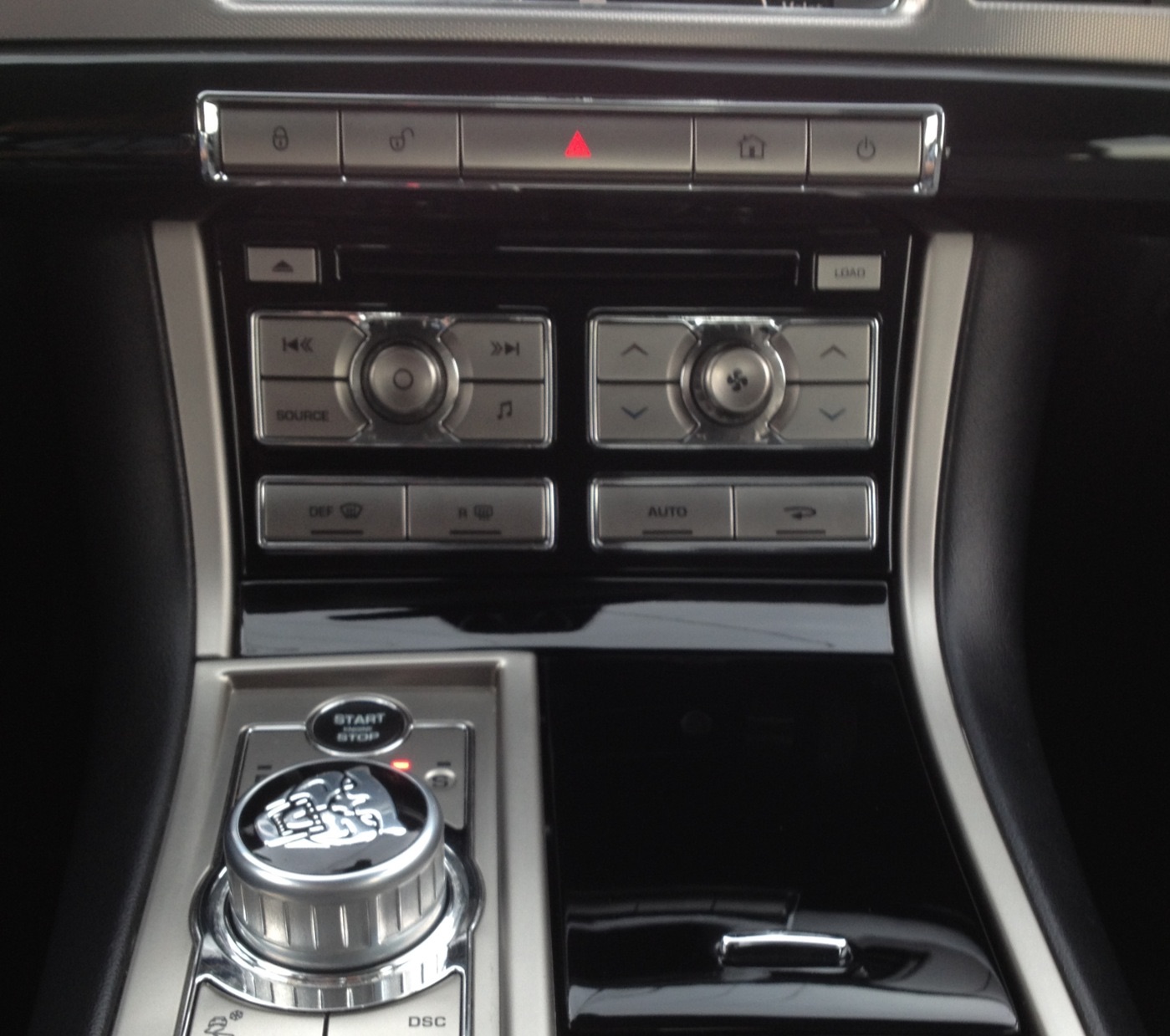

I've actually taken apart a center button unit from the long blade and the plastic buttons actually come off very easy. I was hoping the silver was a metal cap over a translucent button so I could paint the silver but it's not. It's an odd clear section inside for the little image to glow. And the LED bulb is very far inside the unit.
I had my veneers all refinished in piano black and I also had the silver panel around the buttons painted as well.
It comes off very easy. You could order some gloss vinyl wrap and cover the panel to match your veneer. You may have to try several colors to get a good match.

Decent interior dude. I am thinking of refinishing my veneers to black piano and gloss vinyl wrap for the panel. Black piano veneers only come for 2012+ models. How did you change it? also do u think the 2012 model panels will fit to our car and function?

Is it difficult to remove the vaneers?

The dash and console very easy.
The doors take patience. Whole door panel comes off. Only 4 screws and plastic rivets, unplug a couple speaker and wiring harnesses and release the handle cabrl pin. Then there's clips holding in wood. Bitch to get off the clips! Then the panels come right off.
I'm thinking about wrapping all my old veneers in black brushed steel and selling on eBay.
