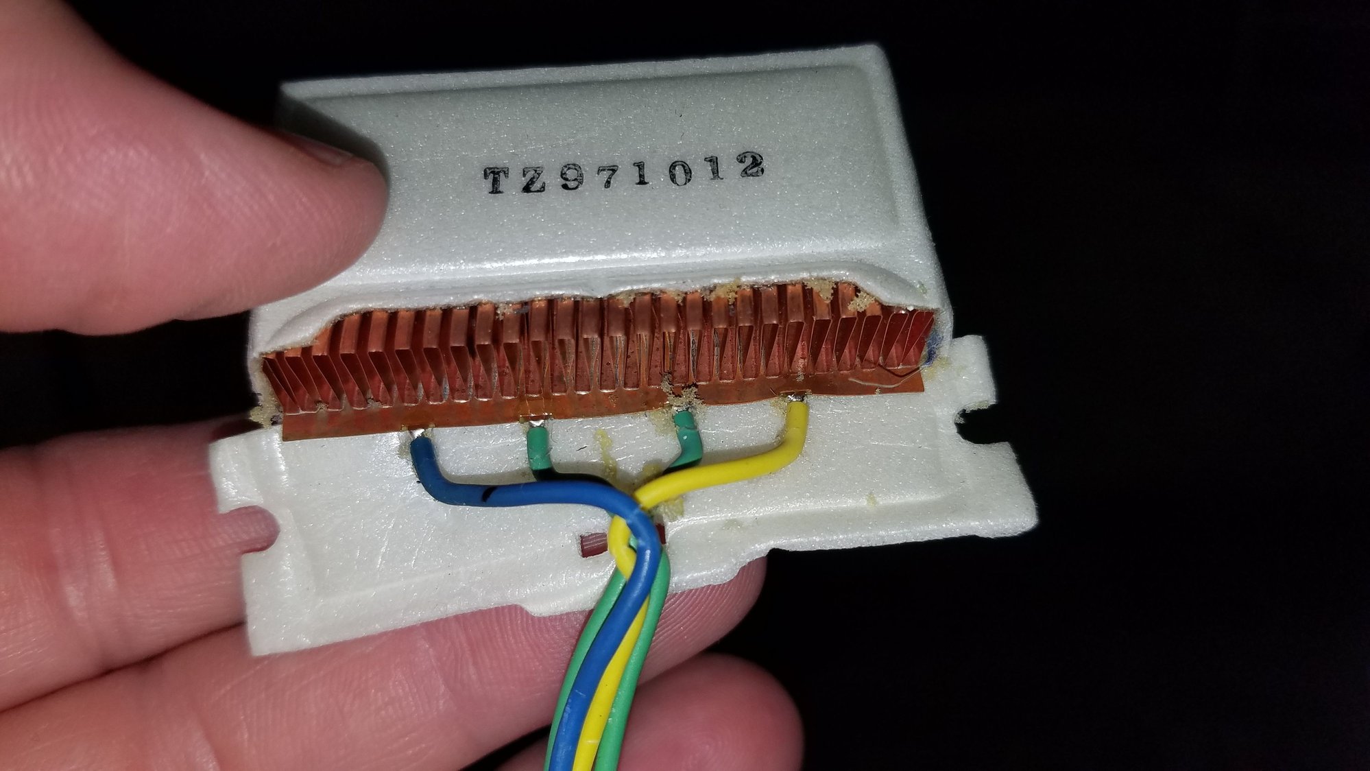

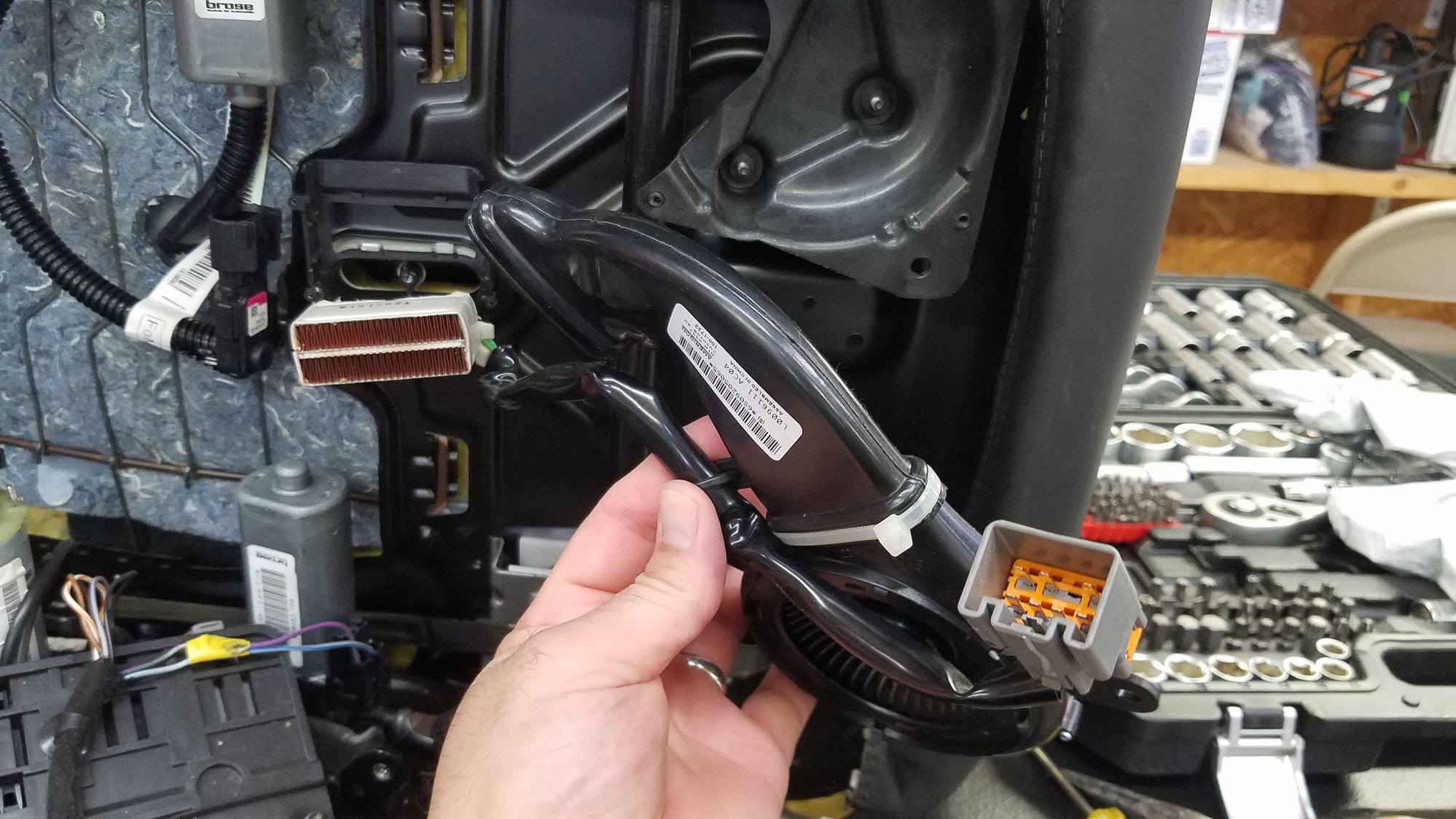

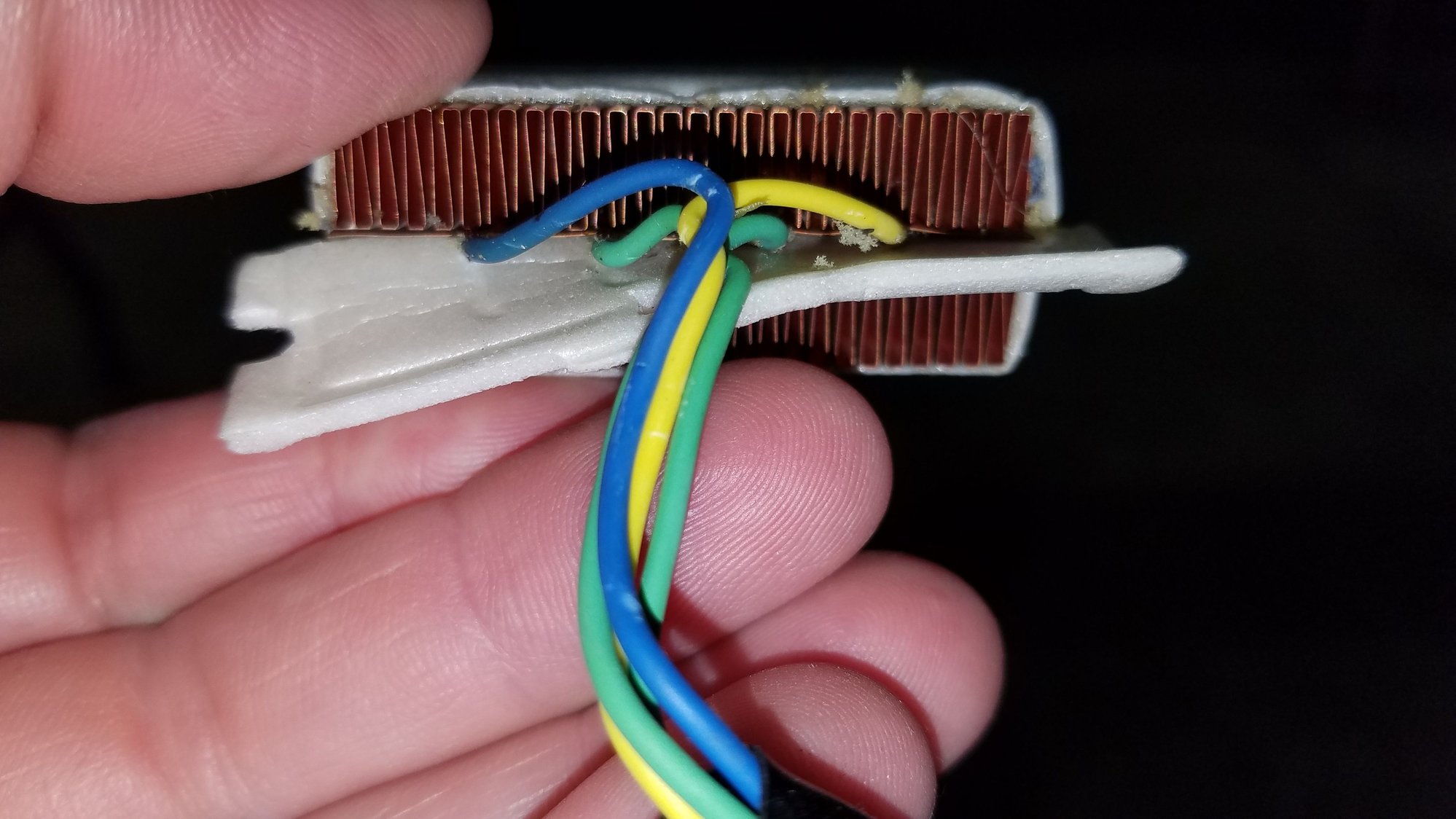

I suspect driver seat bottom cushion peltier is bad, and have now had opportunity to check passenger side seat for comparison's sake. I know that sounds odd, but passenger works and i wanted to see what it looks like in working order first.. will extract driver's seat soon.
Who has changed the "module" and what did that consist of?
see my pictures of the part - the wires go back to another harness and it looks like might either have to splice in 4 wires or buy an entire assembly with the fan??
anyone have experience with replacing just the peltier device? and a place to buy it?
overall assembly with fan - 1 wire harness
copper element looks clean - this is from operational passenger side seat bottom
4 wire module with part number

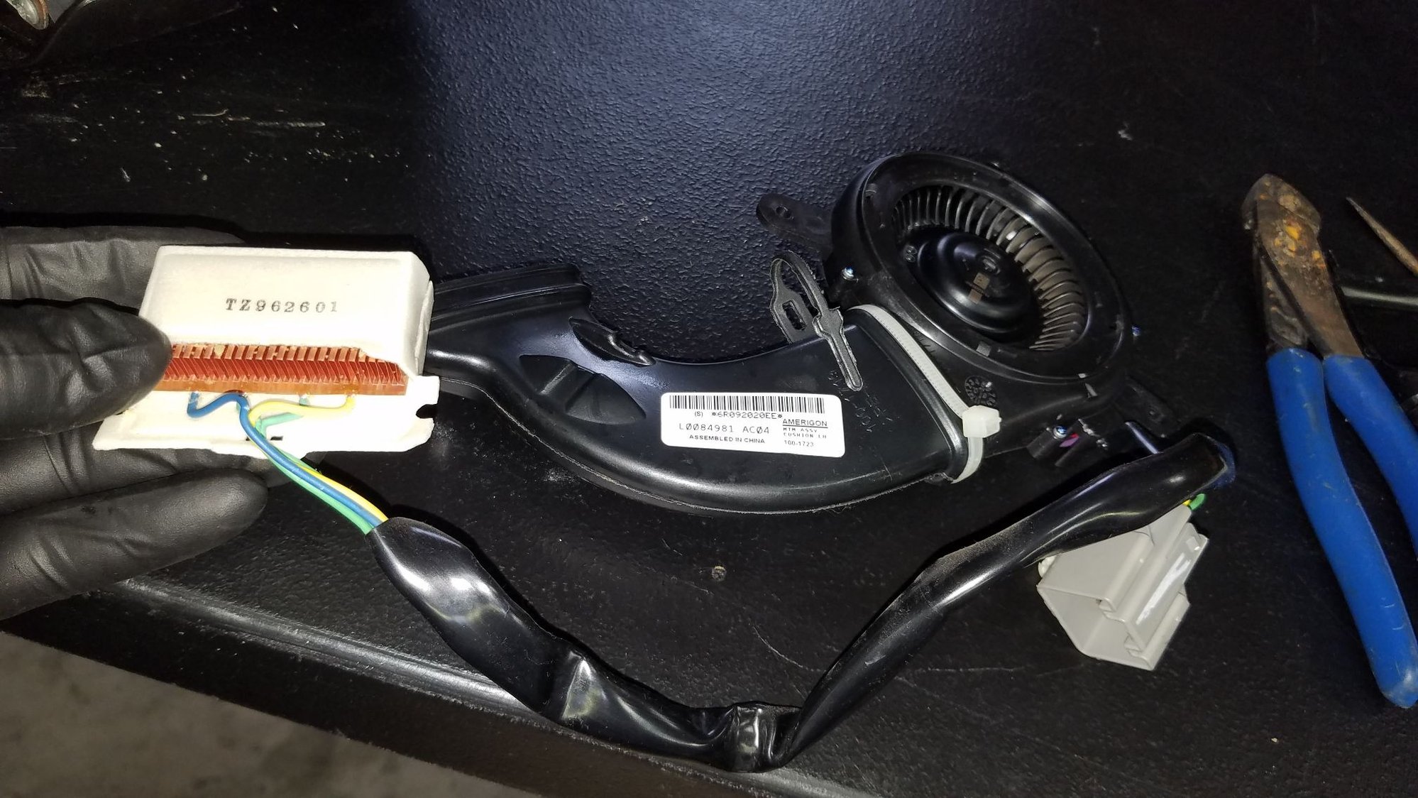

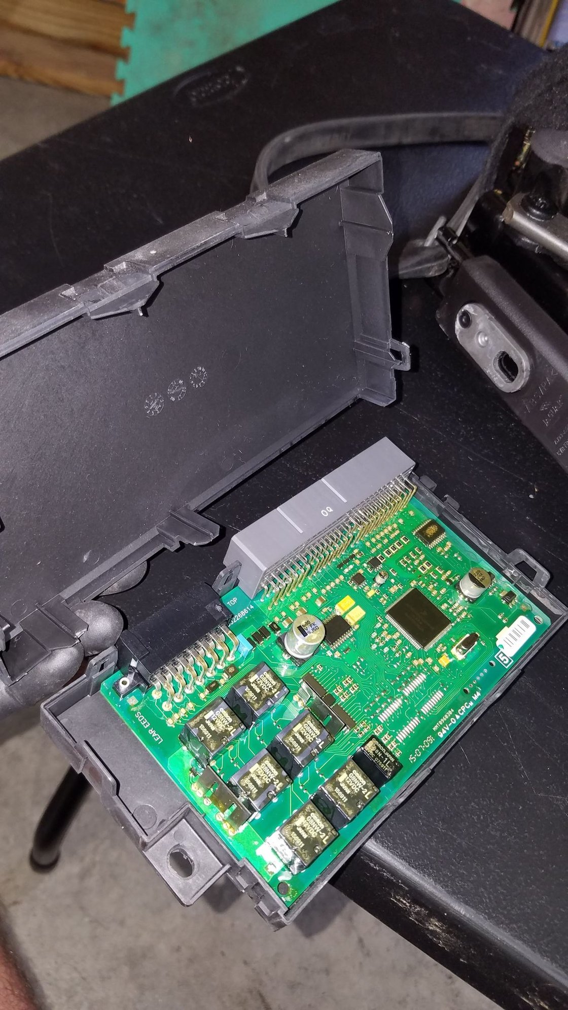

so the driver's seat is similar, but opposite, layout of the passenger
it has a large control module with a complex looking circuit board.
the copper fin device in both seats looks in great shape and I'm at a loss as to what makes my seat fan turn off after just a few seconds on the driver's side.
the number on the copper fin device seems to be a S/N, rather than a part number (i think)
both fans seem to be in great shape.
there's been theory that a fan isn't moving air enough and a high temperature sensor turns it off - where is this temp sensor?
re: trouble shooting - i have previously repaired the broken duct in driver's seat back. have also selected to turn seat back "OFF" and just run the seat bottom, but similar run cycle happens where it turns off in a matter of seconds
i don't know if it's the entire fan needing replaced in back or bottom or the control module or something incredibly simple
looking for some expert level help.
driver's seat - large module
inside driver seat module cover
driver's seat bottom fan / peltier module
The copper fin device is a Peltier module, and the fins are a heatsink. In simple terms, the peltier unit is an electronic heat transfer module, and when you reverse the polarity to the module, it reverses the direction of the heat transfer. This allows it to heat up air as well as cool it down when controlled by the seat climate module. They use these devices in those cheap little mini fridges that take 6x cans of soda (and aren't very good).
I believe the temperature sensor is integral to the peltier unit itself.
From what I understand, when the fans run for a few seconds and then turn off, it's doing an initial self-test where it powers up the peltier module and the fans and checks that the module doesn't get too hot - that's why cracked heat piping (that you mentioned you'd previously repaired) causes these to fail - too much air leaks out between the fan unit and the peltier unit, causing the airflow over the peltier unit to be too low, and a risk of overheating, so the seat climate control module just shuts off any heat to that seat. I suspect turning the seat back OFF doesn't stop it disabling it after a failed self-test where it tests ALL the fans, and that's why you're still seeing a problem.
Based on this, I'd check the repaired "accordion" piping in the seat back. It always seems to be that bit that fails. I tried repairing mine and it worked for a while and then failed even though the repair still seemed good - the only fix I had was to replace the entire module for a new one (from memory, around $150). At a guess, too many tests performed on startup with not enough airflow eventually kills the peltier unit such that even if you repair the piping, it still won't work.
