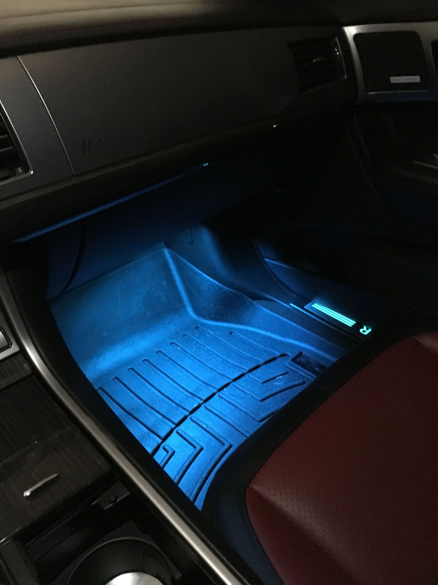

Anybody found a source of LED bulbs for the footwell W5W that match the colour of the the blue/green lighting in the dash or the window switches ? There are a number of "blue" options out there in eBay land but would appreciate any links from recommended vendors/parts...I could replace them with straight "white" as I have done in the courtesy/map clusters but I'd quite like to go blue to match the rest of the "mood" lighting ;-)
Yes, I have them.
Attached Thumbnails Footwell LED bulbs matching theatre lighting blue ?-image-1380197395.jpg

Here's what those LED bulbs look like in my footwell
