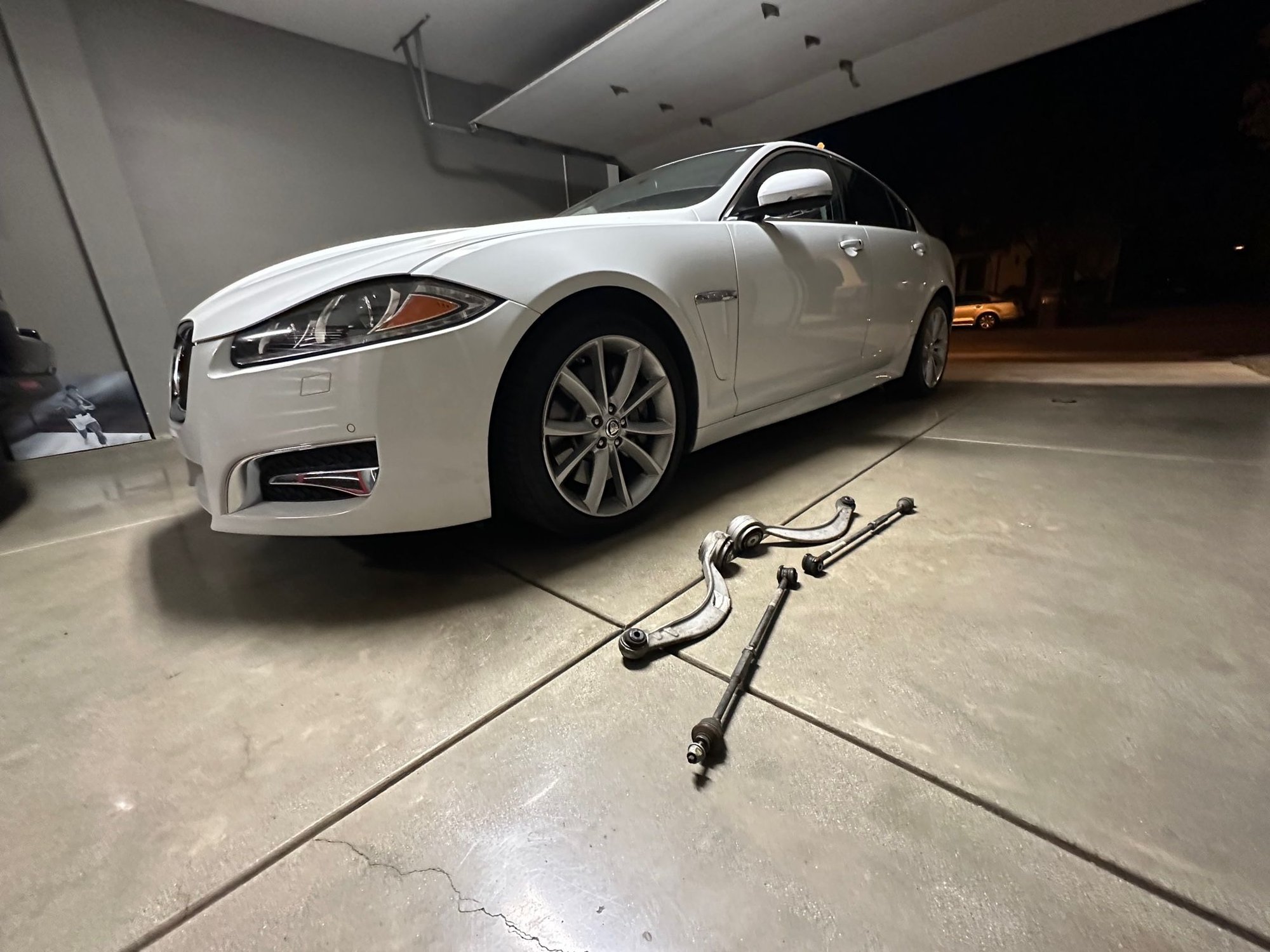

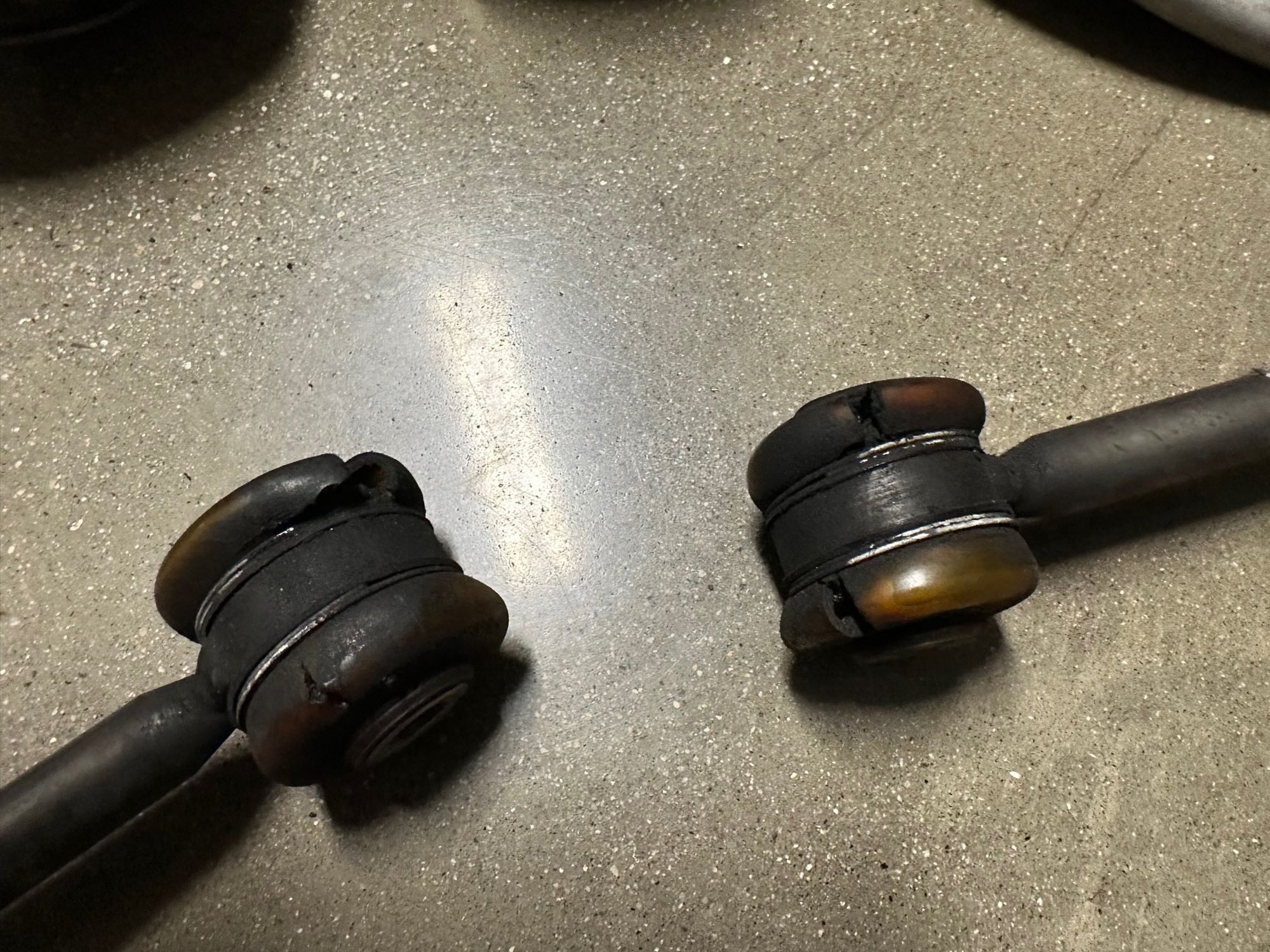

Didn't take too many photos as I was working late and in a rush to get done, this is more of a tips and tricks then full DIY.
2013 XF 3.0SC
I recommend ordering Lemforder for both the control arms and toe links, the front control arms had the Jaguar logo grounded off.
Use caution when transferring plastic aero deflectors from the old arms to new, use zip ties to secure as the latches break easily.
The front passenger side is a breeze, the driver side on vehicles equipped with 5.0/3.0 has a bolt from the plastic transmission cooler base that protrudes and prevents you from removing the eccentric bolt.
You have to remove a single fastener on the transmission cooler, then slide it towards the rear of the vehicle so the two rear tabs clear, then prop it up above the sway bar. You can then barely fit a 13mm deep socket into the plastic base and back out the bolt, you don't have to remove just back it out flush with the nut in the subframe.
Don't forget to mark the eccentric bolts on the front lower control arms to get it back somewhat close to where they were, you will need an alignment anyway. This adjustment is for caster.
The grey plastic inserts on the front lower control arm bushings can fall out and go in a specific direction, pay attention to this.
Make sure the eccentric washers and sitting in-between the slots on the subframe and not crushing them, I used a mirror and flashlight to verify through the hole in the subframe before torquing.

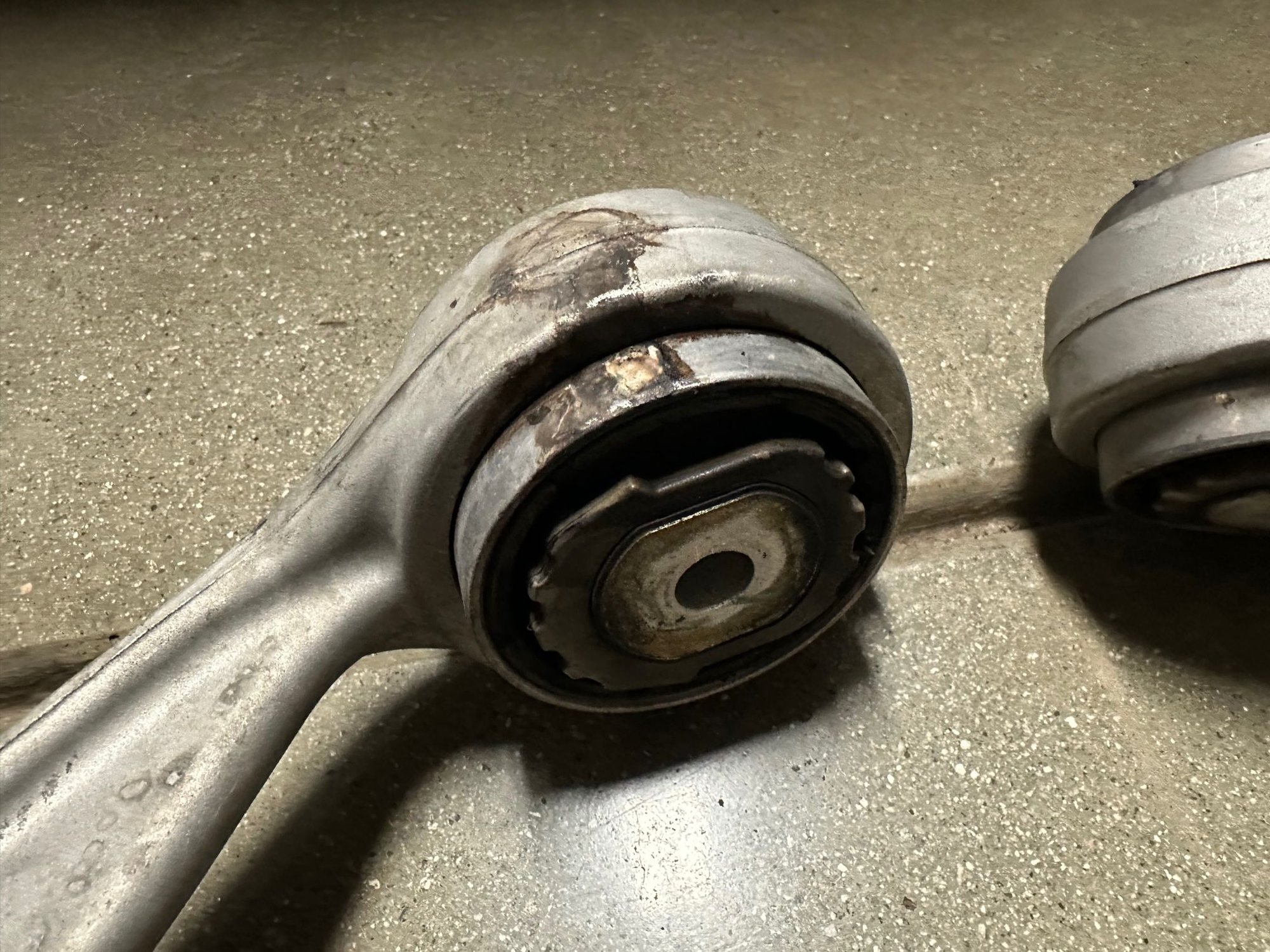

Typically on these cars the boots on the outer rear toe links fail, and the bushings on the front lower control arms tear and leak, look for oil stains underneath the bushings.

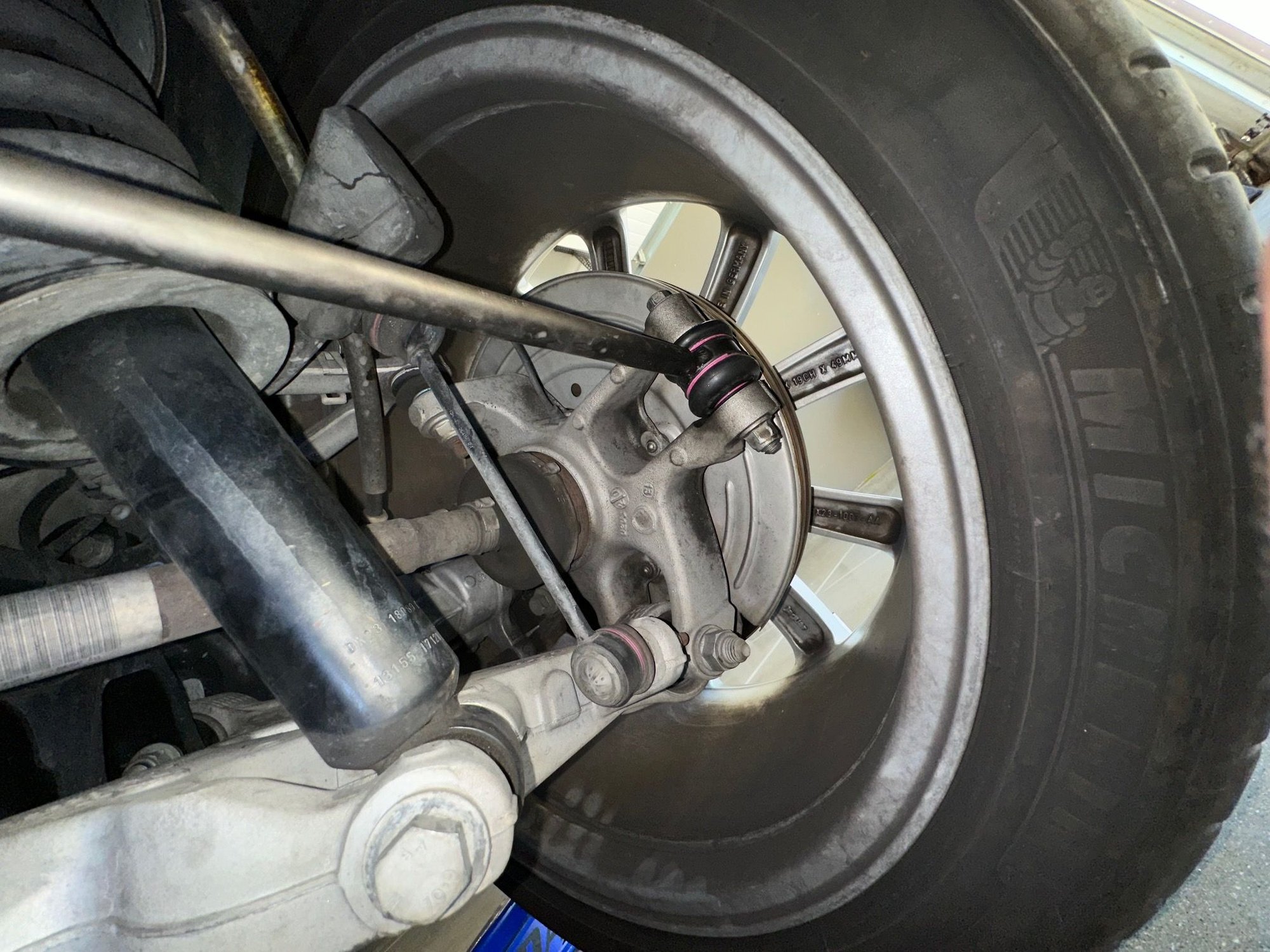

The rear toe links are very simple to replace, if you have a 18mm ratcheting wrench it goes much faster.

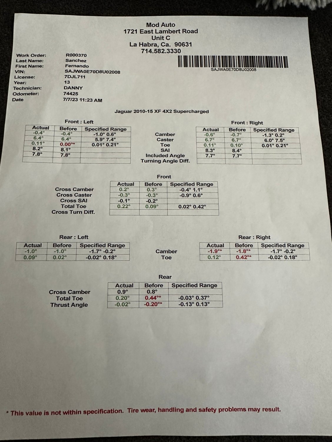

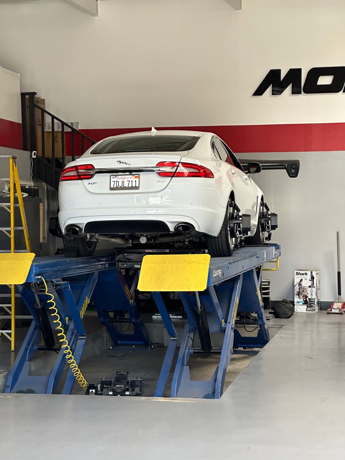

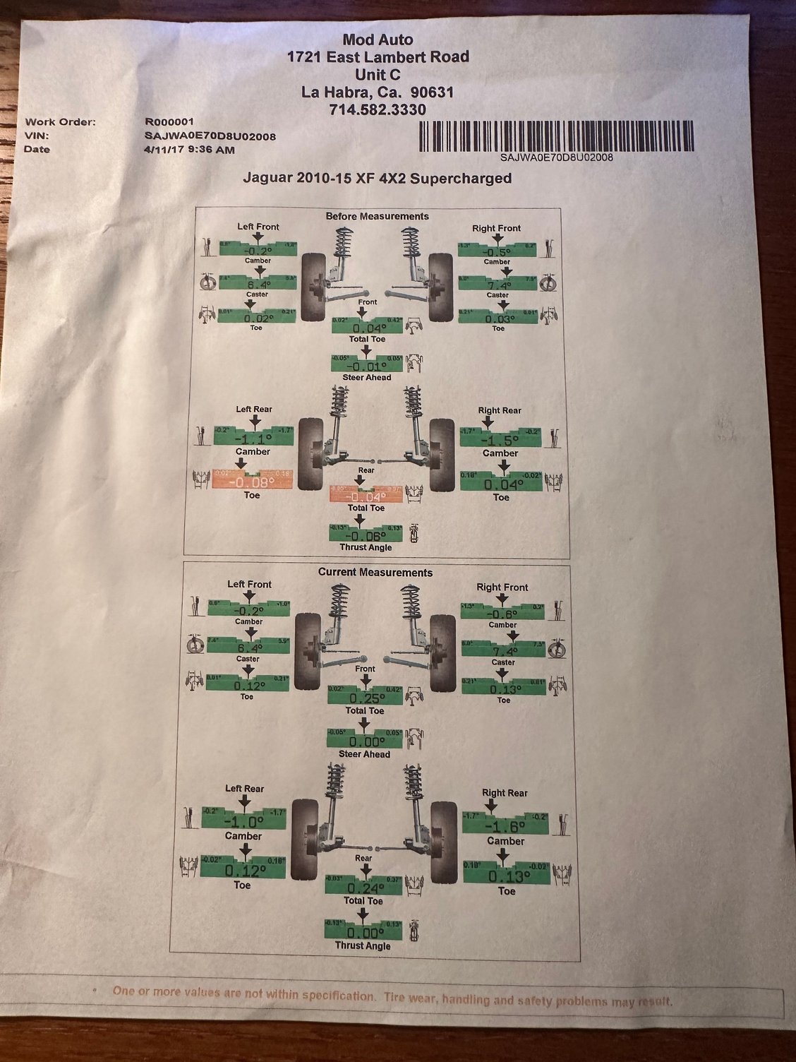

Had alignment done, having an issue with rear camber on passenger side. I wonder if it’s related to the rear subframe being lowered recently for service work.
Unfortunately there is no rear camber adjustment on these cars.

Found an alignment sheet from 2017 that the same shop did prior to the rear subframe being disturbed,
Looks like the driver rear camber was the same -1.0 degree and the passenger was -1.6 degrees.
I would think the subframe alignment would take from one side and give it to the other.
Going to give the rear control arms a good look at on the passenger side tomorrow.

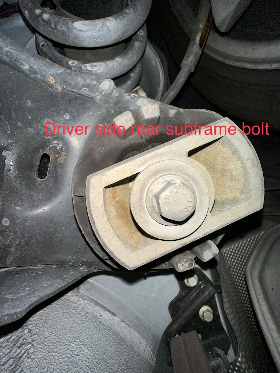

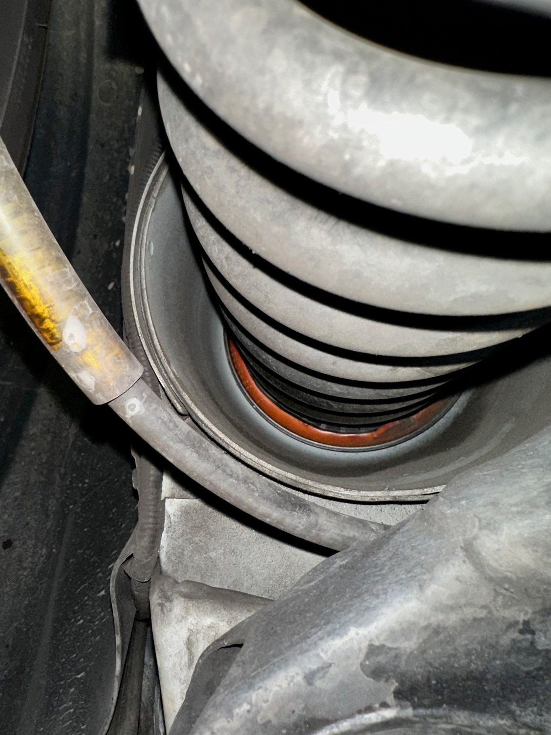

I inspected the rear end again, didn't find anything loose or degraded. The upper spring isolators look intact and not crumbling and the same side to side. I measured the ride height, its the same side to side.
I looked at the bolts on the subframe for the witness marks, the driver side is barely moved from factory, the passenger side maybe 3-4mm but looks primarily moved towards the engine and not side to side.
I will probably leave it alone and monitor for excessive inner tire wear.

Surprised the rear sway bar end links weren't tore up too? They seem to last about as long as the rear toe rods do.
But yours look good in the pictures.
