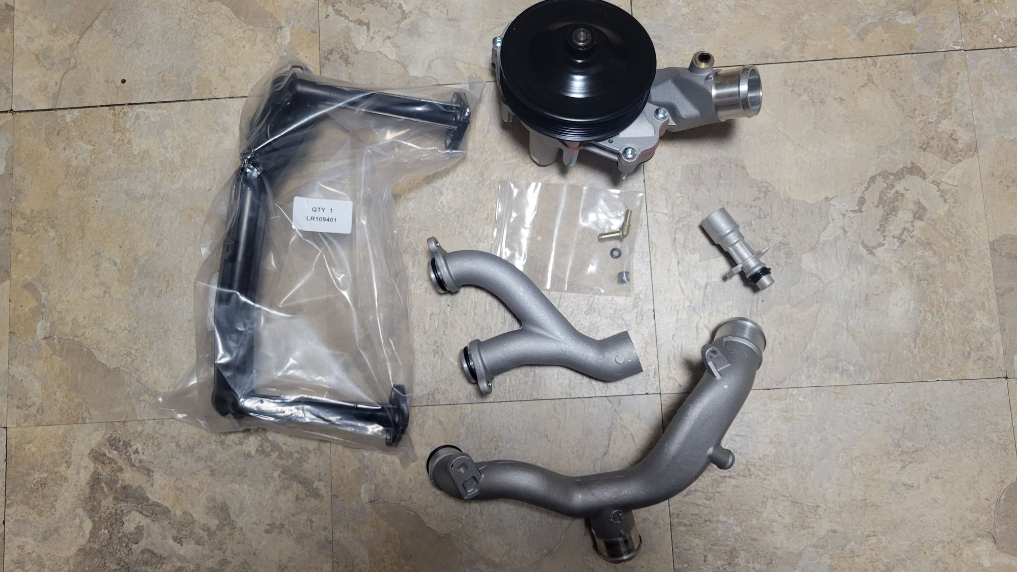

So I finished a F-type R ,cooling upgrade and it's been running perfect for a month now ,so I thought I would do my Xf and film it step by step incase any members want to try ,it's not to hard now I no the tricks to it', so I'll start filming it and posting it for you guys if your intrested,

Old Oct 25, 2022 | 07:52 PM

Hey Dennis, where did you pick the metal ones up?

Im putting a list together for you guys ,the F-typeR I did went well and a month later no issues, now I've done 2 cars its time for mine ,it going to be a lot easier every time

Waterpump
Amazon Amazon
Waterpump pipe
https://www.autohausaz.com/pn/129865...4aApAxEALw_wcB
Rear coolant water heater pipe
https://www.ebay.com/itm/225167528013
Coolant pipes metal
https://www.ebay.com/itm/185549499046

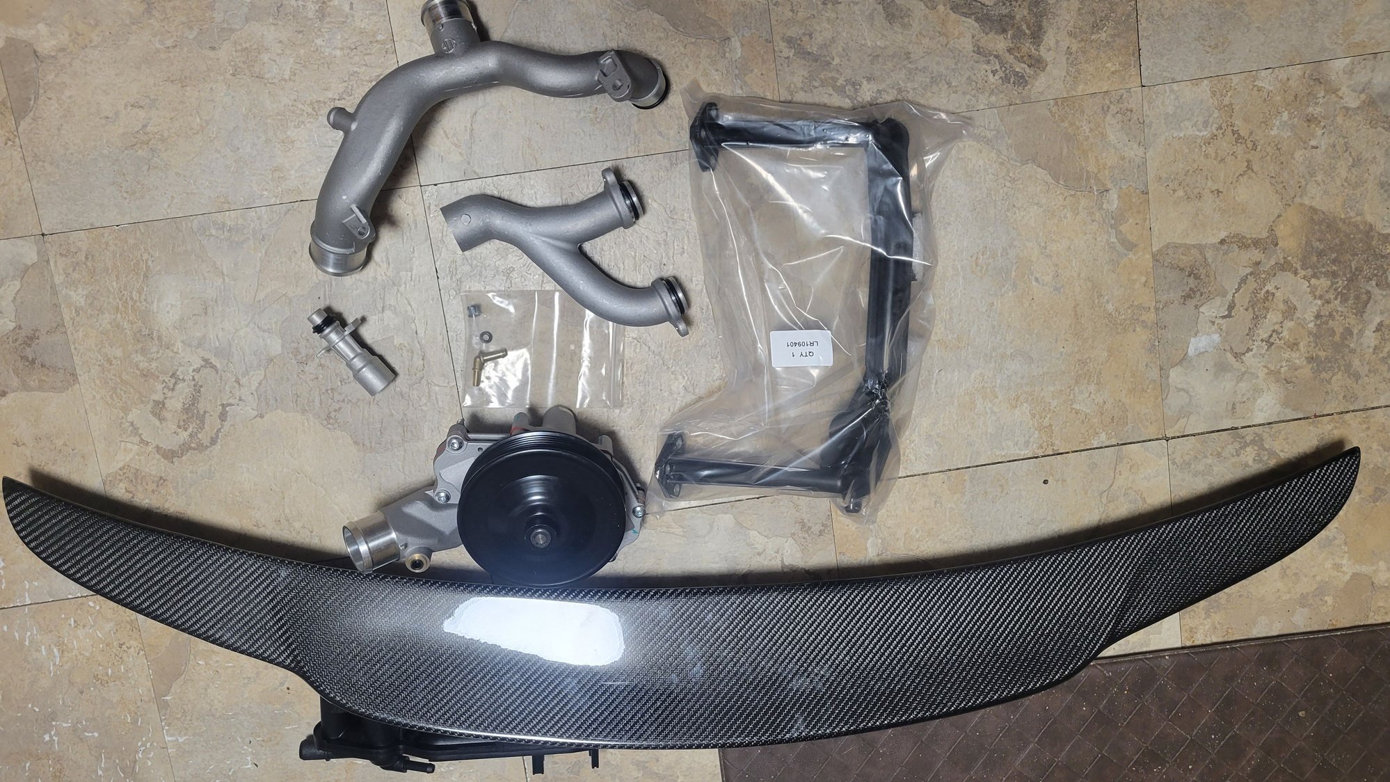

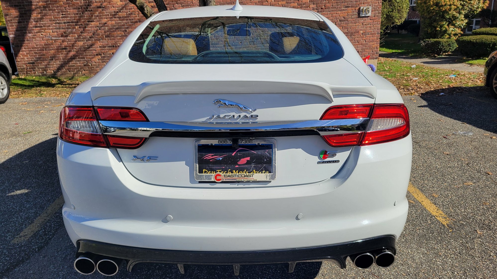

rear trunk spoiler getting painted white did a test fit

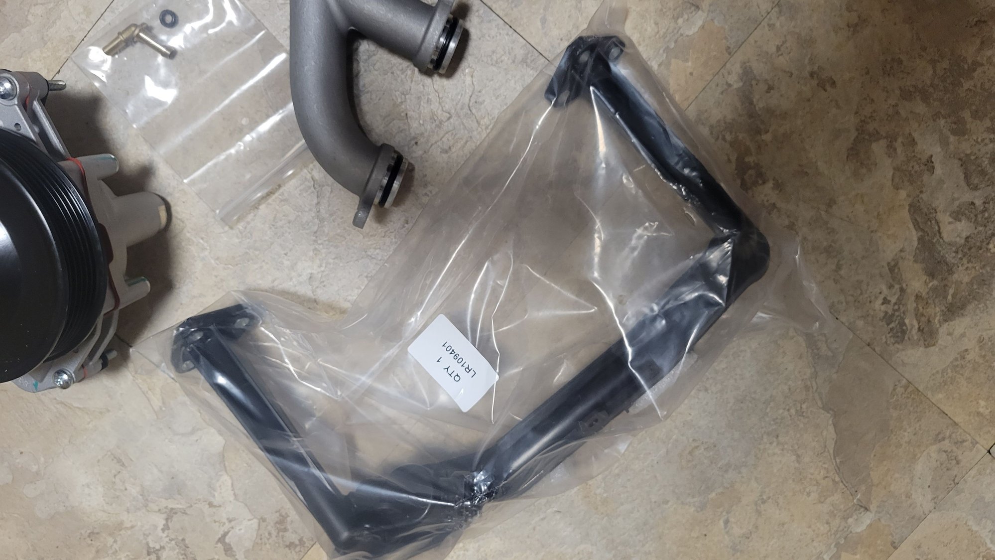

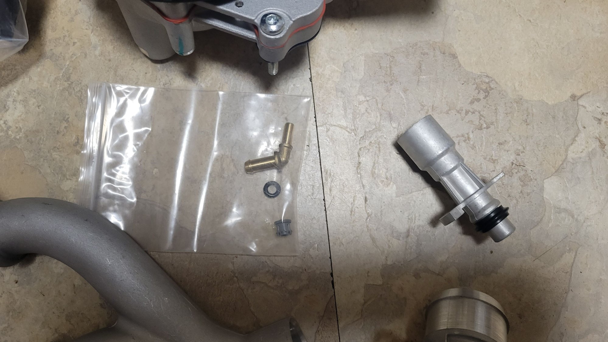

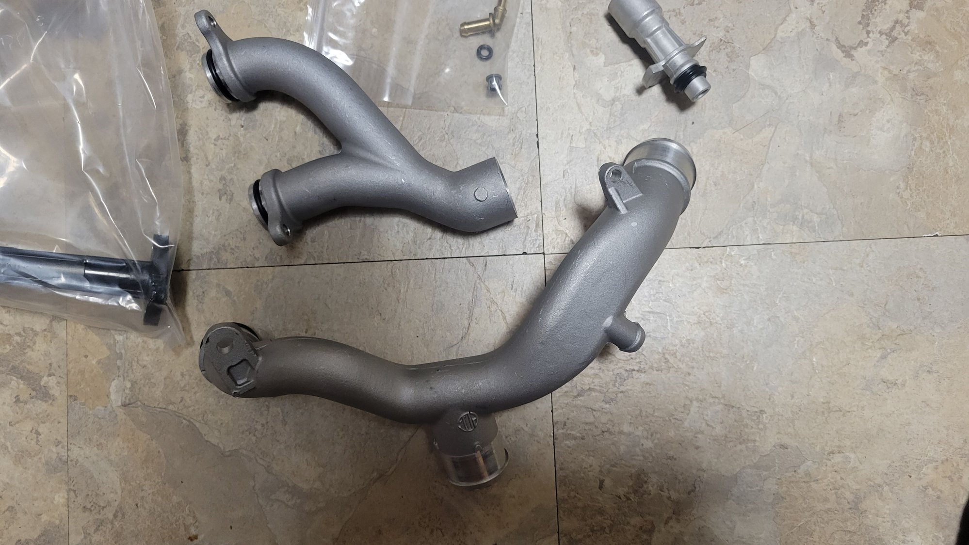

Here's one the pipes were replacing ,mines fine its the updated plastic ,but i don't trust it and its a easy job to replace it with metal ones ,im putting the videos together

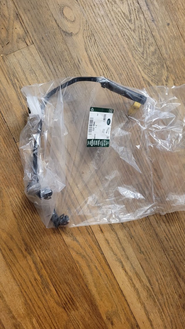

Another breakable part came today, only $37 dollars at JAGUAR you must get this part for the expansion tank
reservoir hose that breaks in time
part number
