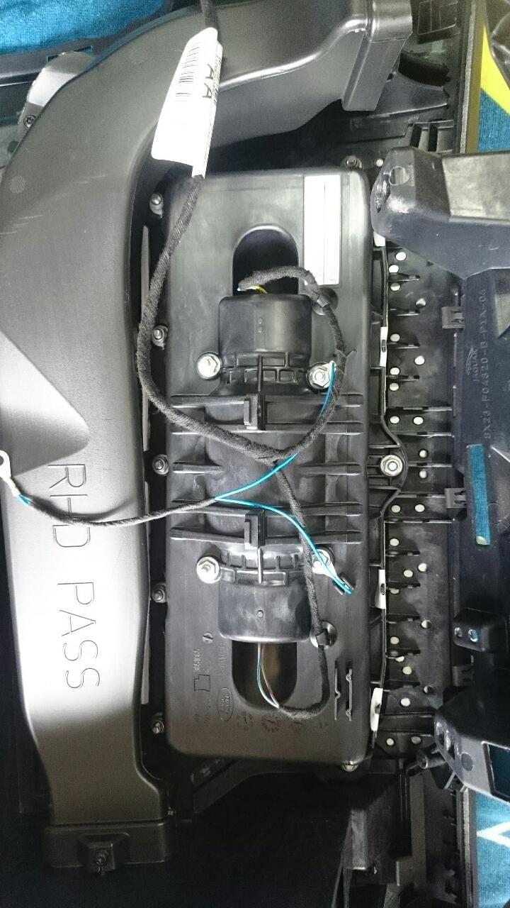

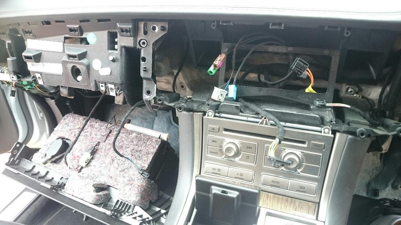

Here is a photo from when I changed my dash pad. Once the glovebox module is out, the airbag can be accessed with the dash in the vehicle.
The airbag module. Held in place by 8 studs, washers and nuts.
