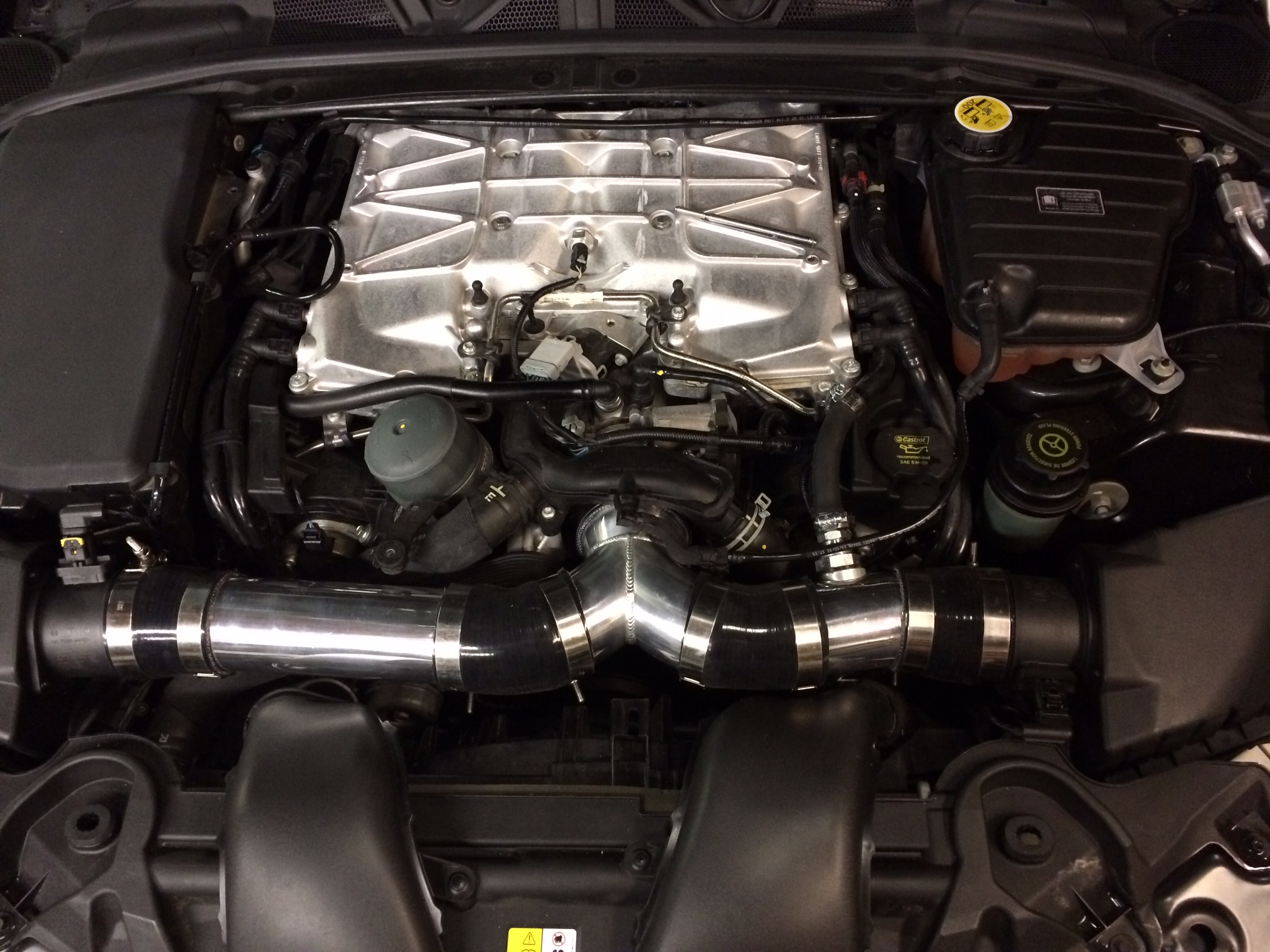

I have played around with making lower boxes that are open because I want to keep the stock boxes encase I want to go back to stock or during the hot 3 months we have here.
Here is what I came up with.
Still uses the factory cold air piping and the new aluminum end acts as a heat sheild.
Even with the stock paper elements, the blower screams...

Work well with my custom intake piping I made last year.

I bet this added lots of blower sound as well? This is what I need done!
