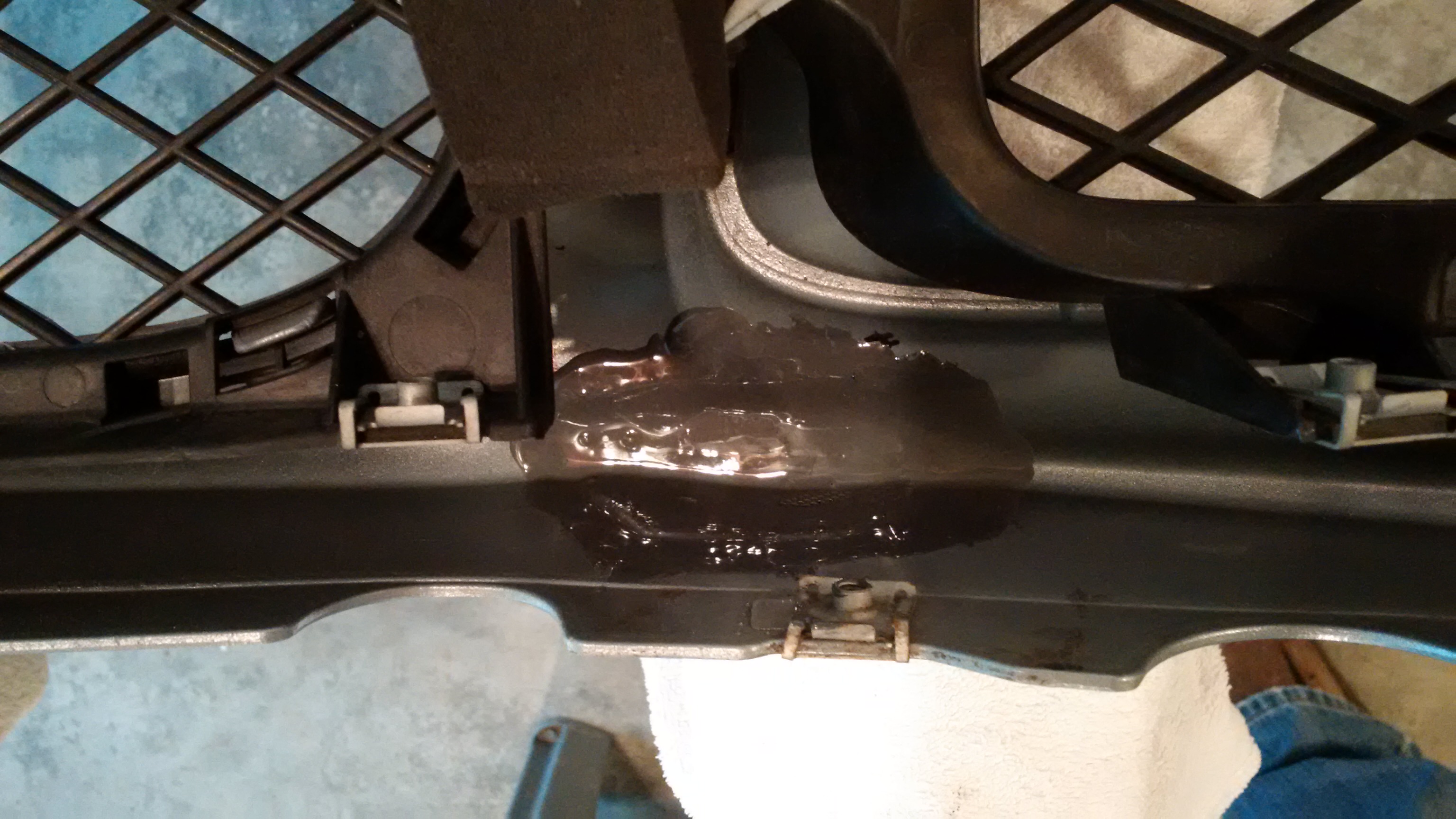

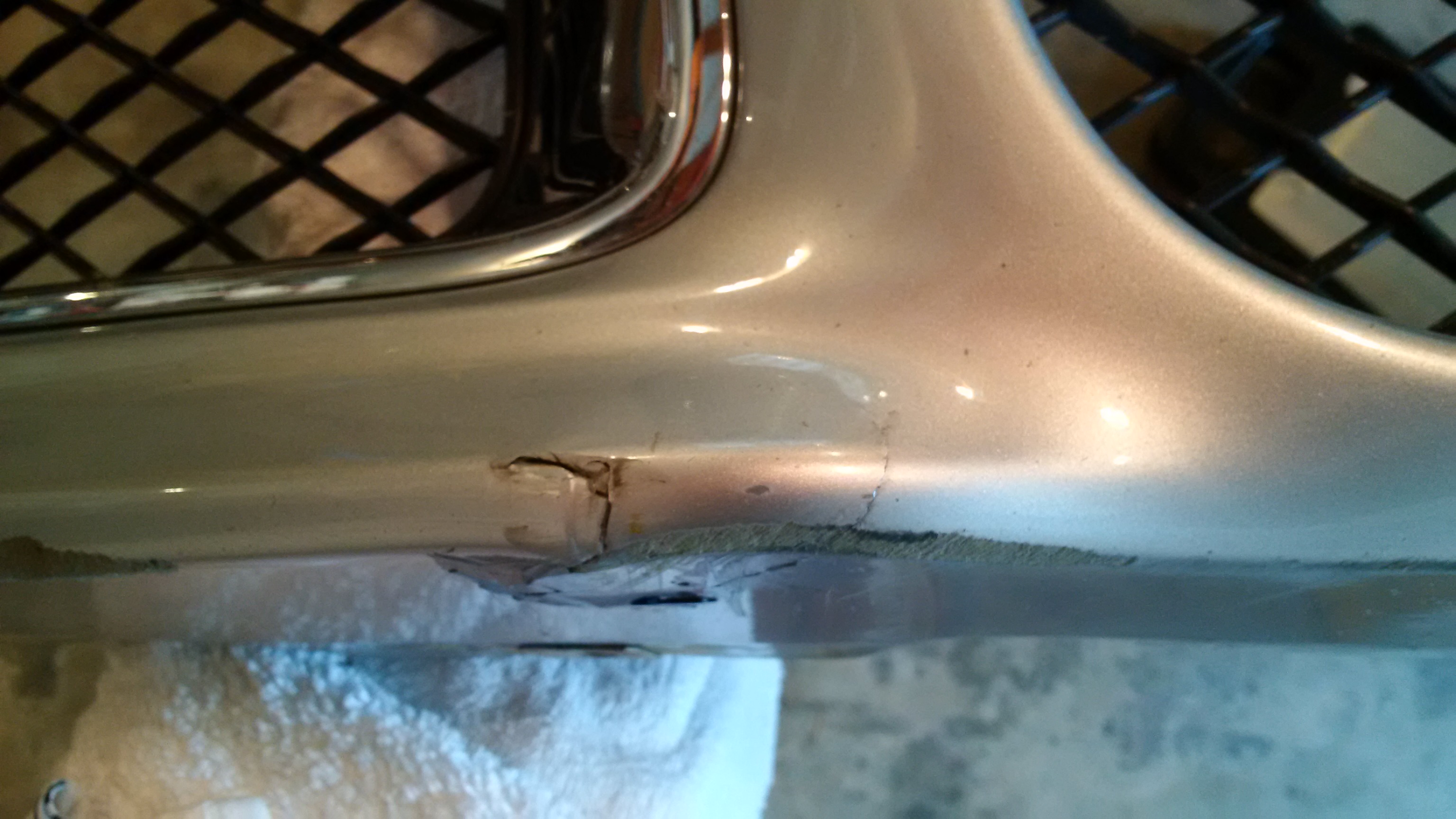

Hi all, my wife drove up on a parking curb and caught a bit of rebar sticking up. It ripped a nice hole in the bumper lip about 2"x2". It was an easy but long and boring removal due to all the little screws. Only had to unplug the fwd sensors to remove it.
I repaired it with some metal screen and JB Weld epoxy. I've still got some touch up to do once the cure is done. It won't be perfect but will be fine and strong and mostly unseen.
What surprised me was the blocked left intake. WTF? You would think that you have value of air coming in and it could be used rather than acting like a air brake. Flow would be better. Anyone know why they wouldn't use this flow? Why not just leave it open to vent toward the wheel, cool brakes, push out dust, something....
I'm tempted to remove the blocking cup panel. Maybe duct the flow somewhere in there? Anyone played with this or modded it?
Also, what is this oval black plastic thing? It snaps into the bottom slpash guard on each side. Sensor of some sort?

Old Jul 11, 2015 | 10:18 AM
boiler's Avatar
Joined: Oct 2014
Posts: 305
Likes: 49
From: Houston
The sensor is for the tire pressure system, the blocked vent was due to a change in design. I believe the earlier cars used the right side for the oil cooler and the left was for something else, after a redesign the left side was no longer needed. I have not read about anyone using it for another purpose.

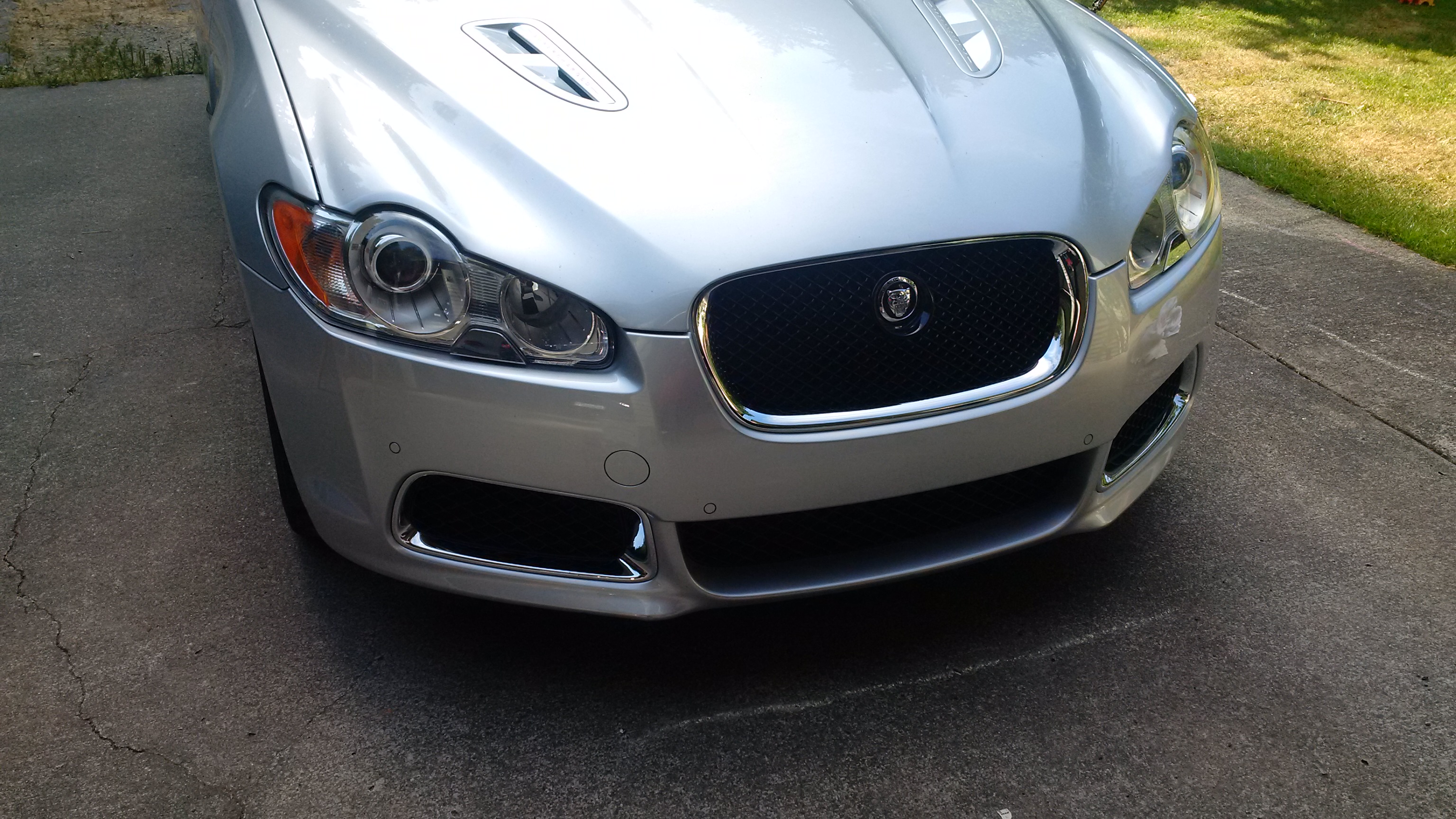

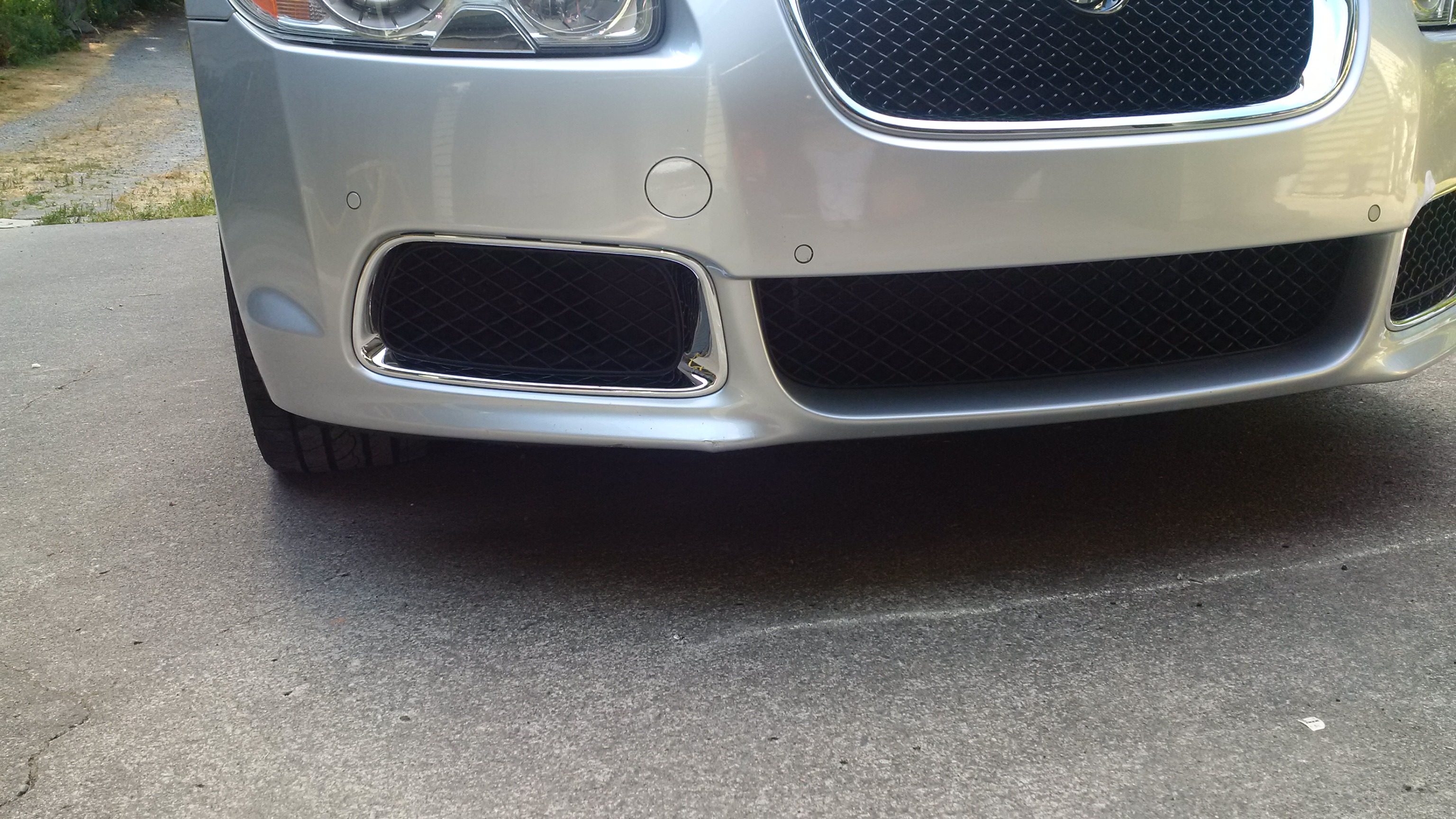

Well, all done and it went together easily. Lots of little bolts/screws though. I tried the rustoleum brand of spray-on clear bra. BAD product. Hazy and rough. I peeled it all off. That product test cost me about 3 hours. Good idea. Bad product. I wonder if the 3M one is really any better.
Damage is barely visible now. Certainly better than replacing the bumper cover.
