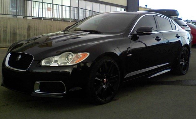

Whats going on everyone. This is my first post, I'll just let you guys know up front I love cars but I'm no professional so any help is appreciated.
I used to own a Mustang GT, I upgraded to a Jaguar XFR. I bought it about four months ago and I love it. Although I love the car, I want to get more out of it. So I came to the experts to see what I could do.
So far I got a Eurocharged Stage 1 Tune and Pulley upgrade. I also am having the Spires Performance Exhaust installed tomorrow. I was told these two things combined should put me into the 600bhp range.
The question I have for you guys is what else can I do to increase the power in this car without destroying the engine. I'm also have wider tires and rims put on the back and possibly having it lowered 1/2 inch or so.
