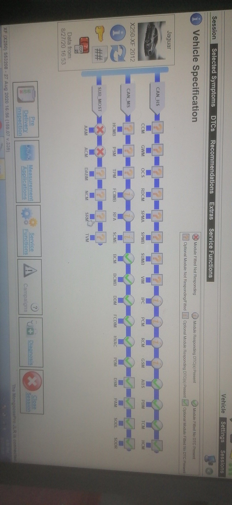

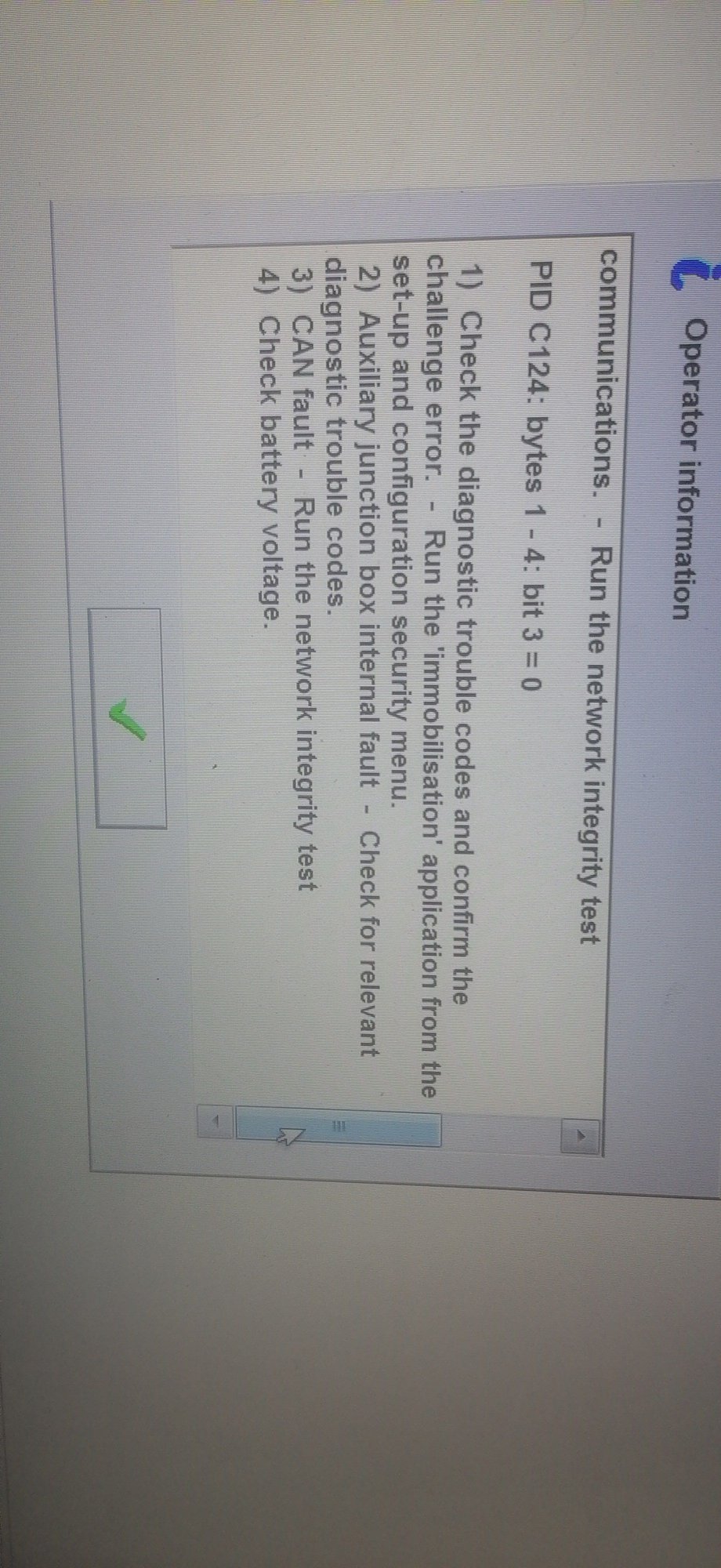

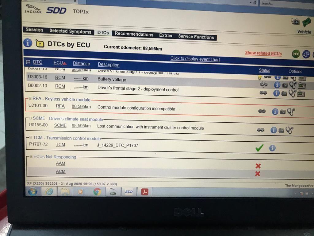

Connect good, fully charged battery & use SDD to list all faults.
Old Sep 1, 2020 | 03:11 AM
Ha Al's Avatar
Joined: Aug 2020
Posts: 8
Done
This is the dtc

On an old simple car it might be just a fuse. On these euro luxury imports, it may be the kiss of death. If a decent tech investigated and says those parts need to be replaced, then that's as good a guess as any would have here. Combined with the programming expertise required to attempt replacements, nobody would be surprised if it cost more than the car is worth and might not even be guaranteed to fix the problem.

Just to update if anyone is searching for similar problem..
We have replaced the BCM near the passenger seat with a used BCM and reprogrammed the car.. It started working and I am testing it since yesterday..
Advises..be careful when you jump start the car...
