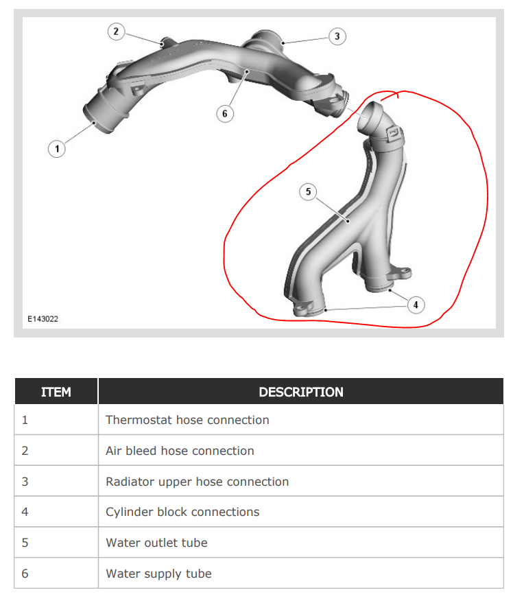

I have a coolant leak from the plastic engine coolant outlet tube. Specifically from the welded seams on the plastic. The part numbers are water supply tube 9w83-8a504-db and water outlet tube 9W83-8A520-DA but it looks like there are updated parts that are now seamless which would have eliminated the issues I'm having. The water supply tube is easy to replace as it sits on top of the engine. Some people call this the coolant crossover tube. I'm more concerned with the water outlet tube 9W83-8A520-DA circled in red below. I'm not sure if this can be replaced without removing the supercharger to get to the bolts. Does anyone have experience with this? I have a 2013 XF 3.0 supercharged but it's the same setup for the 5.0 supercharged.

IIRC the supercharger needs to come out to access that circled pipe. And if the supercharger has to come out, you might as well do the full upgrade/replacement.
This package has everything you need to upgrade the cooling system, including new seamless pipes in aluminum. The same seller also offers a slightly less expensive package with those pipes in seamless plastic.

Definitely looks like the supercharger needs to come out. Found this great video that walks you through it. Doesn't look as bad as I thought it would be. Going to order the parts and try it myself. Thanks for the feedback!

Yep, the SC has to come off.
Lots of talk and posts about these replacement coolant system parts over on the F-Type sub forum, and good feedback on the Euro Amp kit/parts.
As the SC needs to come off there is some more work you should do "while you are in there", namely replace the SC coupler/torsion isolator and SC fluid.
