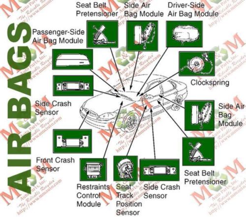

I found this chart, so were thinking the problem lies with one of these units?...like the restrains control module or possibly the seat belt pretensioner? (i chose those sense we've got the strange seat belt dinging....)
Attached Thumbnails please help with dash air bag light for title certification!-%24_12.jpg
Old Jul 7, 2014 | 08:54 PM
sparkenzap's Avatar
Joined: Nov 2007
Posts: 4,502
Likes: 1,068
From: atlanta ga
Its all a guess without analysis. I would GUESS that if it was something easy the hacks who put the car together would have fixed it, but you never know, I suppose.
