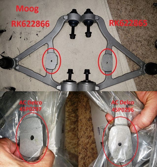

Just a heads-up to anyone ordering rear upper control arms (Jaguar C2Z31678 & C2Z31679) from RockAuto (and probably other sites)… the Moog R-Series rear upper control arms (RK622865 & RK622866), which is supposedly Moog's "Economy" line, even though it's listed in RockAuto's "Daily Driver" category, and the AC Delco Professional rear upper control arms (45P0296 & 45P0297), which is supposedly AC Delco's OE parts line (now called "Gold" instead of "Professional"), are the EXACT the same parts (at least when ordered from RockAuto). This probably isn't a shocker to a lot of you, but it was to me. Here's my story...

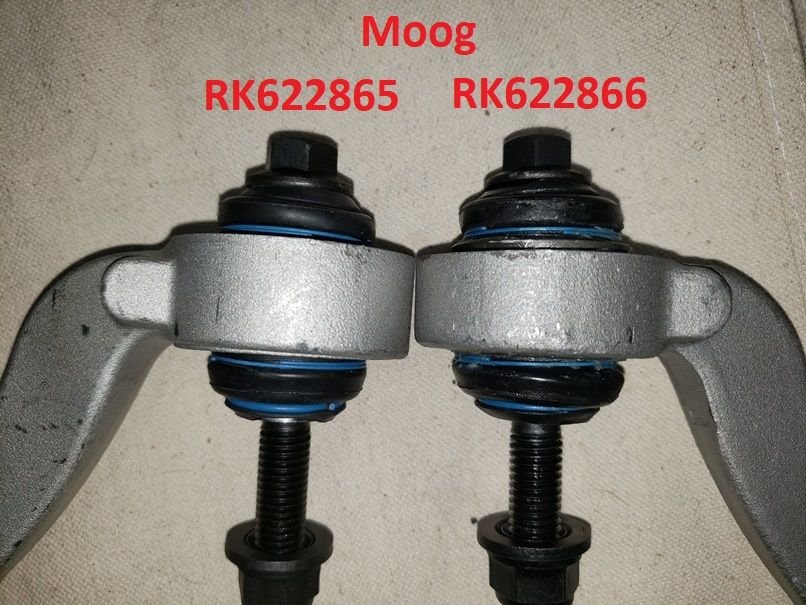

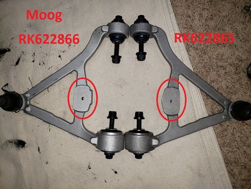

Anyway, onto the rear upper control arms... I bought the Moogs (RK622865 & RK622866) from RockAuto, as they seemed like decent options. However, when I received them, I noticed that they didn't look great and were completely different from each other, including some different dimensions, which was very frustrating. I googled the Moog part numbers and found that the control arms I'd ordered were supposedly Moog's Economy line, as indicated by the "R" at the beginning of the part number, indicating "R-Series." If I'd known that, I wouldn't have ordered them, but as they were listed on RockAuto's "Daily Driver" listings for parts, rather than their "Economy" listings, I had no idea. RockAuto has absolutely zero customer service options (no phone, web chat, email, etc.), so I couldn't ask anyone about the issue, and just decided to send them back and order the parts from a different manufacturer on RockAuto. I settled on the AC Delco options (45P0296 & 45P0297), which were also listed in RockAuto's "Daily Driver" section, as I read that their "Professional" line were OE options. I'd literally dropped the Moog parts off for return shipment (for which I paid) and got home to find the AC Delco replacements (which I also paid to have shipped), and when I opened the boxes up, I noticed that they were identical to the Moog parts I'd just returned in every single way, including the bags they were in and the stickers of the part numbers on said bags. The left and right AC Delco parts were also different from each other in the exact same ways as the Moogs (color, dimensions, unique structural specifics, etc.). Luckily, I'd taken pictures of the original Moog parts for documentation, and pulled the pix up to make sure I wasn't going crazy. Thankfully, my sanity was confirmed (ish); the AC Delcos were identical to the Moog parts I'd just returned.

Here're some of the dimensional differences between the same brand's Right & Left versions (which were repeated in the AC Delco versions):
Here're some of the differing unique identifiers between the same brand's Right & Left versions (which were repeated in the AC Delco versions):
AC Moogco:

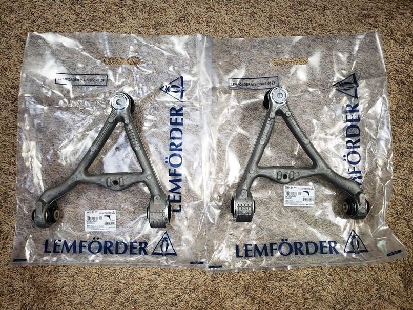

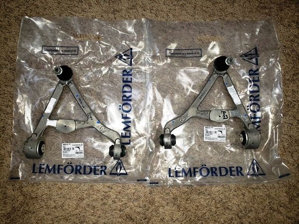

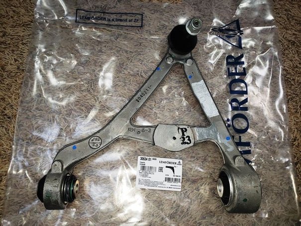

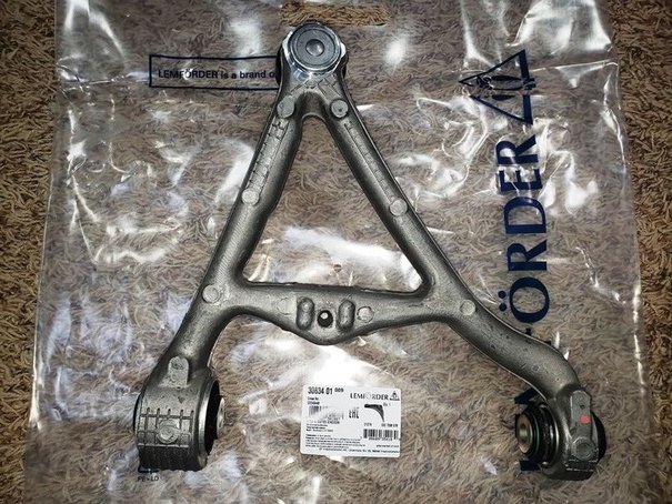

I actually sent the AC Delco versions back to RockAuto, in addition to previously sending the Moog versions back to them, and bought the Lemforder control arms from FCP Euro. As expected, the Lemforder versions are identical in every way to the OEM Jaguar branded control arms, except they've ground off the word Jaguar and the interchange number. Unfortunately, the Lemforder versions cost more and didn't come with the two sets of bushing bolts and nuts per control arm, like the AC Delco and Moog versions did. Bolts are cheap, though.
