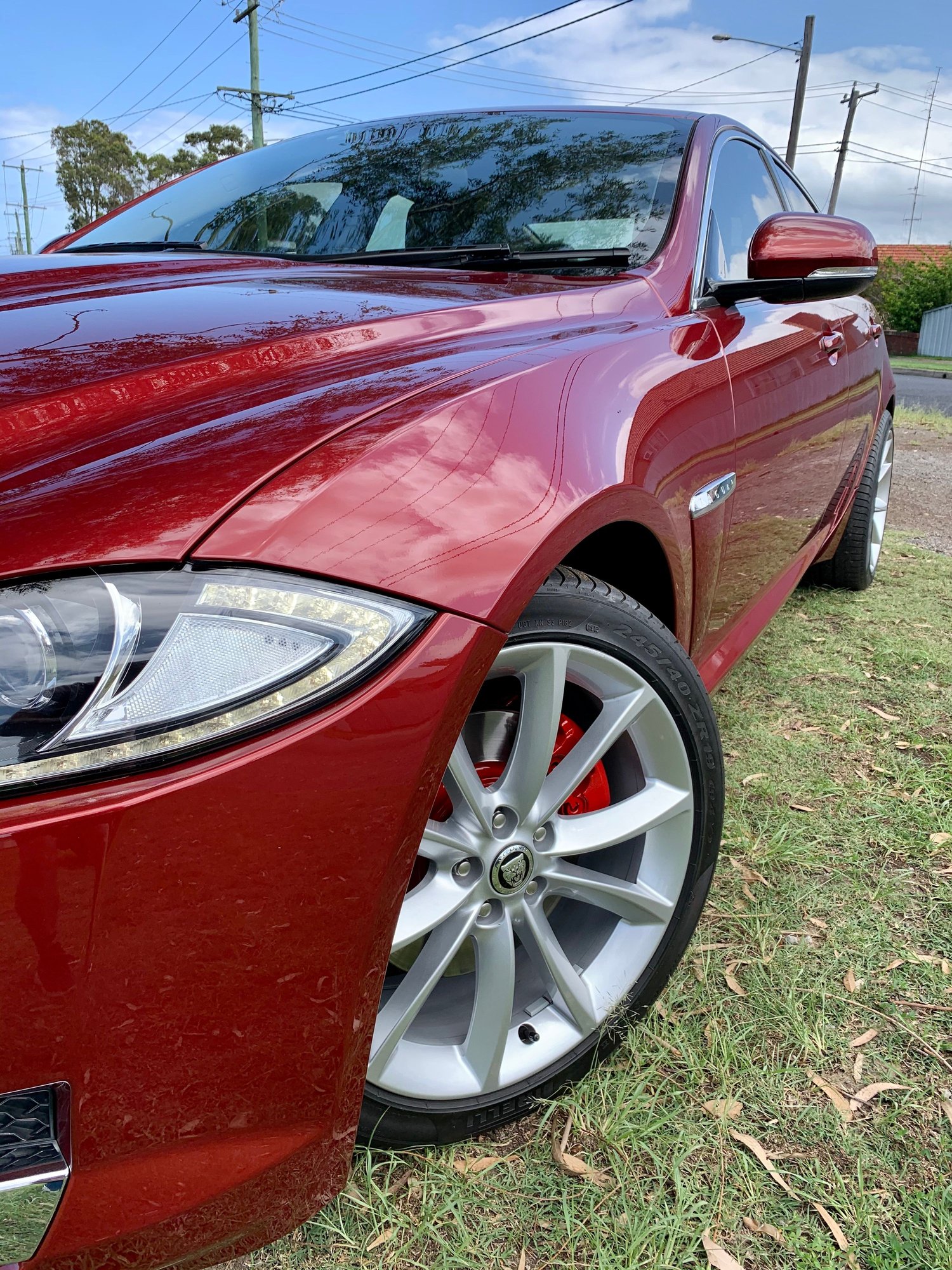

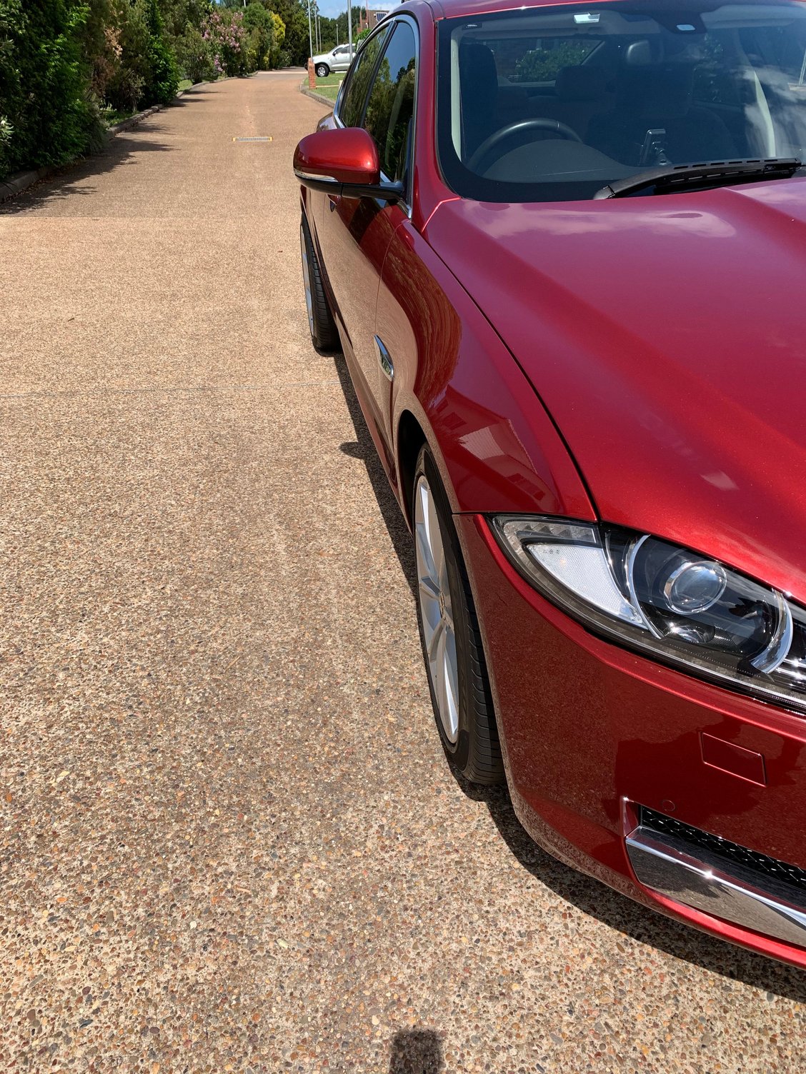

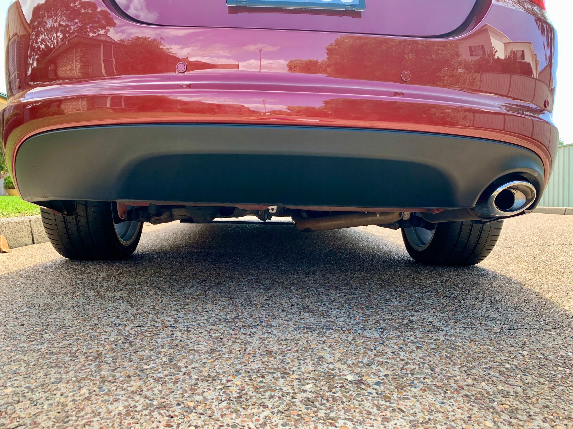

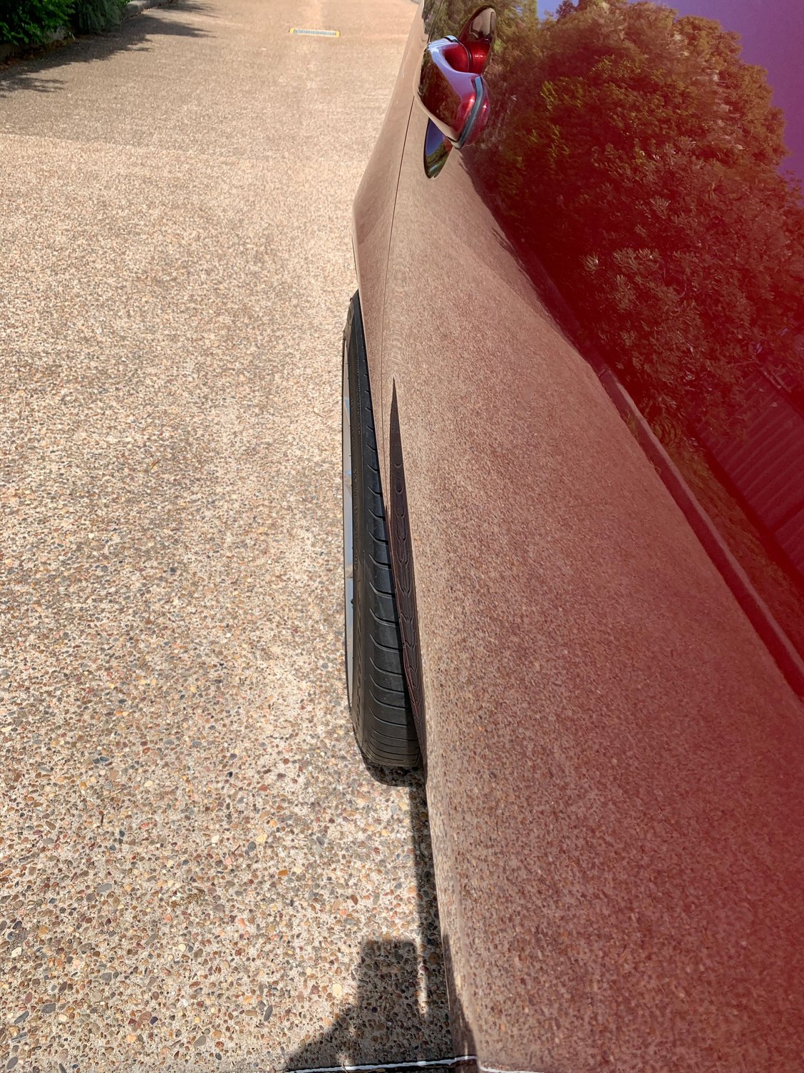

I have an XF 2013 2.2 and just put a set of Staggered F Type wheels on the front were 19x 8.5 with 245/40 x 19 tyres and the offset was 49 the rears are 19x9.5 with 275/35 x19 tyres and the wheels are a 27 offset they do stick out slightly on the rea but no way in such a way that they will rub unless I had worn shocks, which I don't. I could and may use a smaller tyre that will fix the wider tyre, but to be honest, the top of the guards on the rears are in line with the tyres, See the photos below. and cheers.
