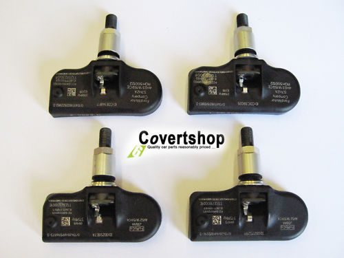

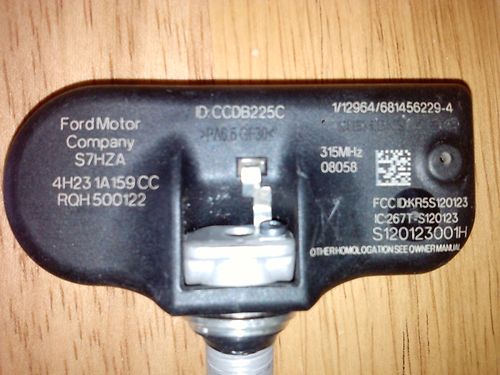

So is there any difference between the 4 pictures below and will they all work? They all look like the pictures of the TPMS I have seen in the past but don't want to purchase before I know 100%. Is there an online store that sells genuine parts so I could compare or check prices. Thanks again!

You want the upgraded shoulder version, top left picture. The top right picture shows the older superseded model which caused leakage and breakage problems for Jaguar. I can't see if the lower two pictures have the taller shoulder you need. OEM quality are dark anodized preventing corrosion issues and with that taller shoulder protecting the threads from sideways stress. Anything less is likely to cause you problems.

Yes, on the updated TPMS the lower threads of the stem are supported by a taller smooth shoulder giving more bending resistance. These stems are made from aluminum unlike older stems made from nickel plated brass.

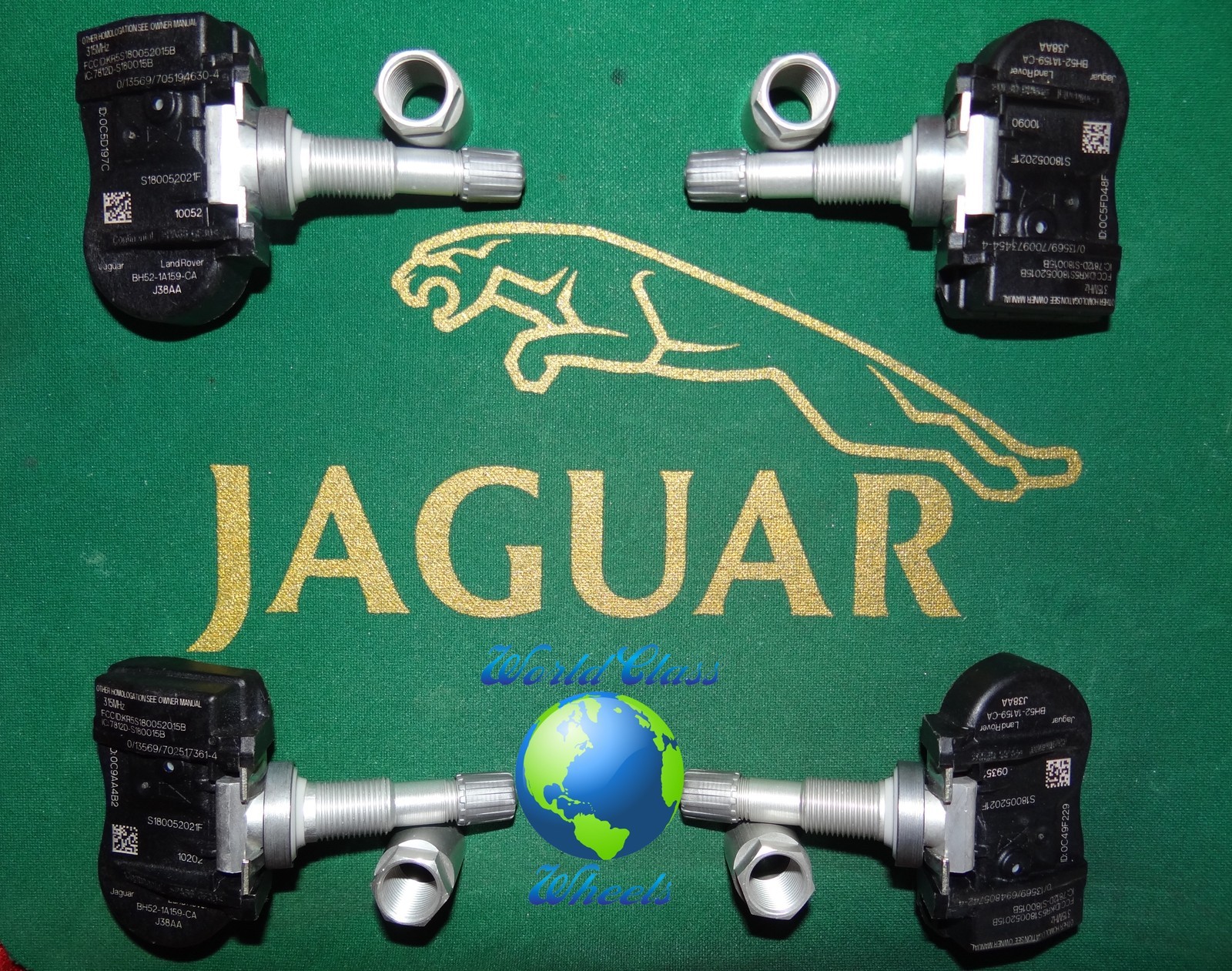

I just purchased some Jag OEM rims for my XJL SS from a seller in Europe that I intend to use for winter rubber, and the vendor included four brand new TPMS monitors with them at no charge that are identical to the left-most picture as you note. Nice to have this confirmed.
