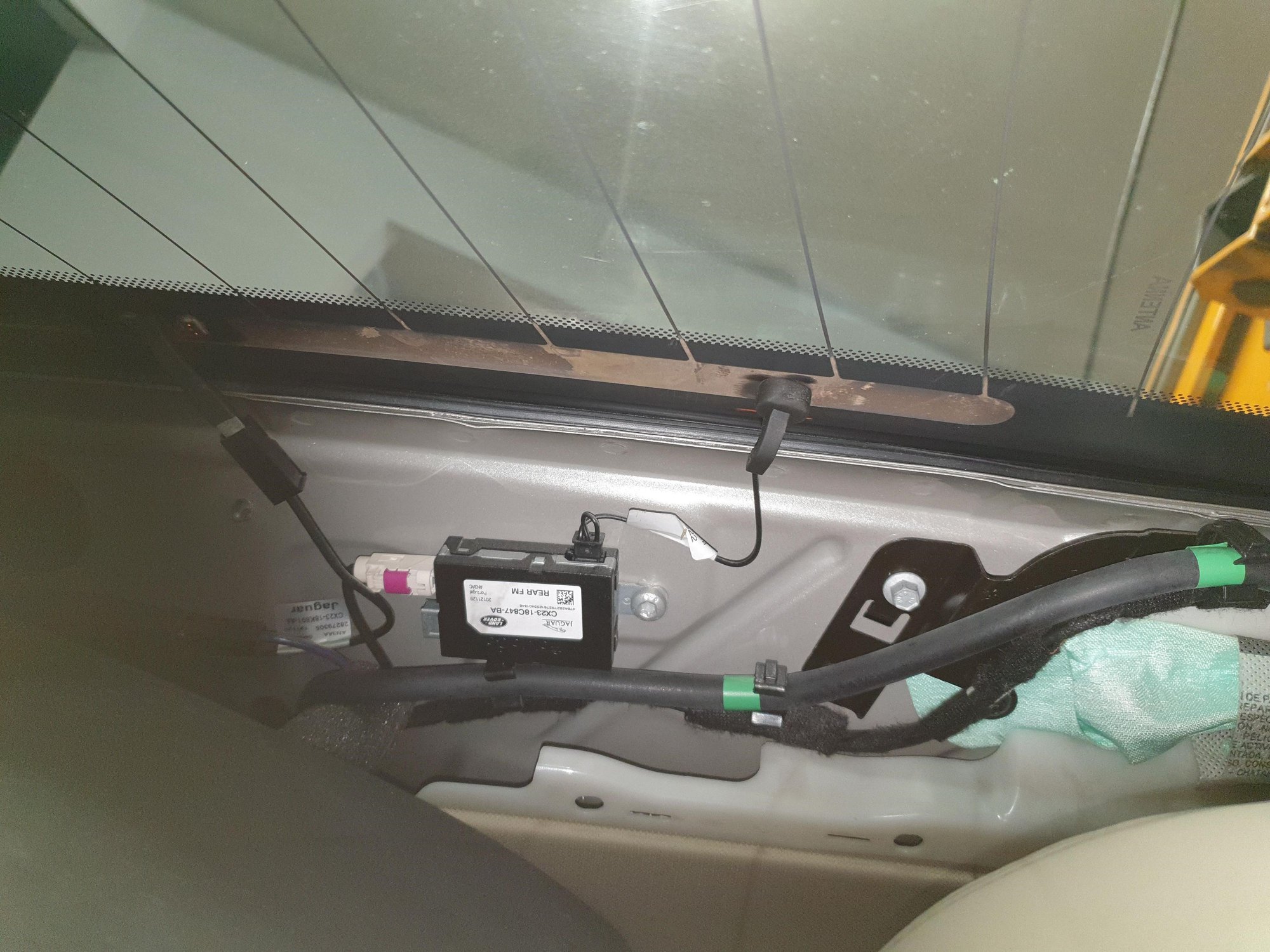

Thats how it looks under my C-Pillar:

The window has Band-III, the roof sharkfin has L-Band. I tried to use one of the factory L-Band sharkfins for Band-III reception and it was terrible...
You need CX23-18C847-CA for the rear window which is a combined FM & DAB, with a 2nd fakra connector for the DAB.
As you have a 2013, there is no pre-wiring in the car for DAB, which makes it a pain to retrofit.
For these cars I had a bracket made to put the DAB module on top of the audio amplifier in the boot, because the MOST fibre connection under the left front seat is missing if it wasn't built with DAB or SDARS. At least in the boot you can get the MOST & power connections easily, and the DAB antenna cable to the rear window is simple. Costs more but saves a heap of time & effort.
