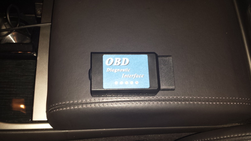

BAFX Products (TM) - PIC18F2480 Bluetooth OBD2 scan tool - For check engine light and other diagnostics - Android compatible : Amazon.com : Automotive BAFX Products (TM) - PIC18F2480 Bluetooth OBD2 scan tool - For check engine light and other diagnostics - Android compatible : Amazon.com : Automotive
Here is what it looks like:
Installation is as easy as it gets. Plug it into the OBDII port underneath the steering wheel. It did not get in the way of my leg at all while in driving position...it might get in the way while getting in and out of the car but it's not a huge device.

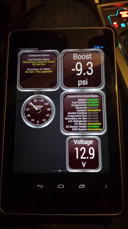

Next step is to download the Torque app (for free, paid version is like $5.00) onto your devices. I found it in the Android store, I am honestly not sure if a version is available for Apple. I am assuming it is. Connect to the Bluetooth adapter, start up the program and boom!
On my Nexus 7:
A screenshot from my Galaxy S4:
So far everything seems to work really really well. The Torque app itself is incredible, you can do everything from reading and clearing codes to record video track sessions, 0-60 readings, horsepower estimations, etc. on the paid version. The best part is that the interface is completely customizable. The setup I have on those pics was put together pretty quickly just so I could test to see if it works. I am going to buy the paid version tonight because it adds some nice functionality and some nicer skins to the guages. Here is a link to their homepage: Torque — OBD2 Performance and Diagnostics for your Vehicle

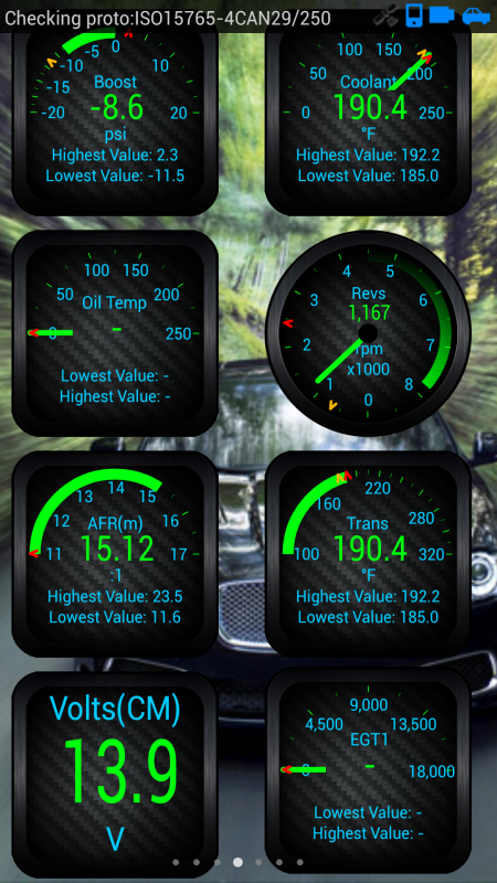

Here is my current setup with the pro version and one of the carbon skins. It's definitely a work in progress but I'm trying to get a feel for which data points this car can display. So far it looks like oil temp and EGT do not work. Have also not had s chance to test the accuracy of the hp/tq or 0-60 readings but I set them up on their own page:
I love how you can customize the background (mine is a front shot of an xfr) but it will take some playing around with to get it properly centered.
