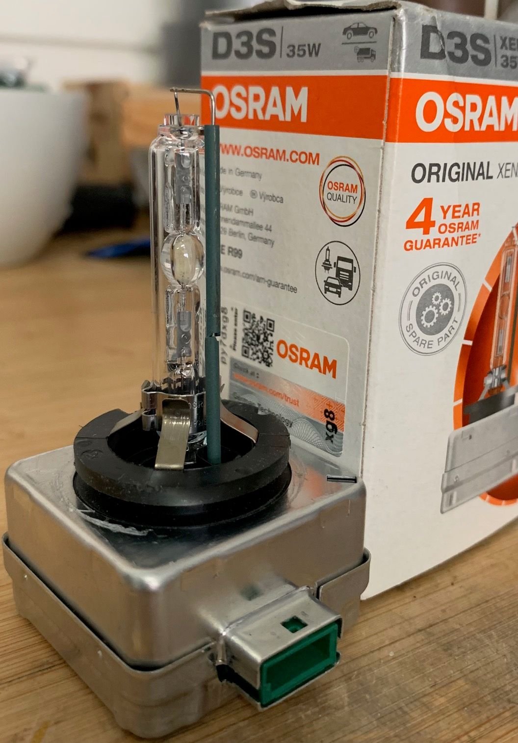

So, reverse course and go through the removal process again. When I got the bulb out, I noticed damage to the element that is outside the bulb, looked like insulation that got cracked. See picture. Do not know if that is a manufacturing defect, shipping damage, or happened when I tried to fit it back in. Lesson learned, be REALLY careful threading these things into place!
