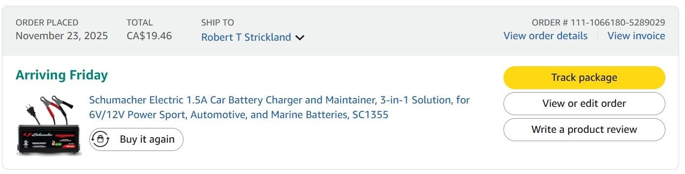

Hi, I'll have to report back next weekend.
I only want to leave it idle one night for feedback, then I need this on it battery maintainer
. (Item model, is suggested from other posts on this forum - Thanks again )
