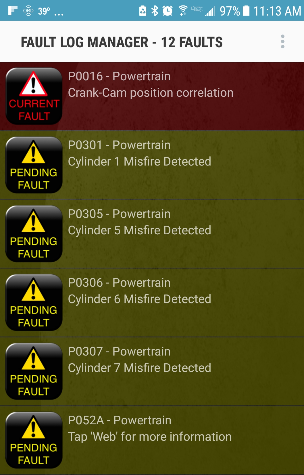

I have a 2011 XF 5.0 S/C left me stranded last night. I thought it was going to be a bad coil but when I ran the scanner found misfire on both banks. Here are my codes:
P0016
P0017
P0301
P0302
P0303
P0304
P0305
P0403 - EGR
P0503 - vehicle speed sensor (VSS)
Symptoms are rough idle and when I press the gas I get no action. I suspect the EGR. Anyone out there that could help out. Thanks!

The new battery didn't fix the issue. I'm going to take it to a mechanic this Wednesday but see attached errors. Car start good but then it stalls with a blinking engine light meaning is misfires going on.

Looks like a bad crank sensor and/or cam position sensors.
